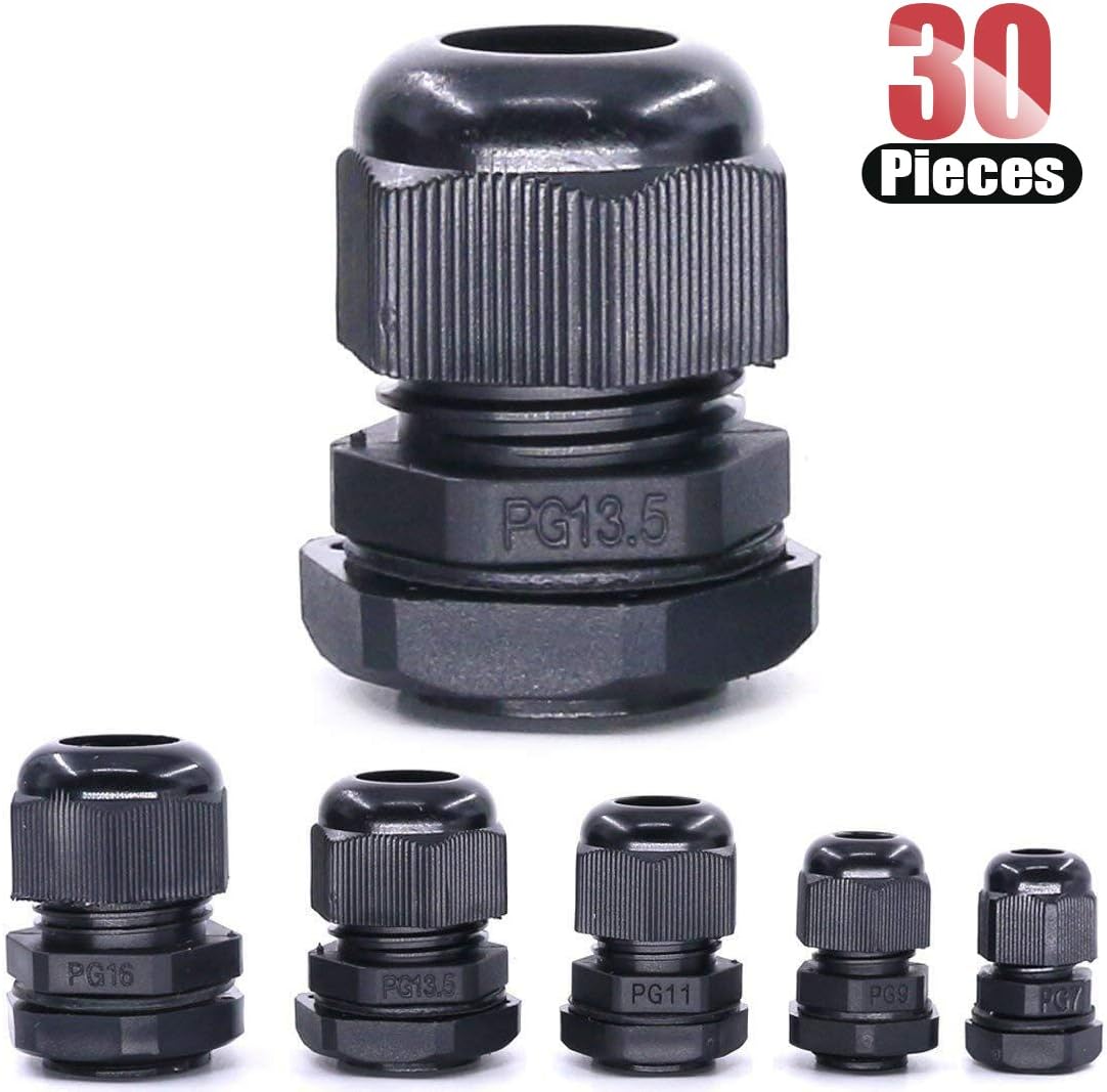

As noted earlier, I'll route the coax through the rather large gap atop the rear hatch. I'll then direct it downward, and I think I'll get into the interior behind driver side rear tail light.
Not sure yet if I'll make use of the existing hole and grommet, but I'm leaning toward making a new one just for the .4" coax. If so, I'll use one of these...
Hilitchi 30 Piece Nylon Plastic Waterproof Adjustable 3.5-13mm Cable Glands Joints Cable Gland - PG7, PG9, PG11, PG13.5, PG16 - - Amazon.com
