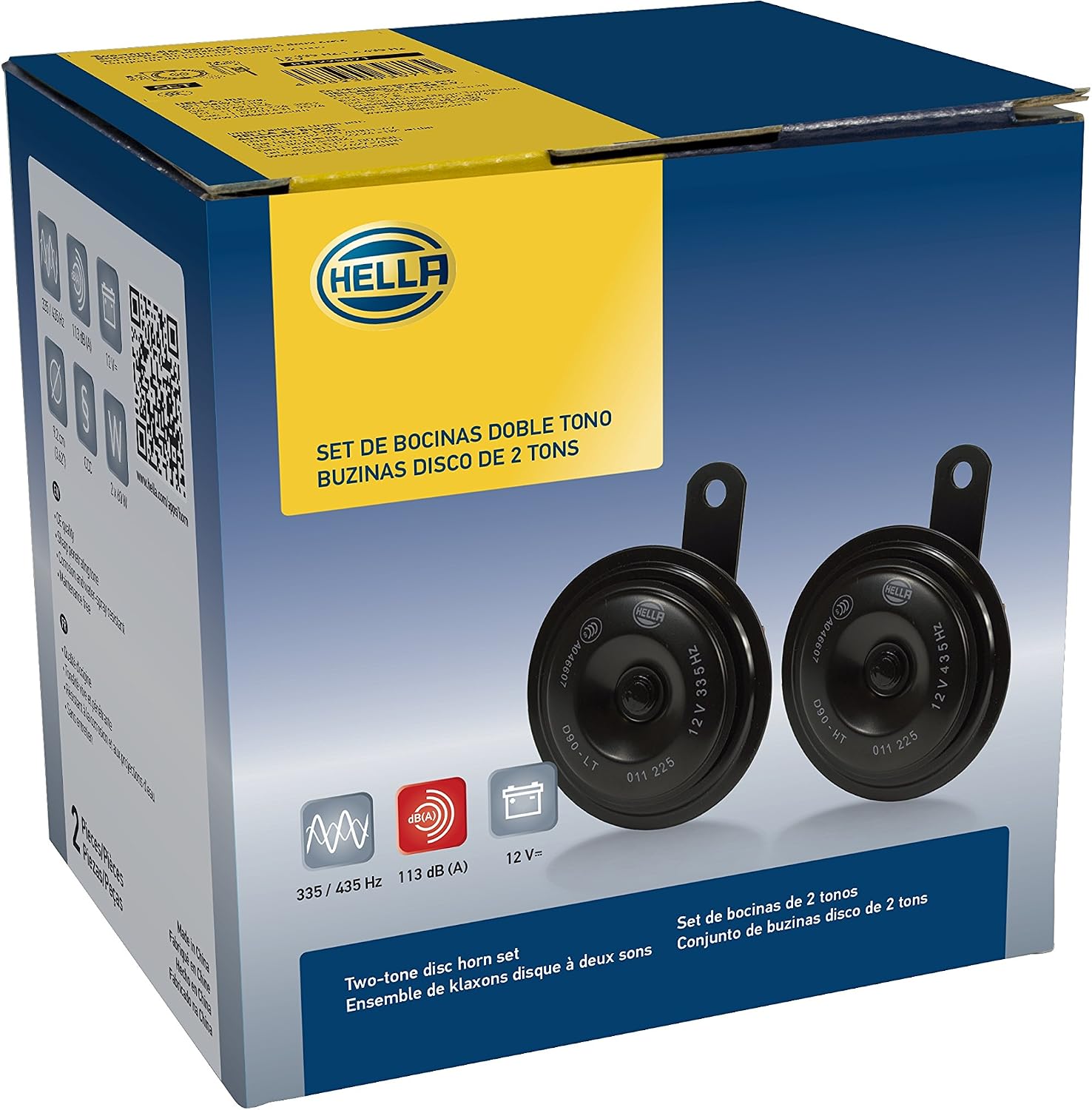

So, I was wondering about those Hella disc horns. And, they just arrived while typing...
They are somewhat larger, thicker too. On the box...
120 watts total, 12 volts, 10 amps... Right on the cusp of what you stated above. Thinking of going with a relay, but I might experiment first to see if there is a difference, a notable one.
The Hella diagram there shows a 16A fuse, and our horns already have a relay (their diagrams shows the OEM setup as going directly through he horn button with no relay). I wouldn't want to run 10A through a horn button... But 10A through a 15A fuse for such an intermittent application is good.
I'd say you are just fine going with the OE wiring in this case. Less wiring and complications for a non-critical system to get in the way of more important things. Simplify and add lightness, as Colin Chapman would say...

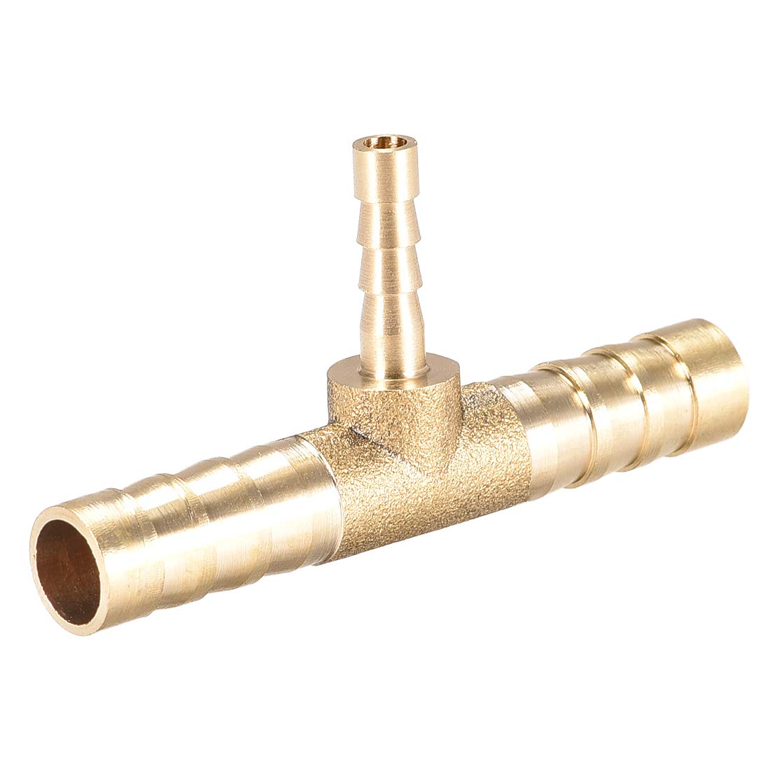

Hey, I found the elocker breather line. I suppose I thought it was electrical earlier. The one with the coiled supportive wrap around it...
It actually goes-up fairly high, where it clips here.
Removed, it looks like this.
It appears to be a hard plastic line all the way down to the unit, but not sure.
The rubber hose on the outside looks comparable to what's used for wiper fluid.
It does look to be about 1/8" ID. I'll look for the aforementioned tee or better yet Y-shaped barb (5/16" x 1/8" x 5/16").

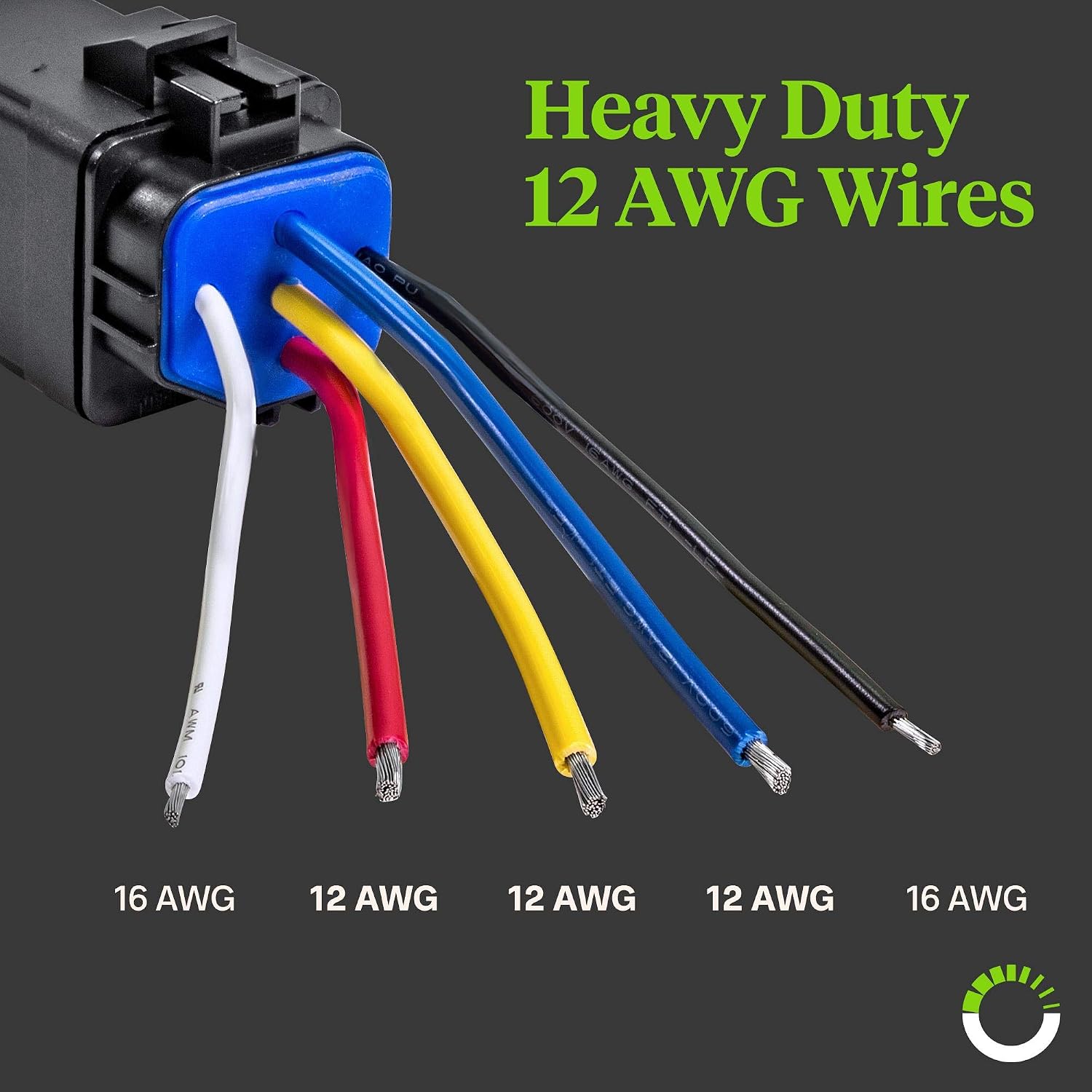

12 gauge from the battery. Will insert a 15A fuse later. Yellow and red wires soldered with two heat shrink tubes.
That was connected to the relay (30/red). The blue wire on the relay (87), also 12 gauge, will go to the horns, splitting into two wires, each 14 gauge.
The white wire (86) is the positive trigger and black (85) is ground, both 16 gauge...
I'm going to fab a bracket and put both horns on the driver side, not blocking airflow through the condenser and radiator.
I bent the metal tab on the relay and I found a good spot for it here (between driver headlight and battery).
Charlie, or anyone else, on the relay, is 87a basically a 12 volt pass-through (constant power), or maybe only so when 87 is not energized, in this case my horns? If so, I see a use for it...
The 87a pin is connected to the 30 pin when the relay is not energized - it is the "normally closed" connection. When power is applied to the relay coil, it disconnects from 30 and will be unpowered / disconnected.
What do you want to turn off when the horn is active? :behindsofa:
-Charlie
