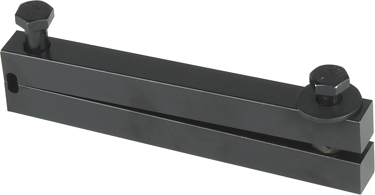

Appreciate the guidance on clamping these, each end respectively. On the big ones, did you crank on them so much as to use the 1/2" drive extensions? The Lisle tool has such a provision...
EDIT/ADD: For the larger bands, I'm looking at this product:
Amazon.com: OTC 4722 Stinger Heavy-Duty CV Boot Clamp Installer: Automotive

Those clamp pliers are almost identical to what I have. Just use them. If the clamp tool makes you feel better about installing them it certainly won't hurt anything. I didn't use any assistance. Just the pliers and some muscle. The bands are tight enough that rubber is protruding through the small slots in the clamp. Like I said, I've wheeled the shit out of them and their holding just fine.
Thanks much Matt. I think you are saying the clamps look almost identical to what you have. If so, great to hear. I thought so too, and for whatever reason ordered those, likely due to some discount at the time. You provided a good visual that should help me know when I'm tight enough, on both ends. I'll likely add a few clamps and the tool to my carry items, once I begin hitting the trails...
