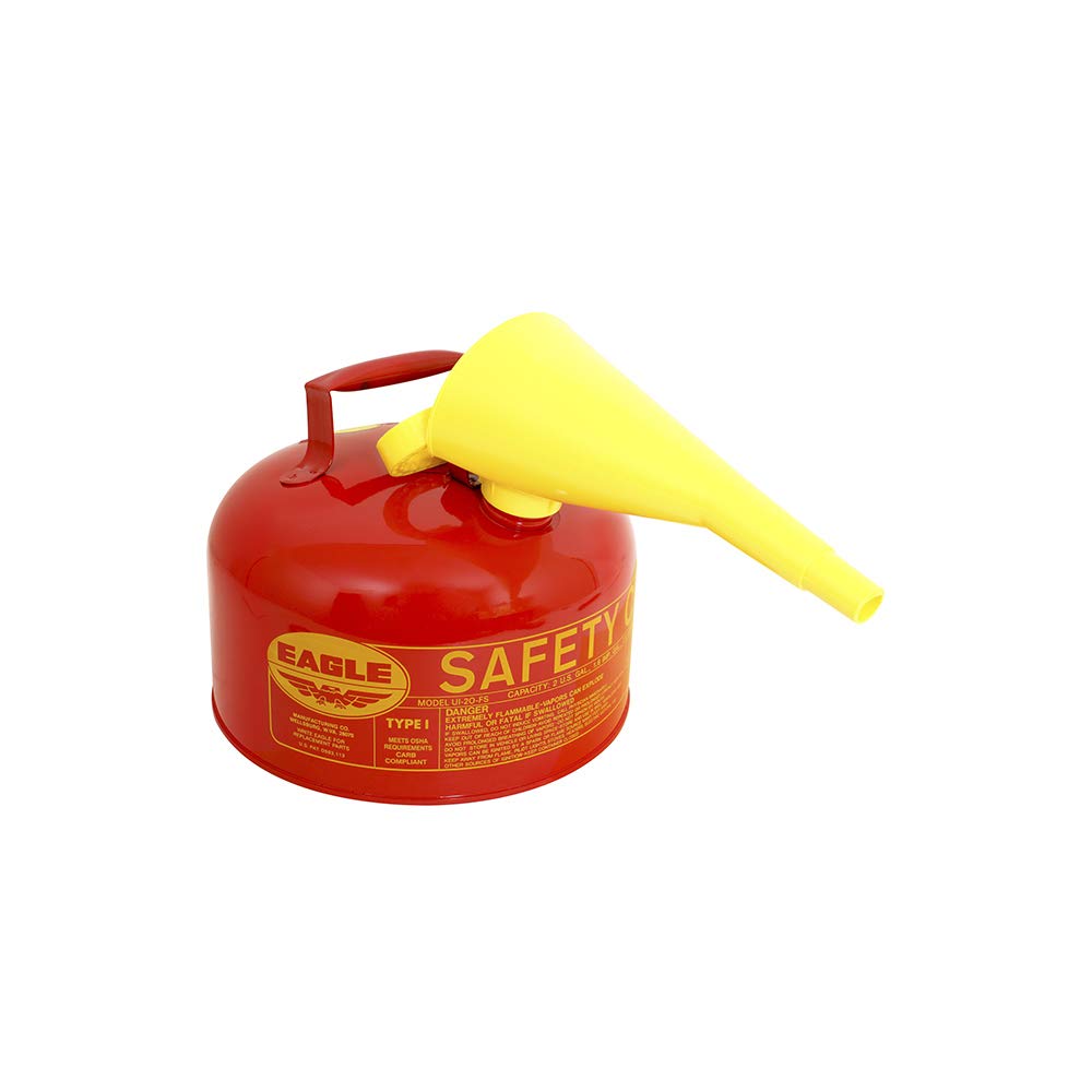

I actually think I can fit more gasoline down there. Anyone here have an Eagle pancake style gas can, namely the 1 or 2 gallon versions?

Decided to get a new one gallon gas "can".
With the aux storage tank holding a little over four gallons, I can carry an additional 5+ in total in the storage area. It's about 8" tall and has a footprint of 8"x6". It fits, and I could actually fit one more, if desired...
Simply tilt it a little...
and slide it under, then rotate it upright.

Hey Tony. As always nice work getting the rig in order. Do me a favor and make sure that gas cap is tight. Last thing you want is to smell that crap in the cab when going up in elevation.

Your word of caution on gas fumes is appreciated. I need to vent that new 1 gallon can or cap. The aux tank has a vented cap. While that storage location is protected quite well with reinforced 3/16" steel on the bottom, the sides and rear by the frame rails and Savage rear bumper, it has a few inches of vertical space up high, below the floor, for ventilation. I realize there might be times or dynamics where fumes could otherwise meander upward into the cab though. That lid forms a nice seal, and with gear on the topside, on top of that cover, I feel confident the fumes will find a better path of least resistance mostly because they are actually heavier than air. On our trip to Tahoe last year, with the aux tank filled, we never smelled any fumes at any point. All should be fine in that respect.
