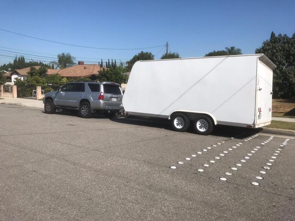

Shouldn't be an issue for these car. I have the same car with a spacer lift and stock xreas and trans cooler. I will tow a 16' enclosed trailer full of quads and gear. From my calculation i'm right around 6000lbs plus 4 people in the car. I will tow this rig 2-3 times a year, about 250 miles each time with some steep grades (grapevine). Trailer has electric brakes on each axle paired with a weight distribution hitch. These two thing is key! There is very little sagging but no issue and complaint with power, stopping and suspension here.

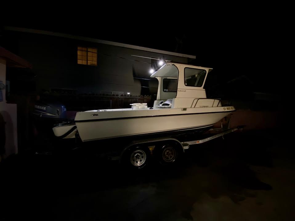

I also tow a boat 20' boat that weights around 4500lbs plus 4-5 people once a week. The tow is about 45 miles round trip and is flat. Boat is not rigged with brakes or weight distribution hitch. Without the WDH, it will sag a bit and is a bit bouncy so airbags will be added soon to improve ride quality. With that said, its much easier to tow the enclosed trailer.
