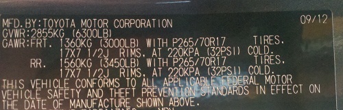

I found the rim size on the sticker on the driver's side. Looks like 7 1/2 for my 2013 Trail built 9/2012.

LE wheels are 20x7's with 4.5" BS
SR5 wheels are 17x7's with 4.5" BS
TE wheels are 17x7.5's with ? BS ...(I never actually measure BS on a TE wheel but others have reported it to be 4.5" but I haven't confirmed in person).
I had the LE wheels and cast in the back side was 20x7J. I never took a tire off a LE wheel as I traded them for SR5 wheels the first week I bought them.I still have the factory spare out in my shed out back. I did measure a SR5 wheel and it measured a 7" (measured inside flange to inside flange)and it had a 17x7J cast into the back side.
I'd bet my house on it that if I took my tire off the LE wheel that it would measure 7"s too if measured corectly! The mis info from tire shops or what not probably had to do with all 4Runner wheels being 7 1/2's for years before the 5ths .
