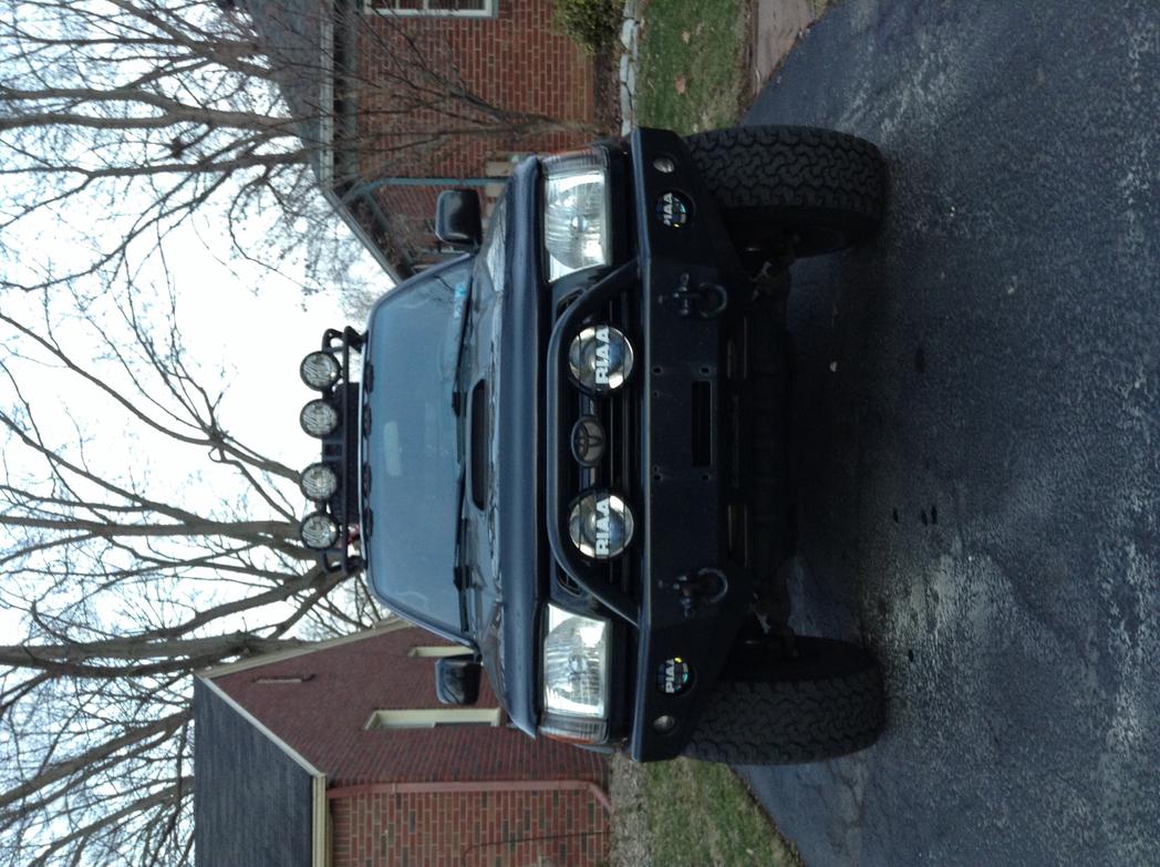

So I have a 99 4runner, lifted (toytec ultimate) 265/75/16 tires, and shockworks bumper with 2 7" PIAA lights on the bumper (yes kind of blocking the grill) I also have on top a whitson rack with a spare tire mounted up there, and 4 kc lights on the front of it. NOt armored outside of rocksliders, roofrack, and bumper.

Does anyone else have this problem?? Thinking it might be an airflow issue, but unless i want to remove that light i guess my options are to go back to routing it through the radiator, or possibly adding a second trans cooler (Not sure if there is enough pressure or how good of an idea that is??)

There's no way the stock in-radiator cooler will work better than a larger aftermarket one. It sounds like it doesn't have proper air flow through it. Get rid of some of the junk blocking it and see if it doesn't work better.

yeah i was getting after it driving so I hope that is part of the problem....I do think it is an airflow issue I just didn't know if anyone else saw the same issue or if taking off the lights on a bumper would alleivate that?

Make sure that your 70268 is mounted right up against the condenser, right in front of the pathway of the fan. If not, temps can climb fast.

So you have an idea of the airflow this is what i was talking about

I really think your lights are blocking the necessary windflow.

so you have two options, either remove the lights, or get a bigger cooler, i used the 70264 cooler and found that even that one was not enough so i ended up buying a second cooler with an electric fan on it. idk why people buy that pathetic 268 cooler, its anemic, and for a friggin car. B&M rates those at optimal conditions, meaning there is a big fan directly behind the cooler, and nothing in front of it with perfect airflow and probably around 70* ambient temps. -the bigger cooler(of you could even run both of them i guess) is much cheaper than taking the hit on the lights, i think that 264 was like $60, those PIAAs are like $3-400, you do the math.
you could always remove the lights and just do the same again and see what the temps are and then go from there, but im sure you are gonna want a bigger cooler. and you really cant go too cool -you can but as long as you are over the 130* mark you are fine basically if the trans will shift into overdrive you are warm enough and it will do that at just under 120*
