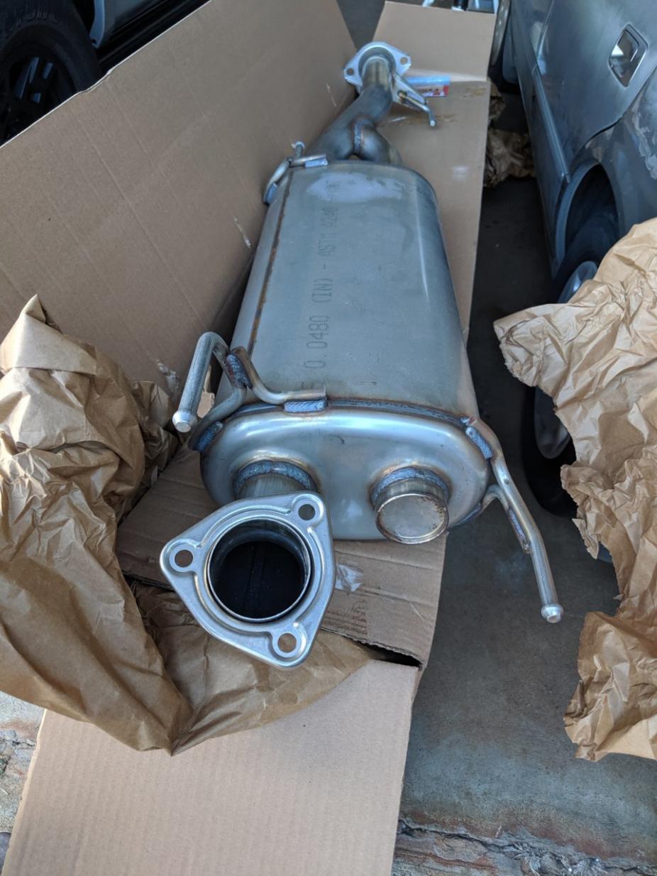

The muffler is the primary differentiation between the regular exhaust and TRD. Why not just go custom and save a bunch of money? The TRD is overpriced for what it is. I have it and it's fine, but not exceptional. I'm thinking about adding a Helmholtz resonator to mine. Typically drone isn't caused by the muffler itself, but the sound wave function leading to the muffler - which is why it's heard closer to your seat than the rear of the vehicle. The Helmholtz resonator when placed just passed the Y-pipe is a 1/4 or 1/2 wavelength oscillator, effectively offsetting and canceling the primary sound wave.
The TRD muffler already has a Helmholtz resonator integrated into it. It's a dual-pipe muffler that they're repurposed into a single pipe with a capped off chamber.

Who had the idea for adding another muffler to the muffler? Lol, I can tell why that guy doesn't like reading.

Good insight. I noticed the secondary pipe and didn’t think about it functioning as a Helmholtz. Makes me wonder how the internals look because they seemed to miss the 1/2 wavelength. I guess it’s more like a 350z design than a J-pipe I was thinking about.
