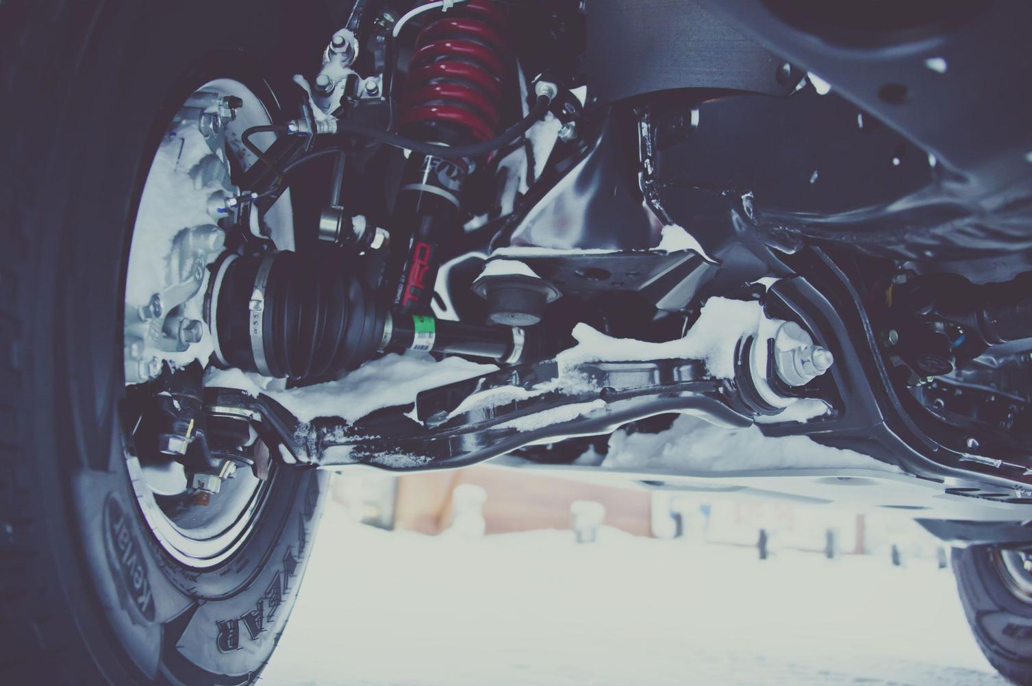

2017 TRD Suspension
It's interesting that the TRD engineering team has switched to Fox over the Billys in the 2017 Tacoma. Straight from the site:
Tacoma TRD Pro really earns its off-road cred through its TRD-installed suspension and exhaust enhancements that include:
FOX 2.5 Internal Bypass shocks tuned by TRD
TRD-tuned front springs with a 1-inch lift
TRD-tuned rear suspension with progressive-rate off-road leaf spring

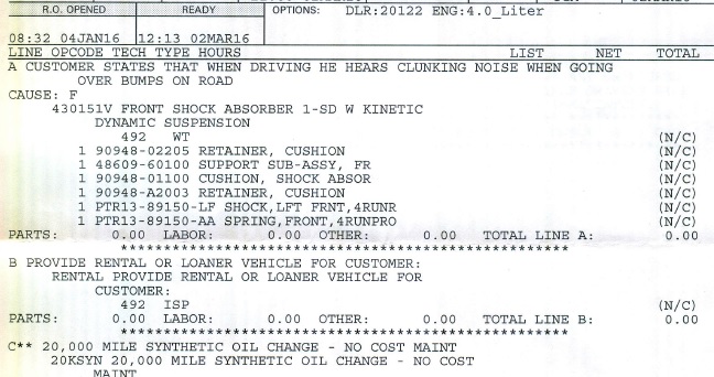

Well still no solution. Yesterday my truck went in for the 6th time for the clunk. After the 4th time, they decided to replace the left front suspension components listed below (on the 5th appointment they discovered they ordered the wrong parts once they had truck apart. :ybrick:). Service called and said truck is all set and noise appears to be gone. I pick it up (very skeptically) and sure enough - clunk still there. Turned around and went back. Took tech out AGAIN to show him the noise and he confirms clunk is still there. Service manager says now the next time they take it in (I would not leave it there without a rental from them) they will need to keep it until they exhaust all other possibilities because now they have to answer to Toyota Corporate why they just spent all that $ to replace parts and the problem still persists. We'll see..... waiting for them to deliver a rental today or tomorrow as I told them I could not take any more time off of work for this problem. And the saga continues....
It is things like this that reinforce my lack of faith in dealership service departments. Most people on this forum could look at that ticket and tell them they were ordering the wrong parts. No KDSS on the Pro.
Good luck getting them to actually diagnose and fix the problem. So far Toyota Corporate has not seemed interested.
