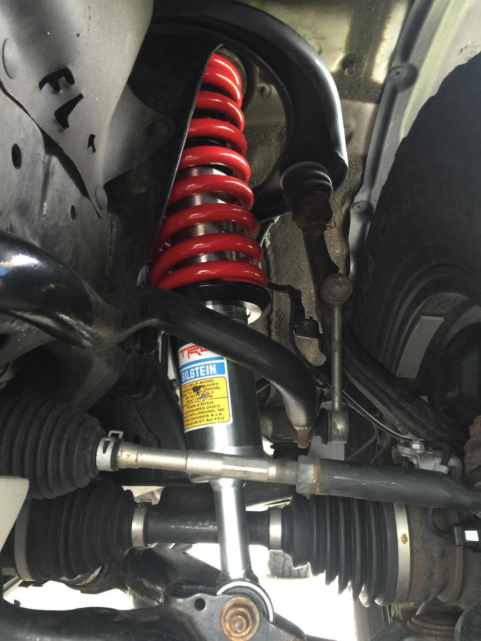

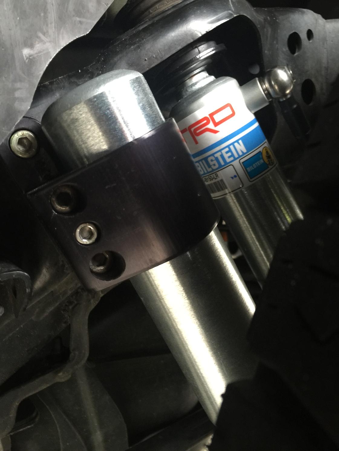

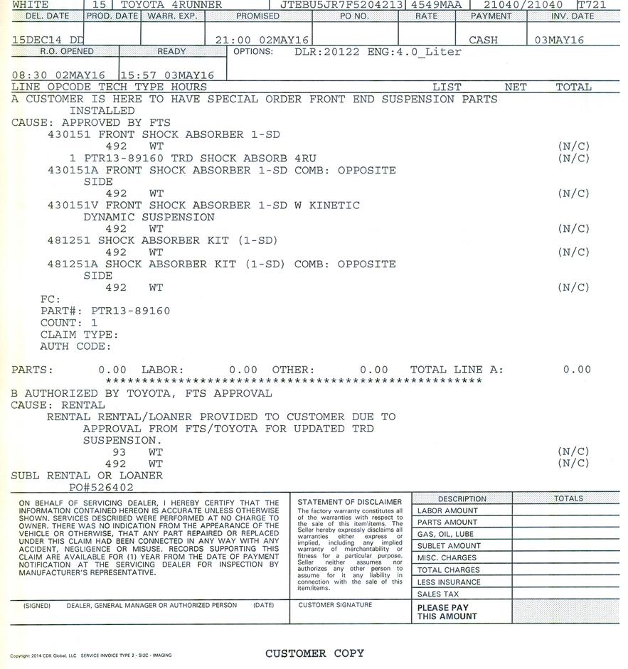

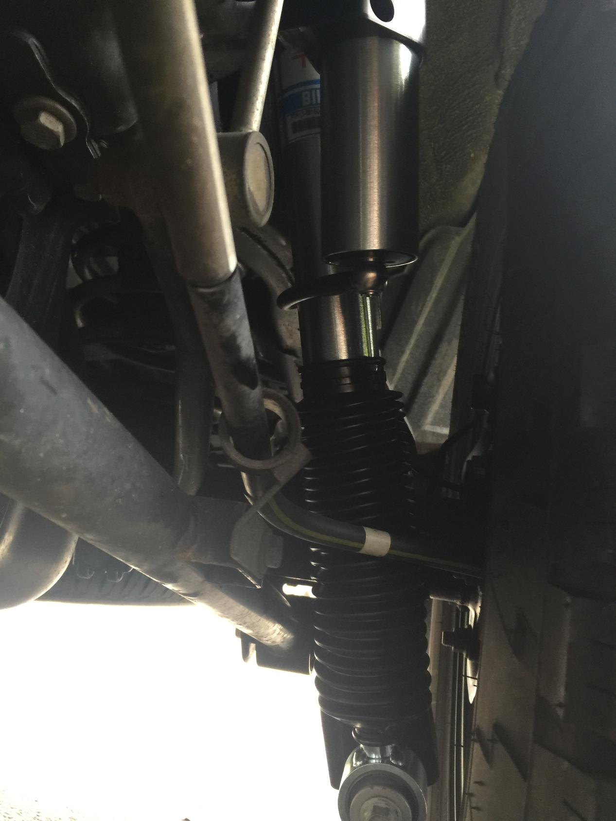

I can with reasonable confidence say that my "clunk" is FINALLY gone. It took 9 service appointments. Along the way they tightened & torqued stuff over and over, partially replaced driver's side suspension, had Factory Tech come out, etc.
On my 8th visit the Factory tech acknowledged the noise but stated the unit suspension was fully functional and no safety issues. He also stated Toyota/TRD is aware of the clunk issue (from multiple consumer/dealer service complaints) and was working on further evaluating it. I did not expect much after that. 3 weeks later the dealer called and said they received a shipment of parts with my name on it. Dropped the truck off Monday and it took 2 days for them to install everything. It appears they replaced the Front AND the Back Bilsteins. I am not sure what else was replaced.
So far, no clunk. I cannot fully be confident until we have some much colder weather (it was in the 40's this morning) but in today's "cool" temps it is still quiet. Before, I would get clunking all the time.
Hopefully this may help some of you other guys get it resolved too. If you need it, my Toyota Case # was 160680821.

I wonder if the pn are revised or same as original.
Back when I had just the Driver's side replaced, the Assembly Number was "430151V", and it appears to be the same/unchanged in my new invoice when the same part was replaced.
Maybe it is some of the supporting hardware that is different? Unfortunately, my new invoice does not break down the assembly into the individual components.
Correct. When they replaced it the 1st time I saw that and said "hey, I don't have KDSS". But it was the exact same Bilstein part that they had replaced. :confused:
Maybe you should check with Bilstein and see if that shock is different from one without KDSS. Originally the TRD Pro had KDSS and KDSS was dropped when the production model came out.
Long shot maybe �� Causing the clunk?
On your invoice they list 430151V front shock absorber 1SD W/ KDSS
That's not the part number. The part number is listed as PTR13-89160 on the invoice, which is indeed different than the original part # (PTR13-89150) for the TRD suspension kit.
That part number encompasses the entire kit (front coilover assemblies and rear shocks) so it's hard to say what exactly has changed without looking at the individual components. Checking the part numbers of each piece would be a good place to start.
Original Part Numbers
Here's a breakdown of the original part numbers for comparison:
Front:
PTR13-89150-LF
PTR13-89150-RF
PTR13-89150-AA (springs)
Rear:
PTR13-89150-LR
PTR13-89150-RR

UPDATE: Well it is beautiful in the 70's now (finally!) but we did have a few cold mornings and STILL NO CLUNK. Also did some light off-roading and no clunk whatsoever. Keeping fingers crossed but it looks like replacing everything fixed the clunk. I hope the rest of you have the same luck!
Would you mind looking for the new part numbers for the front suspension specifically and list them here? Thx.
My TRD Pro just arrived to the dealer today after a delay at the port. I did not have many details but was just told there was a delay on some TRD parts. I went to check it out this evening before I can pick it up tomorrow but did look at the suspension after reading all about the clunk issue here. It has this same ptr13-89160 part number. Really hoping this has addressed the problem!
