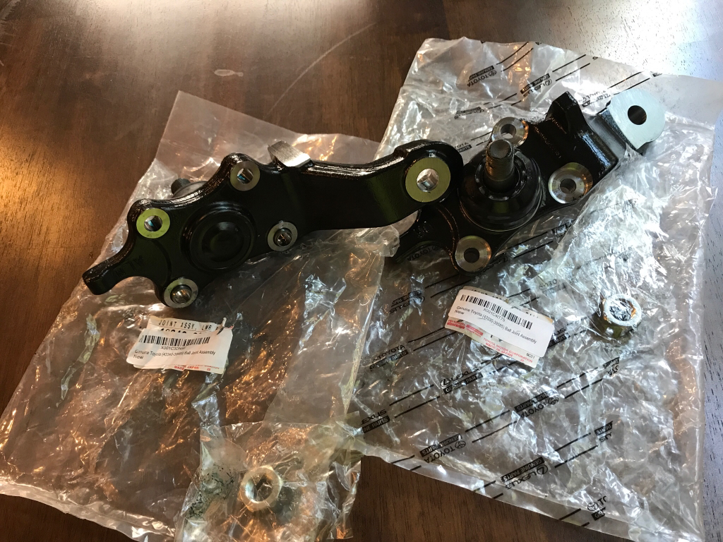

What's cooler than buying OEM LBJs?
Doing so twice in a year! [emoji23]
Oh well. I needed the peace of mind-

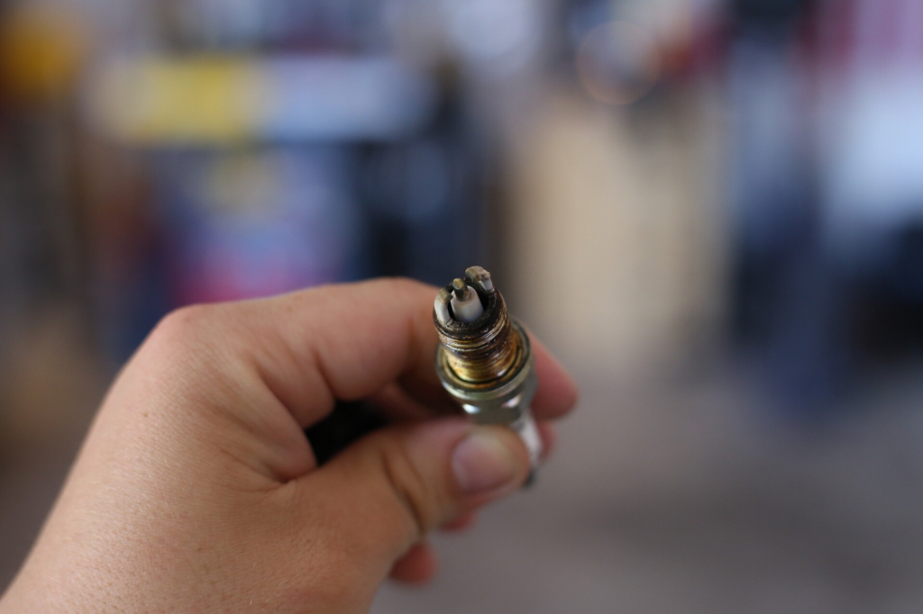

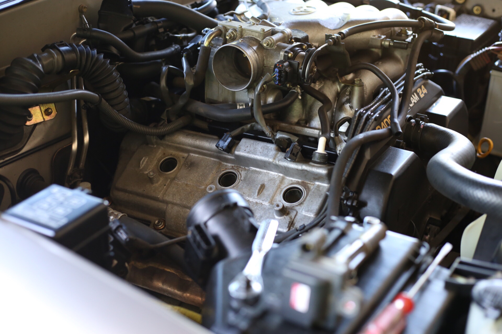

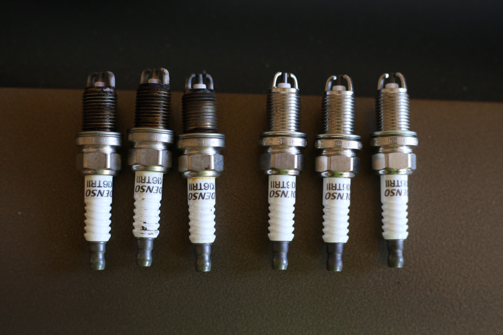

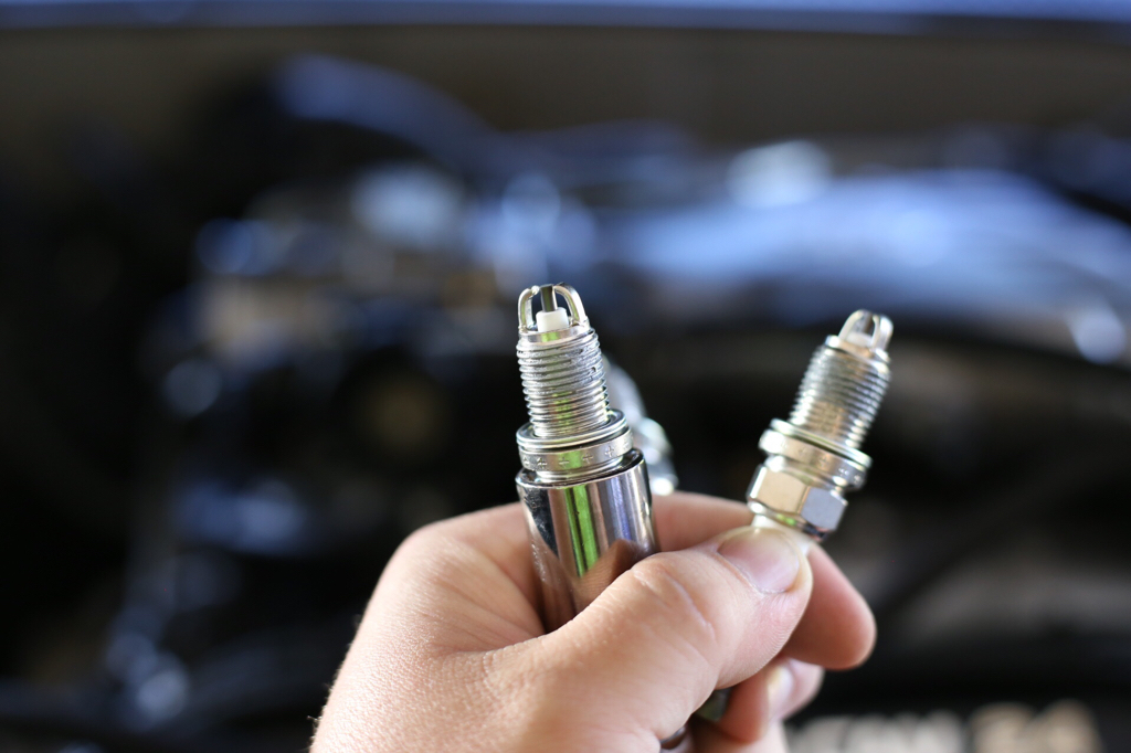

Anyway, I changed my plugs last night-
The plugs didn't look too bad- which I was bummed about. I always like to see horrible plugs, because then I'm exited in it running so much better [emoji23] First 3-
Next to the new replacements-

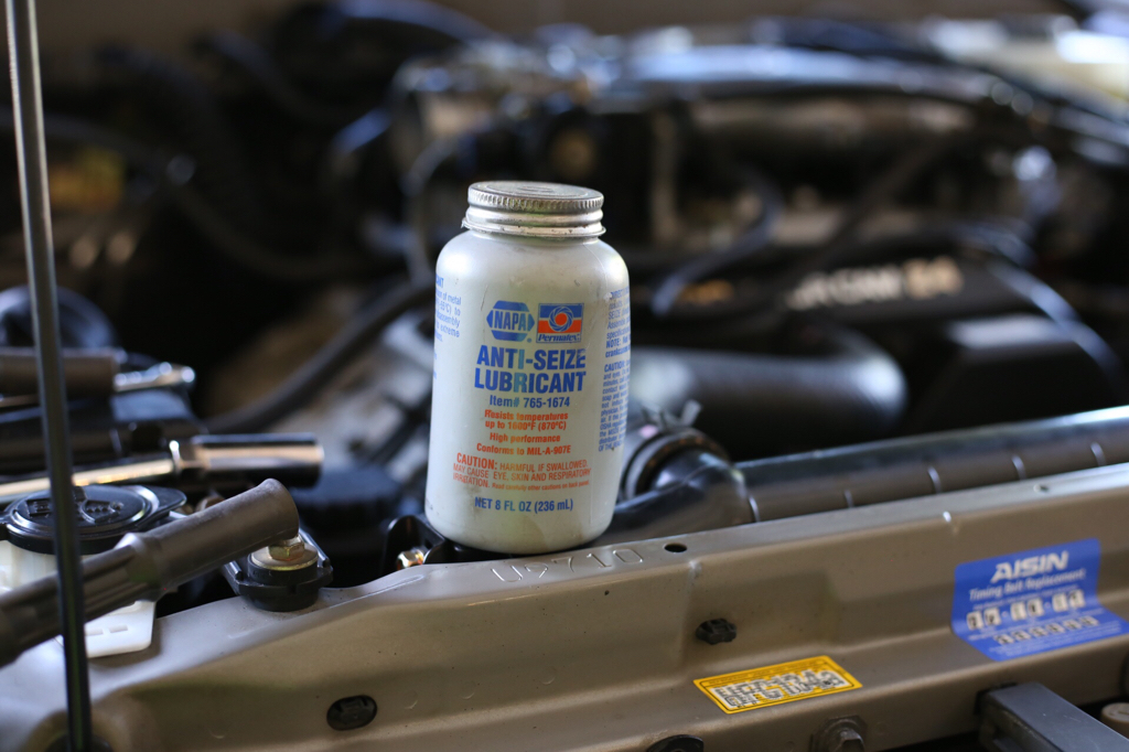

Don't forget the anti-seize!
No need to get all liberal on it-

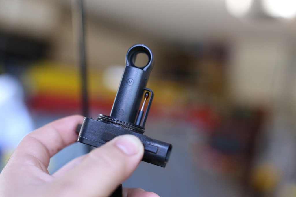

Cleaned the MAF while I was in there. The pic is of the bulb before. It didn't really look dirty to me, but I'm not really sure what I am looking for-
Tried to get a pic of the other element down in there, but I just couldn't.

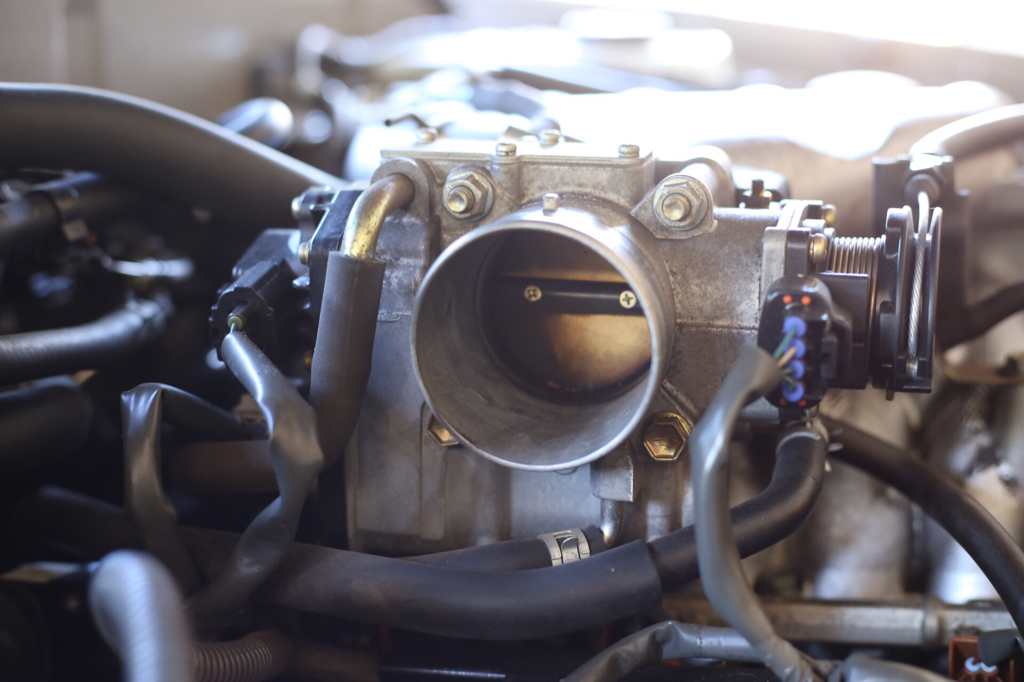

TB didn't look to bad, but I cleaned that while I was in there too-

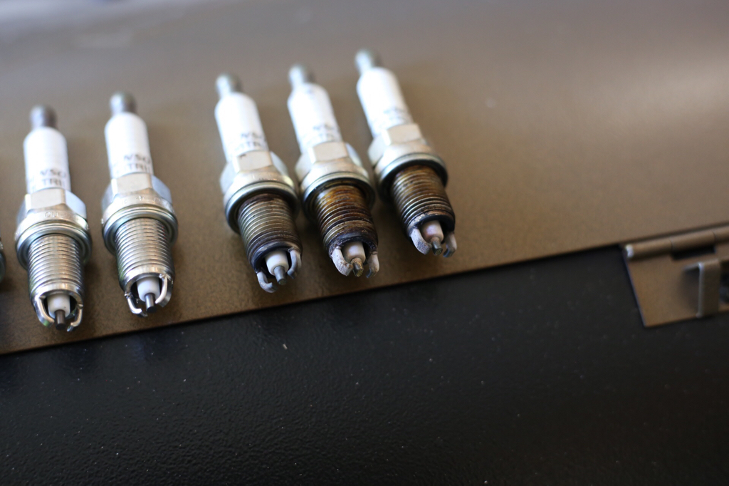

On to the other bank. It was this side that made me really realize what I was looking for- as far as wear on the plugs. The center electrode was pretty obviously eroded on all the plug! The first bank I did was the same, I just wasn't paying attention to it.

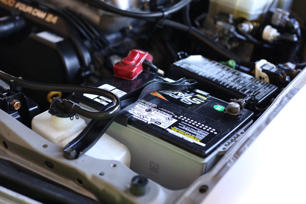

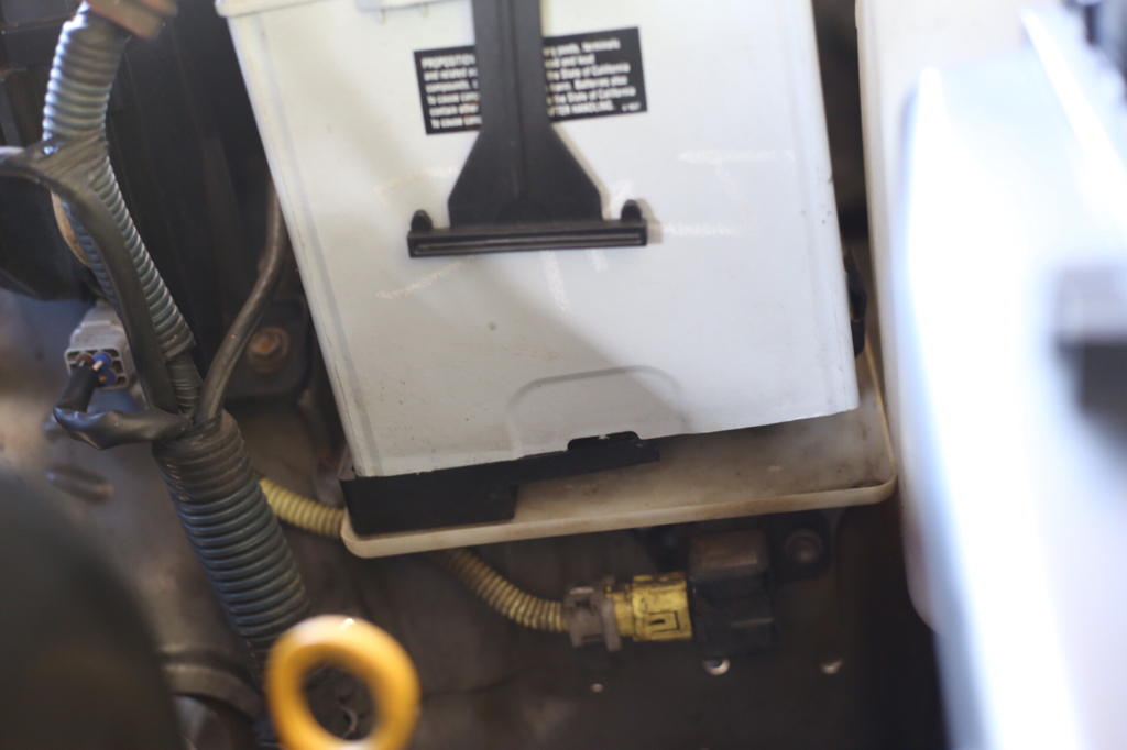

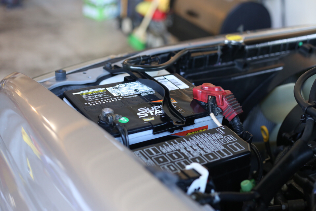

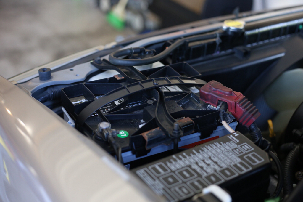

Seriously question here guys and gals- WHAT KIND OF NINCOMPOOP DOES THIS?!
I try to be understanding of different people's thought processes, but COME ON! They even had to go to the extra work of trimming the spacer to make it fit around the terminals. Which sucked, because that made it a slightly less-solid base. Oh well.
Strap sanded down and re-painted, and spacer installed on the correct end-

The spacer kills me. :pound:
And good call respraying that hold-down, I opted to buy a new one and and 8 months later it looked just as shitty as the one it replaced. :frusty:
Me too man. At first I just assumed that's how it went. Then I really looked at it, and I'm like "WTF?!"
Oh no way?! It rusted within a year?! Wow that's crazy.
