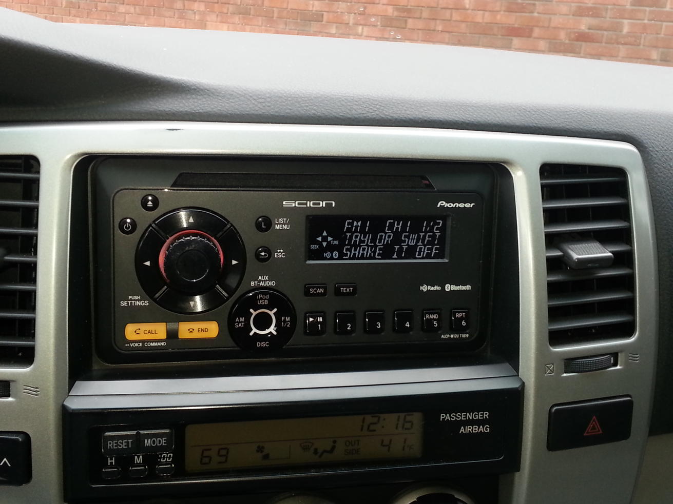

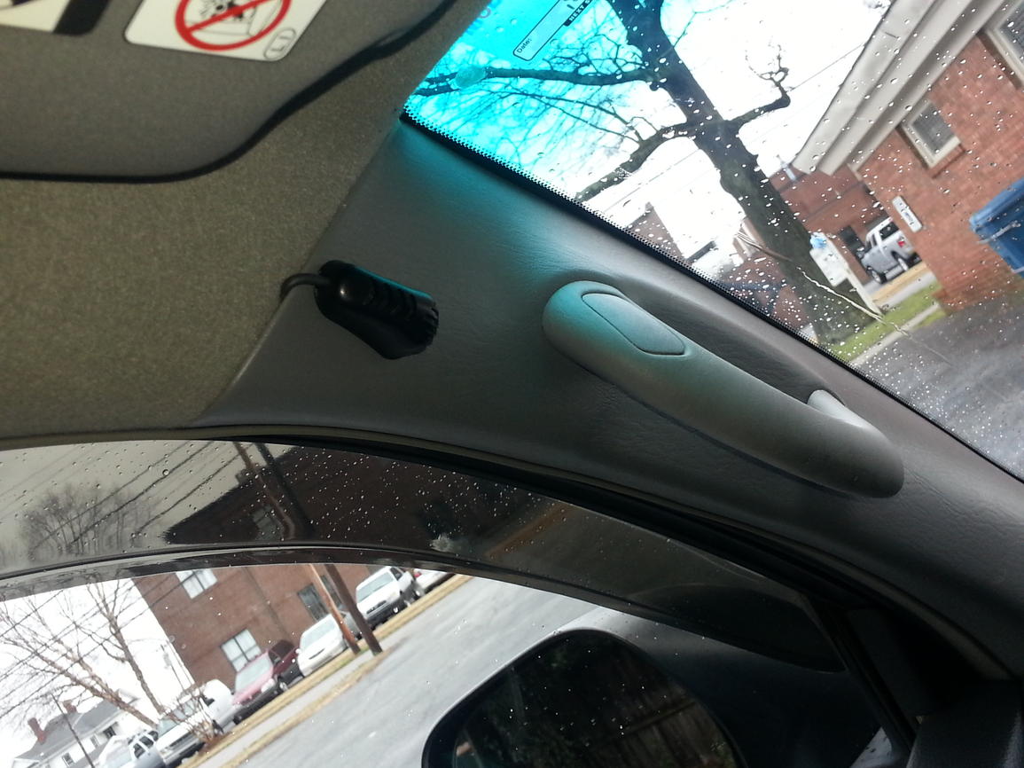

I installed the 1819 last week, really a good upgrade from the stock HU, I need to find info on how to install sat.radio receiver. Anybody done this? Cant seem to find much info.20150124_121625.jpg

Here are my notes! The upgrade was SUPER simple and worth it! The AUX doesn't work UNLESS you do the resister mod below (after the mod the AUX works perfectly!). I'll post all the pics to my profile page after I get them off the camera.
It looks good in the truck (updates the display), sounds better (not going to blow your socks off but it IS better) and the iPod functionality is really nice to have.
