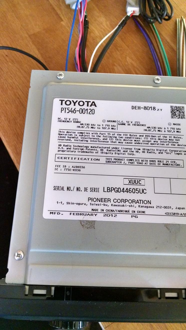

Got my T1819 finally!!!
Ok gents,
I got my radio from a board member who owns a 3rd gen, and also have the following harnesses:
PT546-74120-MC
Metra 71-1761
PT546-00120-CH
PT546-00120-AD (kind of, this one is made for a 3rd gen, so it looks little different)
So, before I tear the dash apart is there anything else I need to have for my JBL Synthesis radio system? I think I still need the Metra TYTO-01 before I start this project, correct? This part is rather expensive on Amazon.

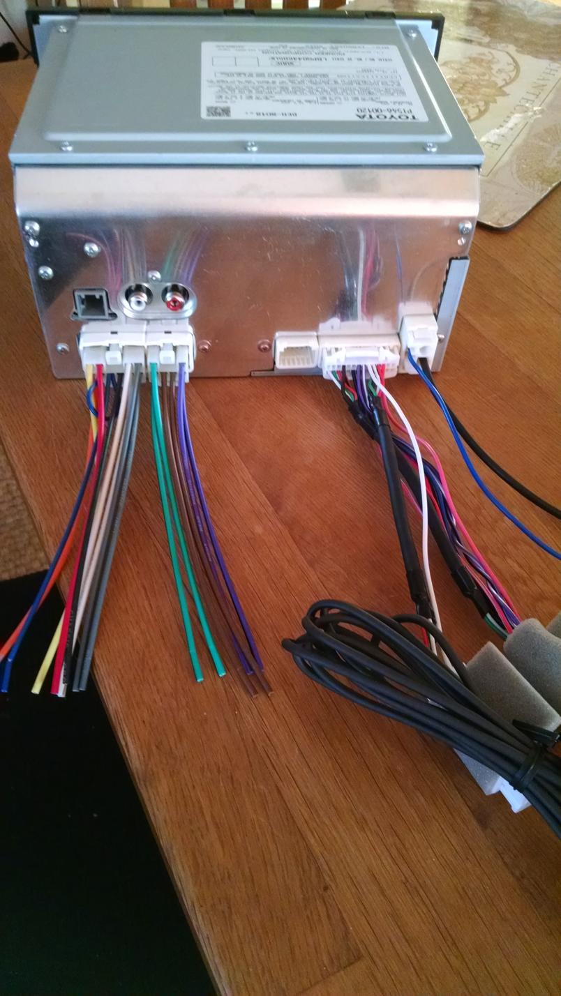

I started my radio install today and need some clarification. Before disconnecting my radio, I made sure to center the fader/balance and crank the volume to MAX.
In the picture below, I've circled two things and placed an arrow over the RCA outputs.
Large circle:
I see that I have to connect the following wires to the vehicle: illumination, POS CONST, POS IGN, NEG. The remaining wires are all for speakers. I'm assuming I don't connect the speaker wires since they're all going to the JBL amp in the cargo area, correct?
Small Circle:
Are these RCA jacks for the backup camera?
Arrow:
Does anything go into this connector?

Here's a picture of the radio belonging to another member on the previous page. It seems that his speaker wires are going straight to his METRA unit, which makes sense to me, hence the confusion with my unit.

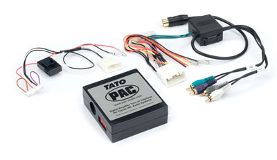

Ok, now it's time for the PAC TATO questions. I have 4 RCA wires, not sure where they need to go!
There is a second harness (left, in the pic below) which is 11 pin and it appears to be an optional harness for some other PAC SWI device that I don't need to worry about, correct?
PAC TATO needs POS ACC, POS CONST, NEG, ILLUM wires to be connected. Seems pretty straight forward.

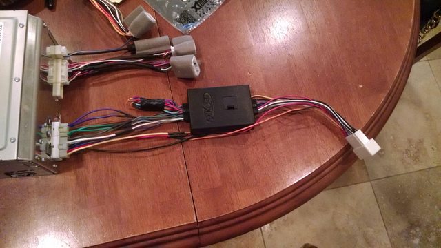

Basically, the wires weren't going straight into the Metra unit, I made that harness by soldering together the Metra harness and the OEM harness that plugs into the unit. "Big Circle" in your pictures, I think. If I remember right, the green, purple, brown grey, etc. are the wires you'll need to solder to the RCA connector wires. I expect you'll need to clip off the RCA connectors.
The "Arrow" is for the OEM USB port, I think.
Hope that helps.
Hope that helps.
I don't think I need to play with any of the speaker wires in the big circle, correct? The JBL amp is already taking care of driving the speakers.
No, you'll need them. Here's how it works:
Scion HU -> 4 analog channels -> PAC TATO -> 2 analog channels, 2 digital information channels -> JBL Amp/controller
The 2 digital information channels are things like fade, balance, etc. that tell the amp how to split up the 2 analog channels to the ten speakers or whatever.
