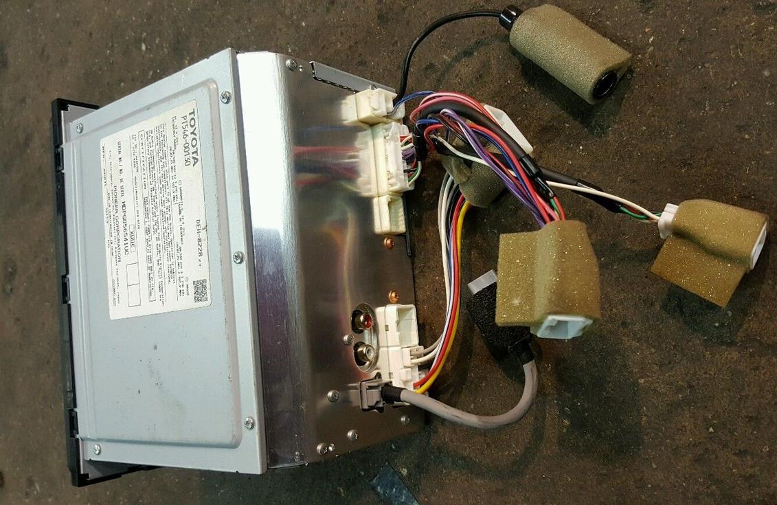

As mentioned, deals are out there. I was able to find a T1819 on craigslist with the harnesses for $65. Not sure why the ones on ebay are so expensive and dont even come with the cables. I will also be taking pictures of the Bluetooth mod so we can get some good instructions on here.
Got my T1819 installed today. It was extremely easy after reading this thread and finding a radio that already had the harnesses. Thanks to everyone who has contributed to this thread and njsanna in particular for helping me out with the Bluetooth mod.
As promised, here are the details of the Bluetooth mod:
Here is the T1819 with the harnesses already on it as I bought it.
The connector you need to modify to enable Bluetooth is the one on the far right. I cut open the white wire that is outside of the grouping, and also the black shrink wrap on the group of wires. I did this very carefully as to not damage any wires. The black group of wires is actually shielded by the ground wire that you will connect to.
Next I took a spare wire I had and wrapped it around the white wire and the wire shield. Using an extra wire is probably not necessary, just making the white wire contact the shielding would also work.
Final step is just to tape it up with electrical tape. Bluetooth worked great first time I powered up the radio and paired my iphone without any problems.
