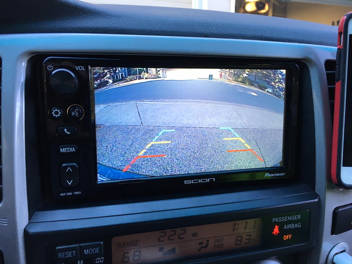

This thread and the others like if have been a great help to me upgrading the HU in my 2006 4Runner SR5. Thought I should post what worked for me for the benefit of anyone thinking about upgrading, I didn’t see any details on the T10071 radio in the thread yet. I just upgraded for the 3rd time (!) to a 7” Scion iM T10071 (pt546-00160) radio I got off-of eBay. The long winded path to this point:
Upgrade #1
T10004/T1819 +the cables mentioned in this thread including the microphone and USB cable. I added a USB plug from Mouser Electronics just below the hazard flasher button (can just see it in pic below)
Gained better sound, Bluetooth handsfree/audio streaming, USB, iPod control can play AAC/MP4a natively from USB. Very nice upgrade but decided I wanted to add a backup cam.
Upgrade #2
T10015 (pt546-00140) 6.1” Touchscreen.
Needed +6v camera and 16pin harness adapter for camera (Bought both from eBay from a guy in Portland with instructions, very nice kit - easy) Everything else plug and play, didn't get the nav/entune modules as nav on the phone is way better IMHO.
Gained touchscreen and backup cam but lost ability to play AAC/MP4a natively. Hardest part of camera install was running cable through the rubber boot between body and tailgate, I wrapped camera connector in electrical tape and smeared this with dielectric grease and it slide through easily. Camera trigger needs adding on 28 pin connector when shifting into reverse, I added an ‘anytime’ camera button also to be able to manually turn on camera view. Used a double pole double throw relay for this and a custom button from eBay, found details on how to do this at the link below. If anything it got rid of a switch blank in the centre console and it is cool to show to passengers.
Toyota 4Runner Anytime Backup Camera Mod
Upgrade #3 (Hopefully the last ;-) )
T10071 (pt546-00160) 7” Touchscreen from a 2016 iM.
Needed to replace 16pin connector with 24 pin Pac-Audio CAM-TY12 harness adapter for camera, buy it from eBay/Amazon. Everything else plug and play with the pt546-00140. Only needed to connect +6v and RCA plug from harness, the camera grounds through RCA so didn’t use the black wire.
Gained nicer screen/interface/gracenote/Aha(questionable) and re-gained the ability to play AAC/MP4 via USB. Lost ability to play CDs but not an issue for me.
Latest pic is attached, good luck with your upgrades

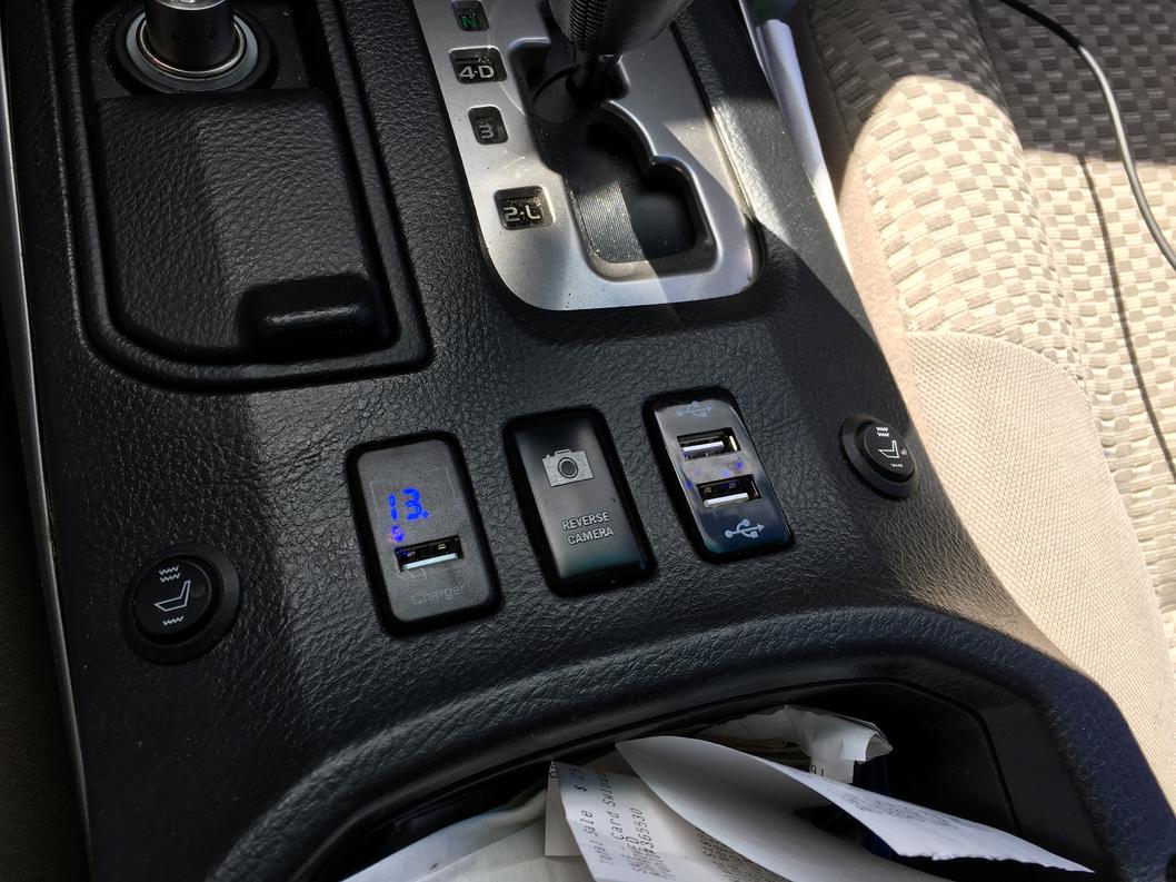

Just in case anyone was wondering, here is my centre console with the camera button, I pulled the dash lighting power from the ashtray wiring. The camera script comes on with the dash lights, the camera Picture lights up when the camera is on. Pretty cool
Simon
