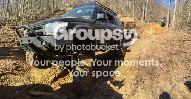

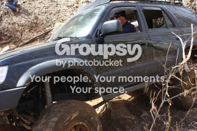

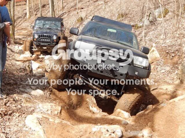

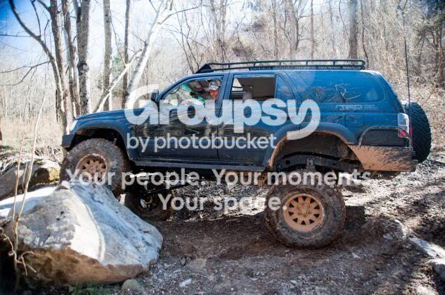

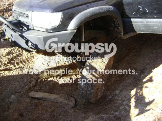

I was excited to see the pics myself. I could feel the front end working but tough to tell what it looks like from the drivers seat. Obviously a completely different truck. I went from 2" of droop on previous setup to 14's. I'm running about 3" of compression and the rest droop.
:dance:
Shameless poser shot. I was doing this on everything in the park. Everybody was like, "seriously, again?"
I had that expression on my face all weekend.

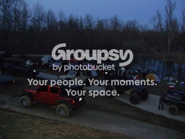

Cool campsite:

Was great to see your rig out on the trail finally. Granted I didn't wheel with your group the whole time, but from what I saw it did great! Was your steering radius what you expected? Seems like you were a little limited turning driver side, but may have just been the spots we were in. (tight!)

Thanks Jason. I am still fine tuning the steering stops etc. Mostly though, it was probably me being over protective. The hydro-assist steering RAM has a little more stroke length than necessary. That could really over stress steering links trying to push past it. Somewhere I've seen a write-up on a little internal bumpstop to add to the steering RAM to avoid this. I will get around to that. Also, probably some left-over fears from IFS wheeling. Droop+wheel turn+gas pedal = Pop! The oversized knuckles and housing also may cut into the radius a bit. It will still turn pretty sharp though, and I could turn the wheel with 1 hand even when locked up front.

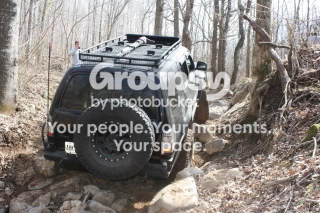

And the last couple trail pics:
Very awesome!

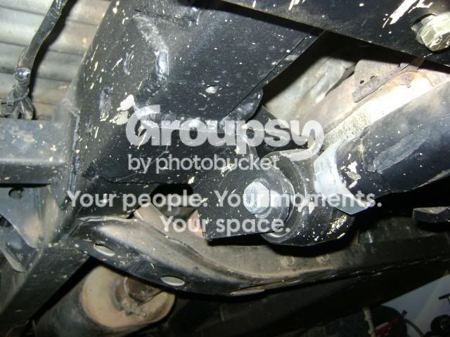

Also can you snag a pic of your link mounts on the frame side for the lowers? I need to inboard mine, the turning radius is BAD!

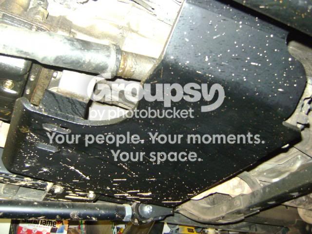

I got a pre-fab'd crossmember. Cut out the old. Burned in the new mounts and bolted it up. This one:
https://frontier4x4.3dcartstores.com/Trail-GearRockDefenseToyotaTacomaSingleT-CaseCrossmember
DSC00908_zps842fec48.jpg~original
Also serves as a skid. Just wish it extended a bit further forward to cover the trans pan.

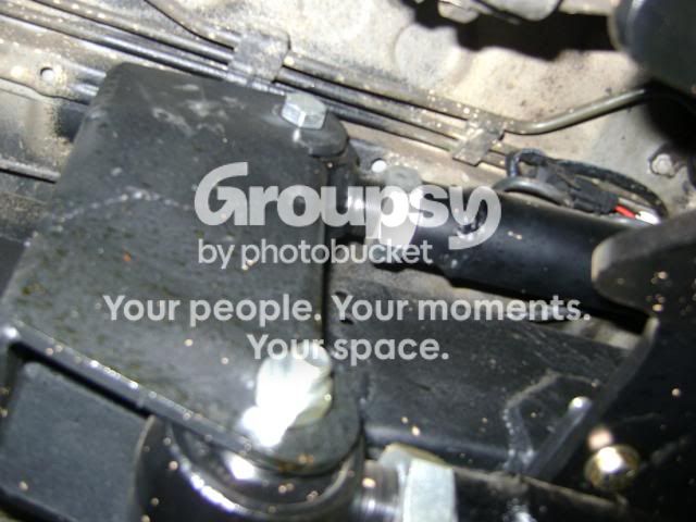

Here are my frame side link mounts. Also pre-fab:
Passenger side
DSC00910_zpsa1c93f54-1.jpg~original
Drivers side. Dual mount for both upper and lower link.
DSC00912_zps58a1533e.jpg~original
Kudos to you and others who have created these things on your own. I used pre-fab and it still took 3 months!
