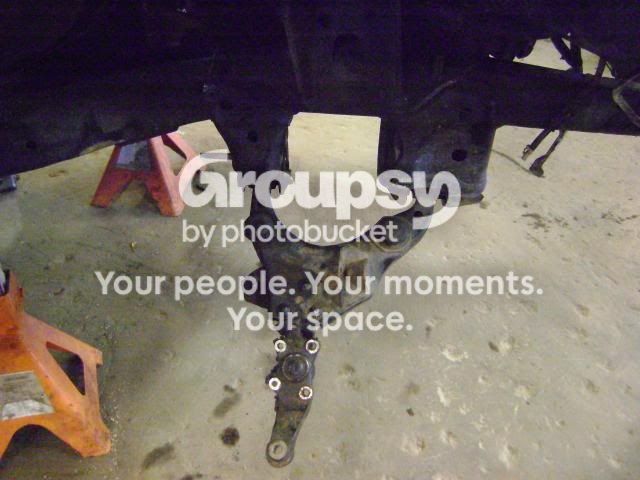

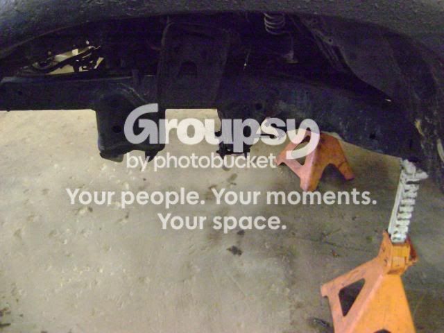

The old IFS put up a fight. 15yrs and 300K miles had seized the LCA bolts. Torched them off after giving up on the systematic disassembly.
Note: The strut towers are partially attached to motor mounts. Careful cutting and some patch welding was necessary to sure it up.

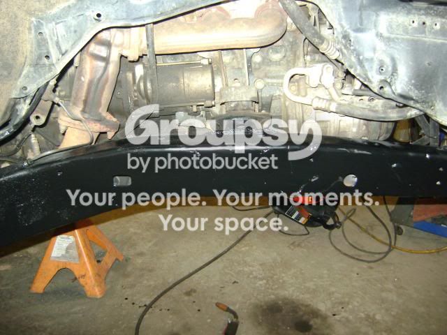

Finally, down to bare frame rails. Coated with paint to avoid surface rust over the holiday break. Ummm, that would be Christmas! Forever ago, I know.

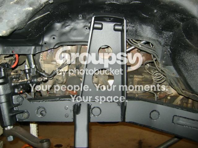

Frame plates burned in:

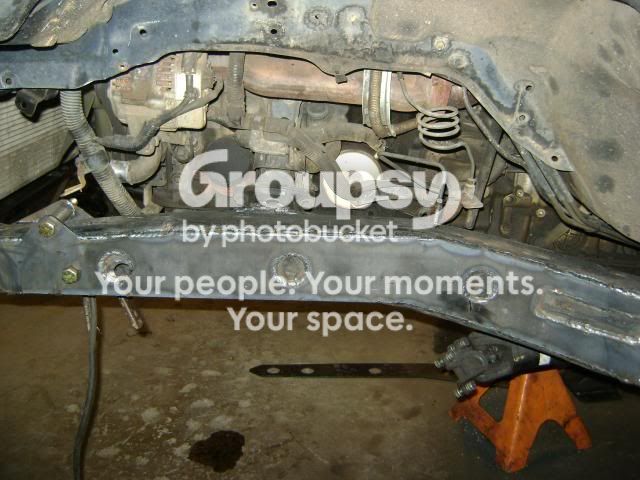

New front crossmember:

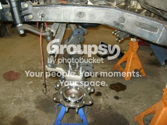

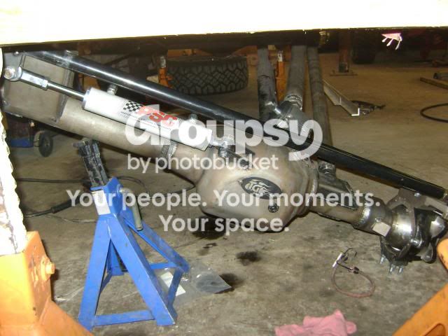

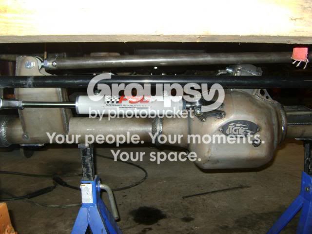

Initial axle mock up:
Feelin' Droopy

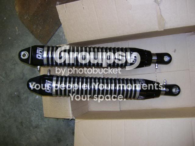

Then these nuggets showed up. It took 12 weeks from the date of order. Ridiculous.
Doesn't seem like much, but if you haven't done this before, it is a ridiculous amount of work, not to mention the brainstorming and over-thinking of every step. I will keep the updates coming (lots of pics), including flex shots, and this weekends trail pics.

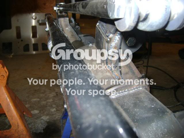

The real estate is really tight under a 4runner. The panhard, high steer, and upper link all compete for the same spot. It becomes a virtual birds nest of DOM under the front of your truck.

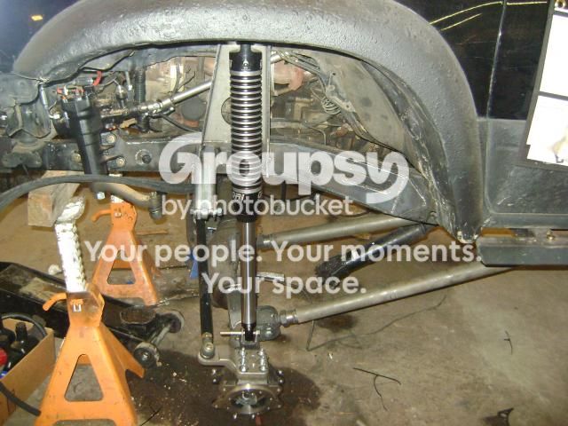

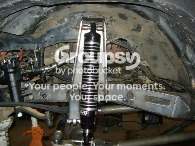

Mocking up the ORI's with some towers from TMR Customs
Gently "persuaded" my inner fenders with an air hammer to clear the towers, rather than cutting through. Though I may add a spanner bar across the engine bay later.
Burned everything in solid and mocked up diff. Turns out the Arb fitting comes out right under my upper link. 10lbs of $hit in a 5lb sack.
Towers burned in and painted

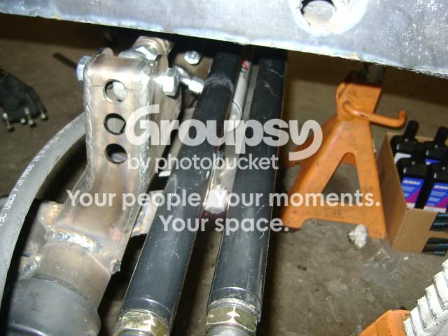

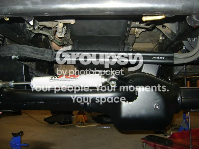

I thought this was pretty cool. Made the equivalent of a double barreled shot gun across my pan hard bar to run my hydro-assist lines thru. Full retention and protection.

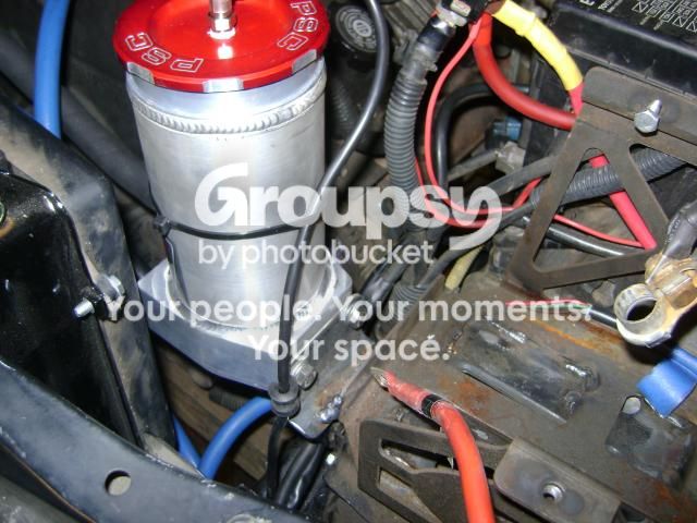

Also added a tab to the battery box in order to mount the PSC reservoir. Had a hard time finding room for that too.

Do the cross bar between the shock towers sooner than later. It won't be a big deal to go test it, but it will need to be done soon. You would be surprised at how much leverage tall shock towers like that put on the frame. I have seen gopro videos of shock towers flexing in about an inch as trucks go over terrain. Of course I am more of a baja guy than a rock guy, so it's a little different. Either way, it's worth doing and doesn't need to be crazy. A single strong tube across the engine bay is all you need, even with some bends around stuff, is still good. Just my 2 cents. Everything looks great by the way!!!

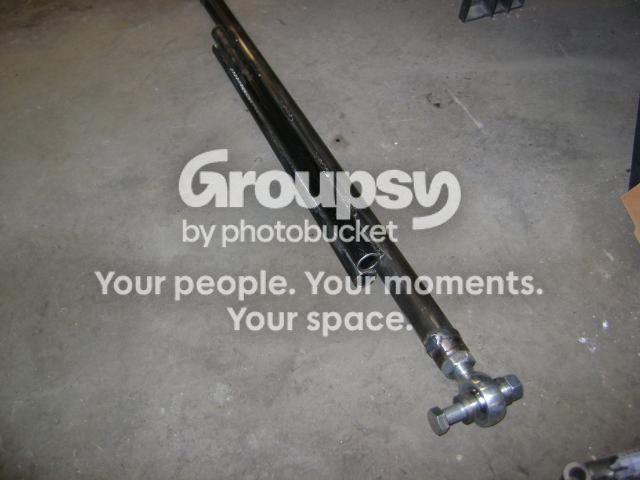

I'm going to cancel my gym membership and just do curls with these:
2" DOM .250 wall.

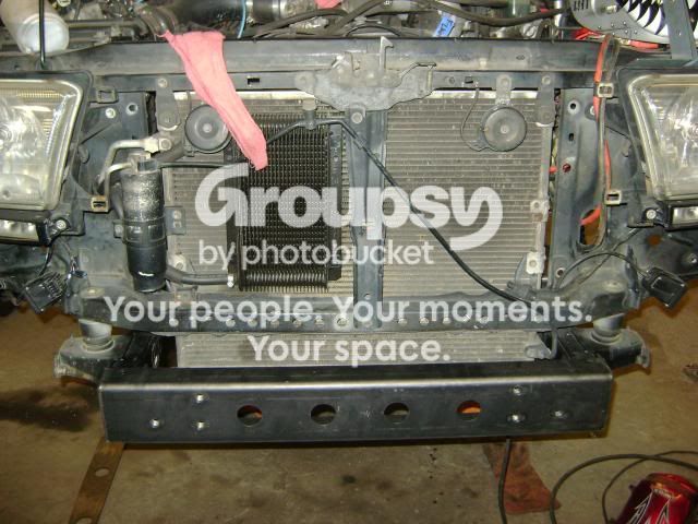

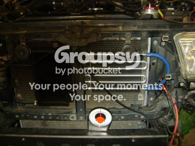

Power steering cooler, mounted next to my transmission cooler. I hope there is enough air left for the condenser and radiator.
The hydro-assist RAM looked pretty vulnerable out front. This piece of scram 1.75 tubing and some plate made nice skid.

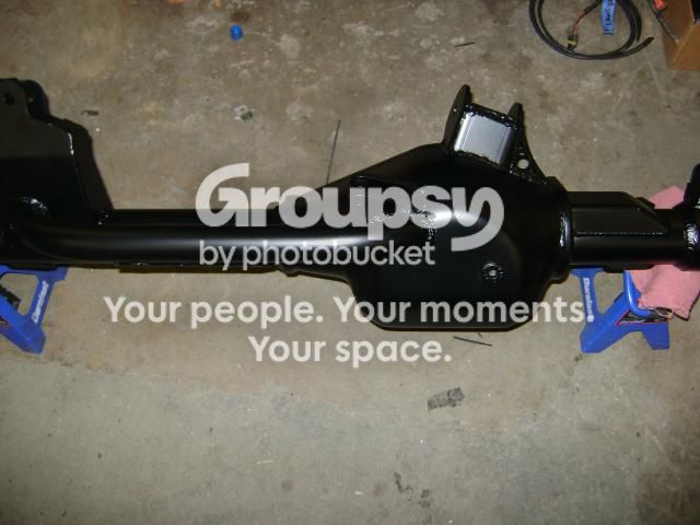

Sprung for powder coating on the housing, links, and transfer case skid. Had it done at Smoking Gun Powder Coating in Atlanta. You pay for powder then you can coat as much stuff as you can fit in their oven. Only a bit more than rattle can but the difference is night and day.
