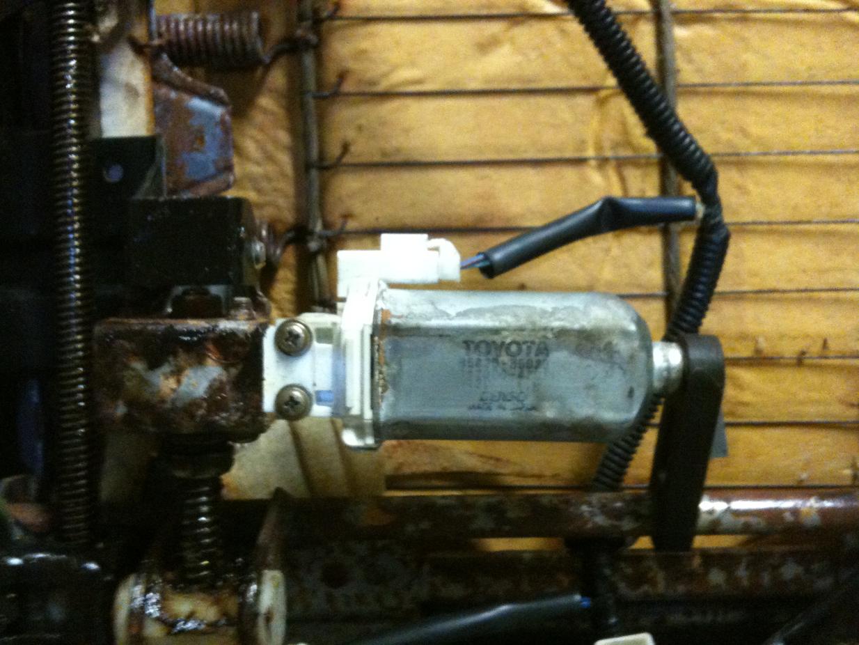

First of course check to ensure that you have 12V at the power plug to rule out a power issue.
Remove seat with (4) 14mm bolts
Remove motor with two phillips screws

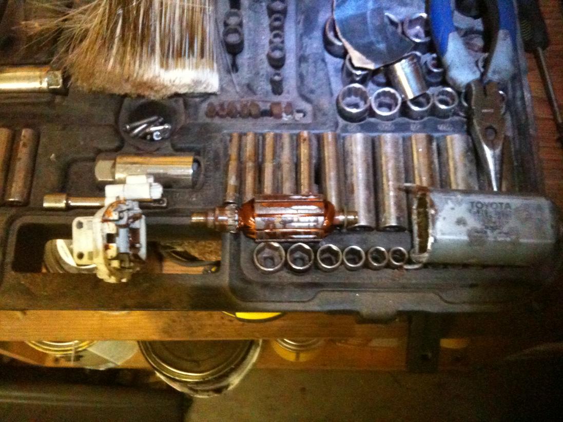

You have 3 basic parts
Brushes/Armature/Field Magnet

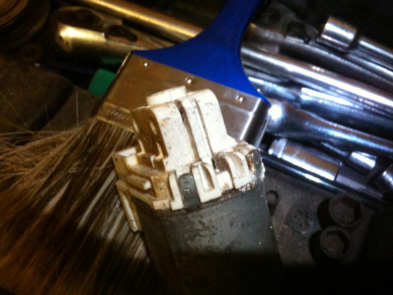

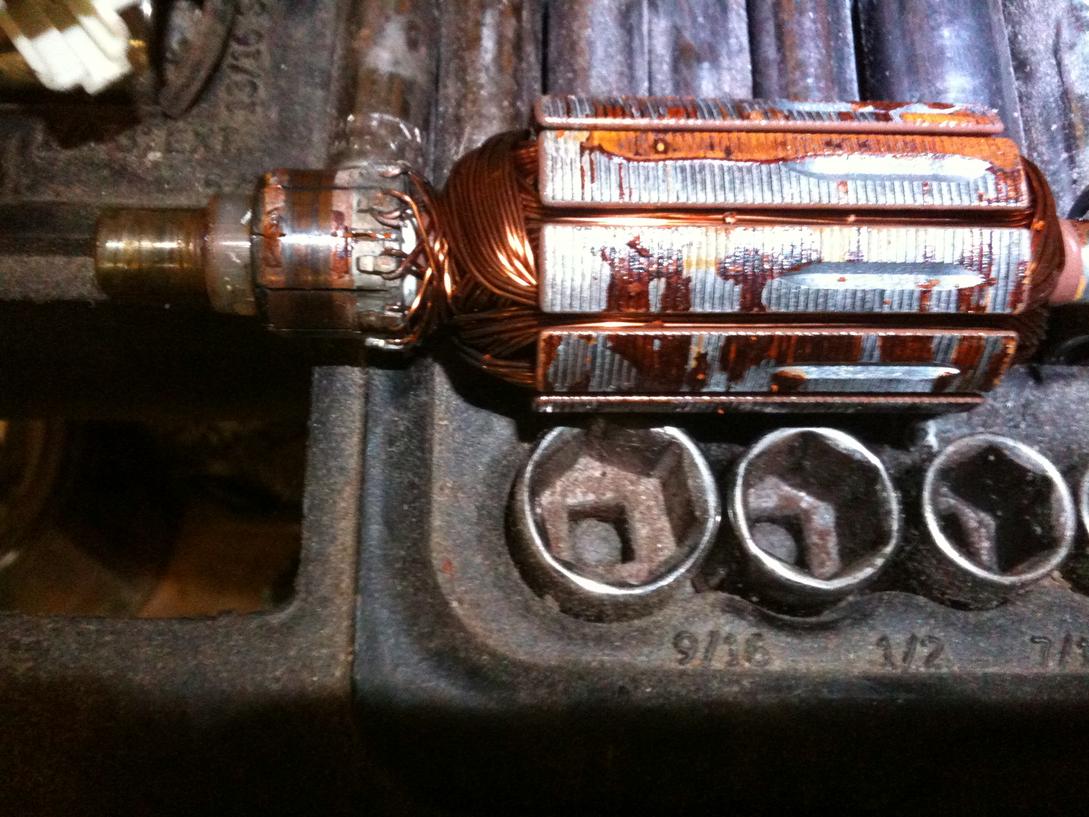

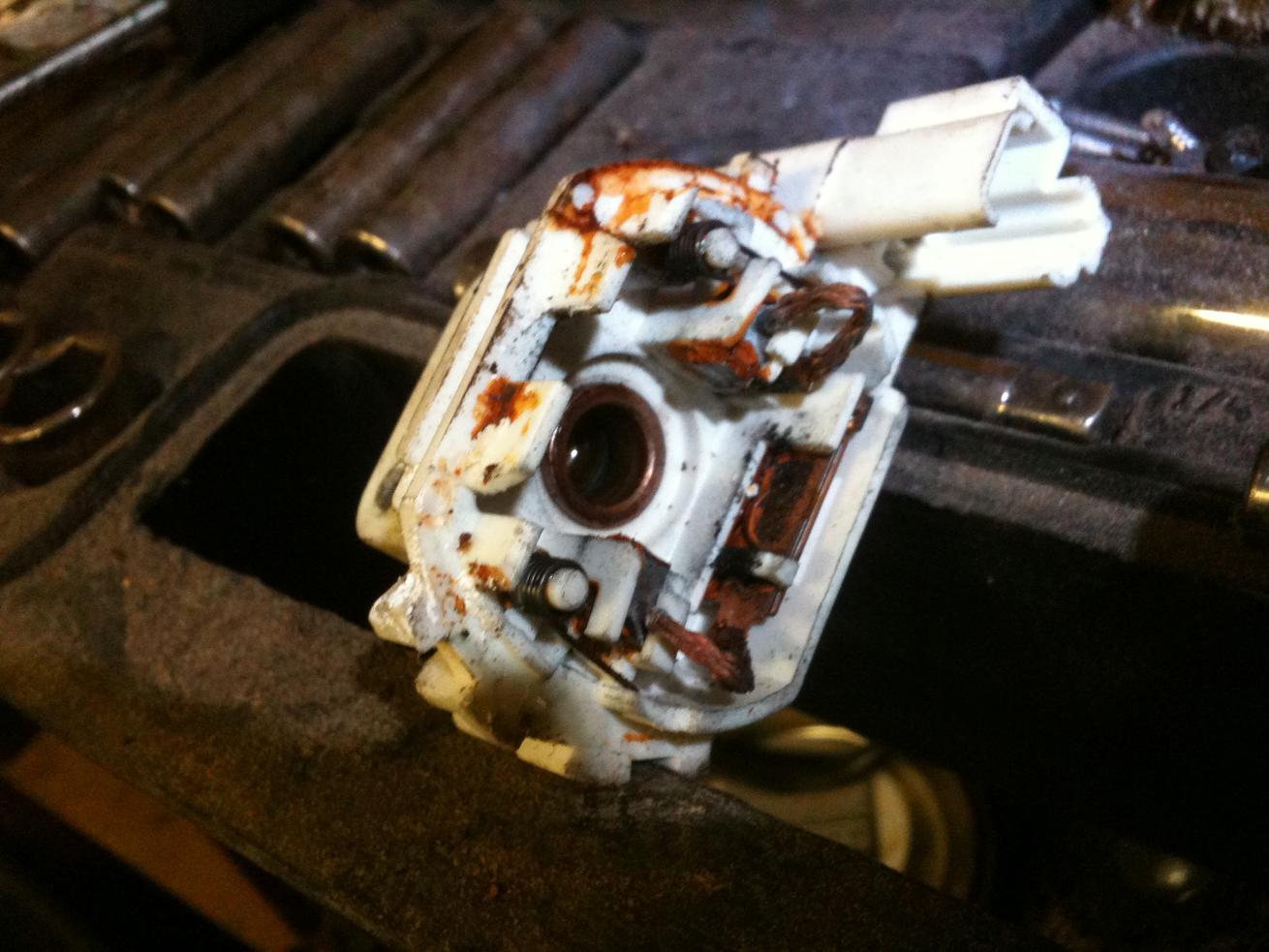

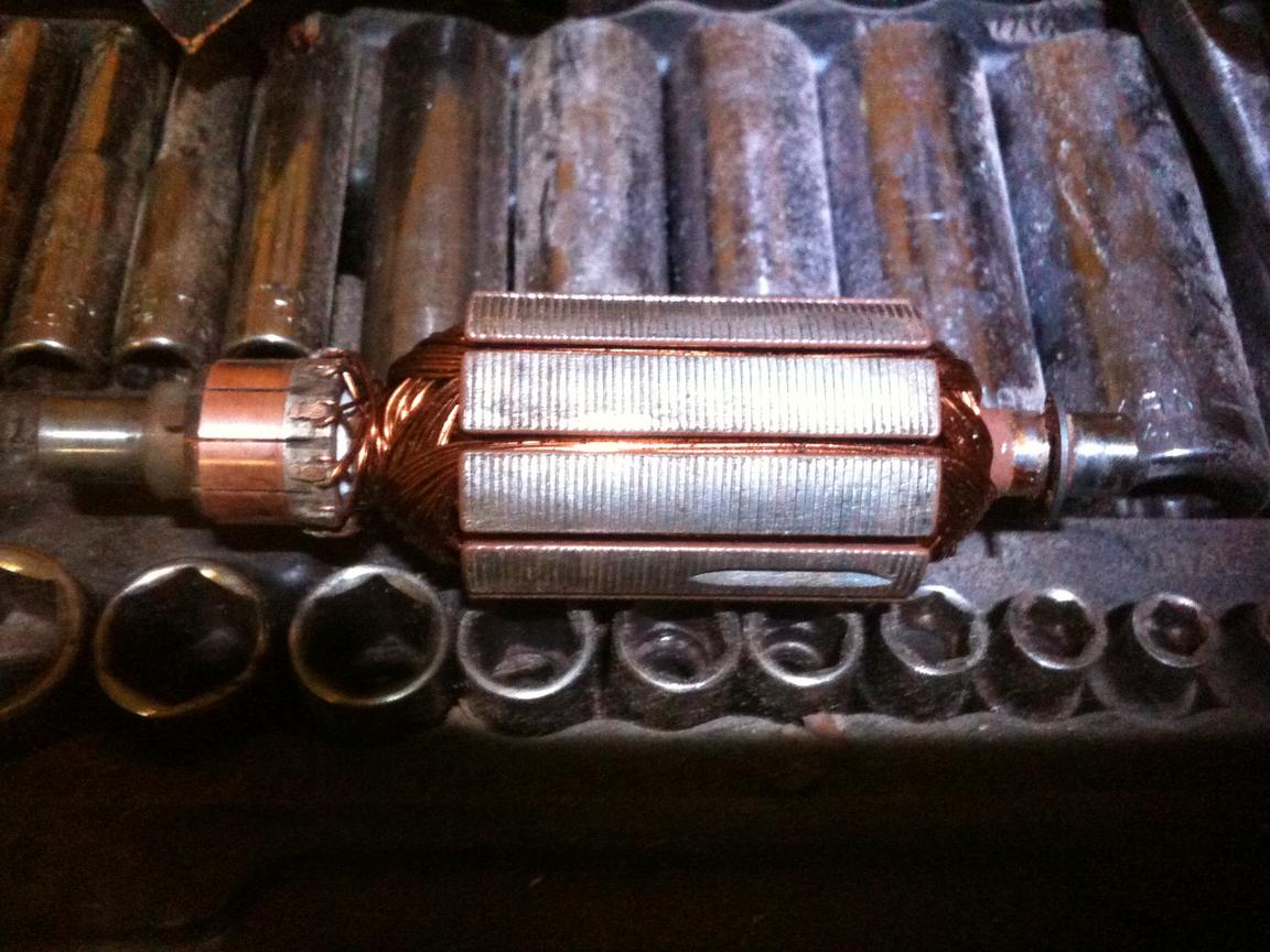

Clean all of these with either carb or brake cleaner, wire brush and/or sand paper. Primarily shining up the contact area of the armature where the brushes ride and where the field mag rides/ the brushes themselves and the slides that they sit in/ finally the field magnets themselves.

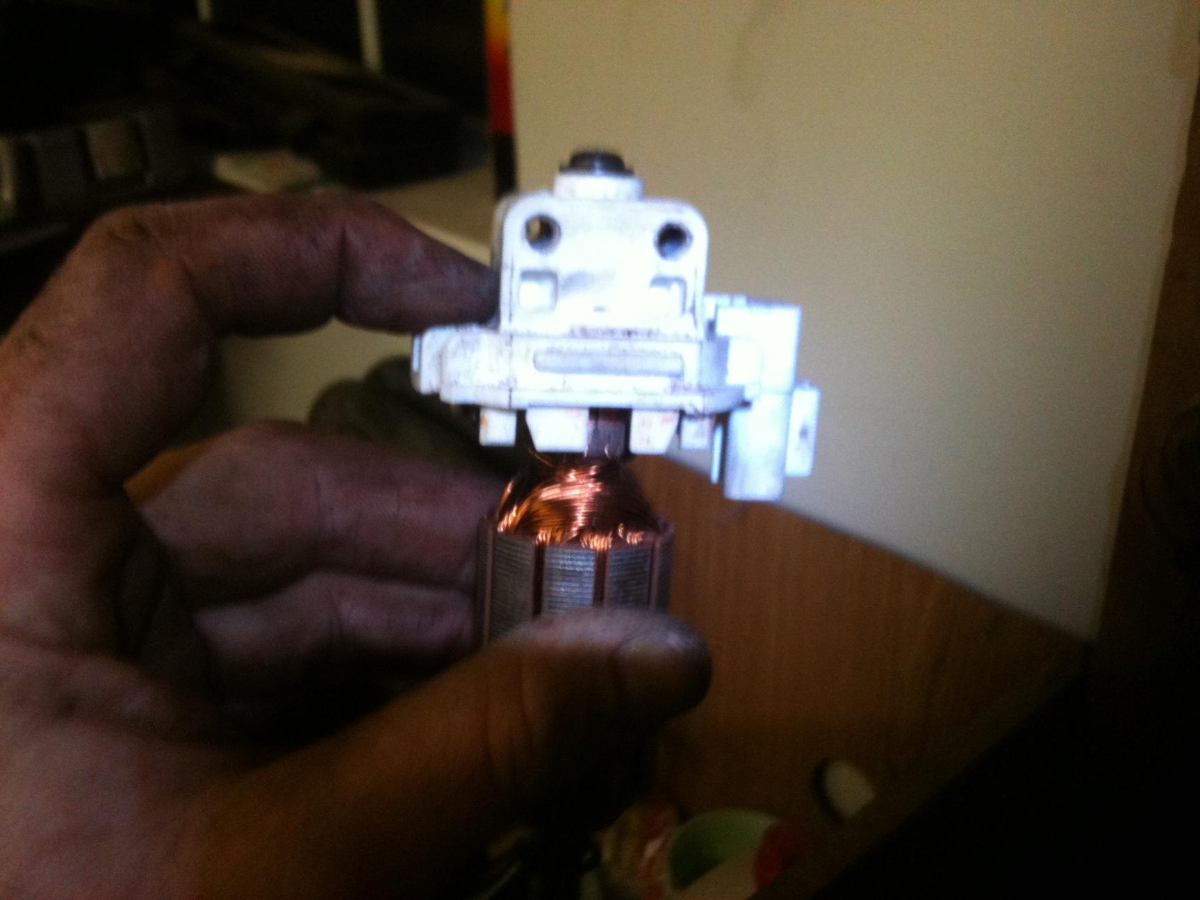

Bend these (3) tabs back with needle nose pliers to remove the cap/brushes

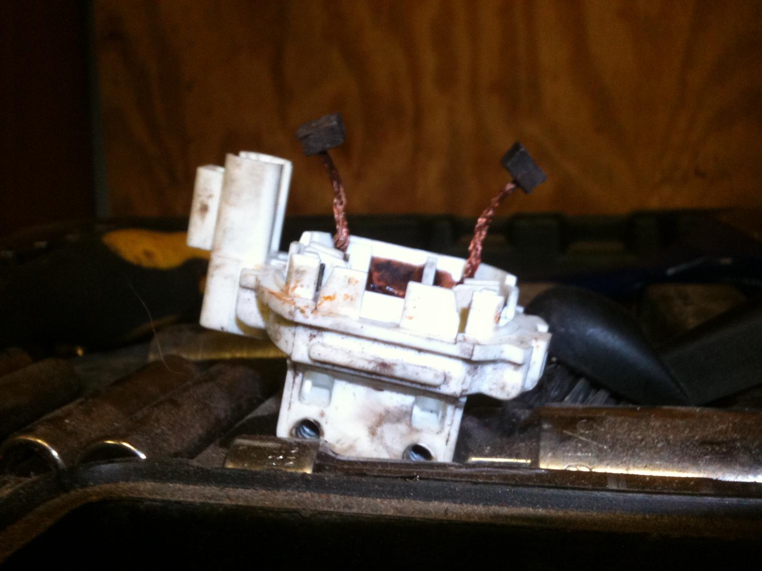

There's the brushes
Armature
There's a trick I found to getting them all back together. Pull the brushes apart to drop the armature back in the cap. Then find a screw that will hold it in place. Then you can slide the armature back into the case/field magnet. W/O the screw in place the magnet will just yank the armature out of the cap.
Bend tabs back in place and bench test
