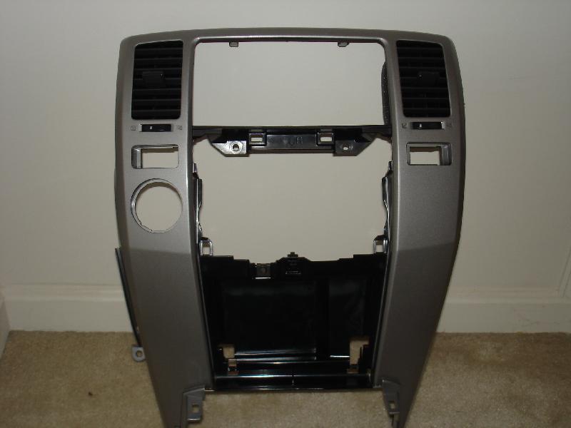

Is this the panel you are looking for?
HiVel-JR said:
I think that it would fit believe it or not. As long as it is the 4 wheel drive panel with the selector switch for high and low 4WD here is the pic, must look like this, but with the larger opening for the head unit, and all of the switches and the AC vents come off. Well I will not get too far ahead of myself, but if yours is the right one, yes we can work out a deal.
~original[/IMG]

OK I have all of the parts, but it turns out the computer that I have is the wrong year, it is an 03 or 04 so it has no airbag light under passenger on the display... so when I hooked it all up the airbag light came on on the under the tac... strange I thought, so I took the older computer (that fits the head unit) off and put mine on that fit the smaller head unit and the airbag light went off, so I am back to square one, the computer does not fit
Here are some pics,
also If anyone wants to trade computers or the panel and the computer I will... plus I will cover the shipping
oldercomputer.jpg~original
05computer.jpg~original
50.jpg~original
OK so I need a 2005 AC/computer that fits the CD changer panel, I have an old one, but it causes an electrical error of some sort with the airbags,
I have my 05 panel and ac/computer (noted as with out CD changer in parts manual) up for trade if anyone is interested.
