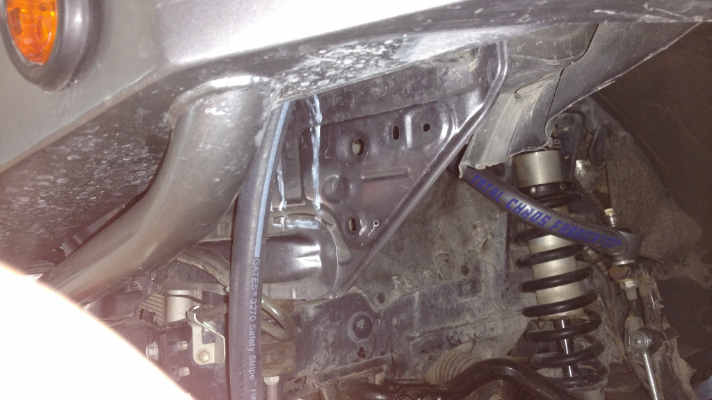

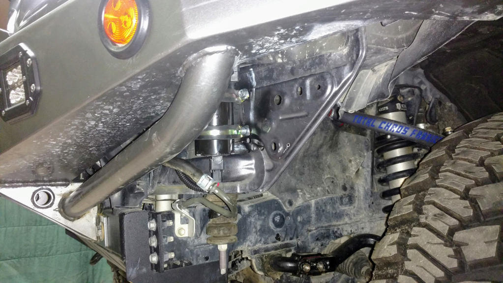

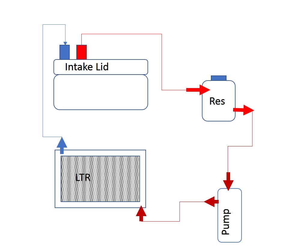

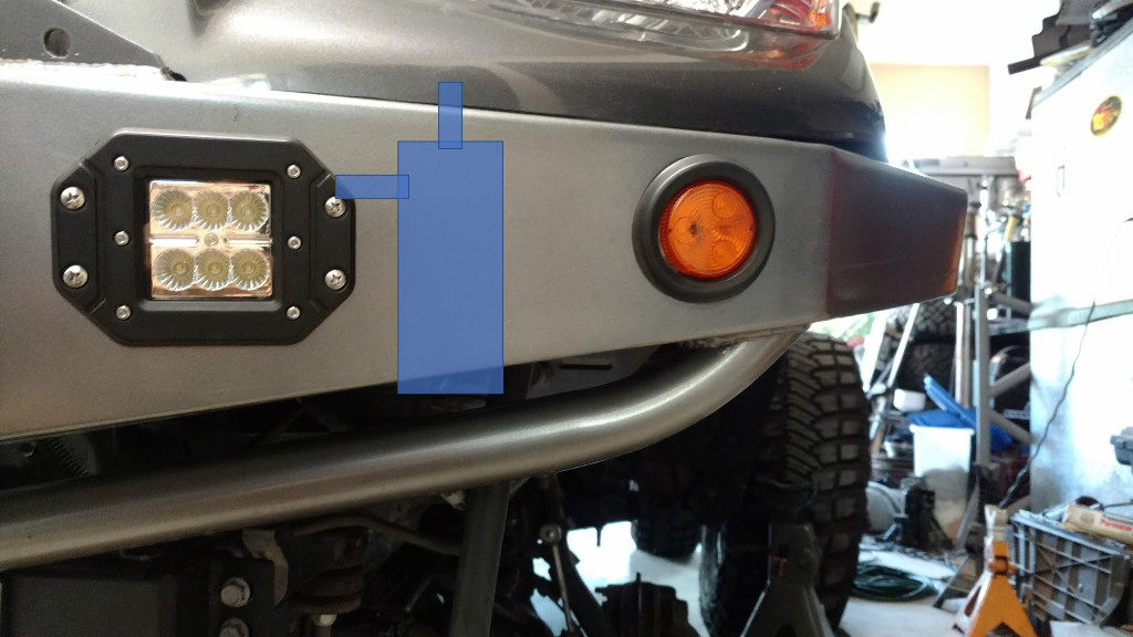

Sure, I pretty much picked the location.. and will take some pics and even a video to show the routing....I think the location should work for most aftermarket bumpers, but it may require some to be removed to get at it for install (it's very accessible on mine)... Here are some pictures and diagrams to explain the location I will most likely be going with. This would not be the ideal location on a stock bumper since there is too much in the way to get at it.... It's above and a little outboard of the front body mount... The white outline in the last pic shows the location best.

Here is the pump and routing I decided on. The pump sits vertical above the drivers side most forward body mount. The feed hose runs down by the headlight. The output goes on the passenger side and I put some heat wrap on it to protect it (probably not necessary)
I did not follow the recommended routing in the instructions as I wanted it shorter and my bumper made it problematic....
