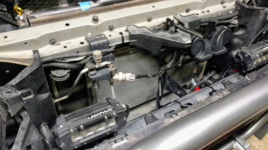

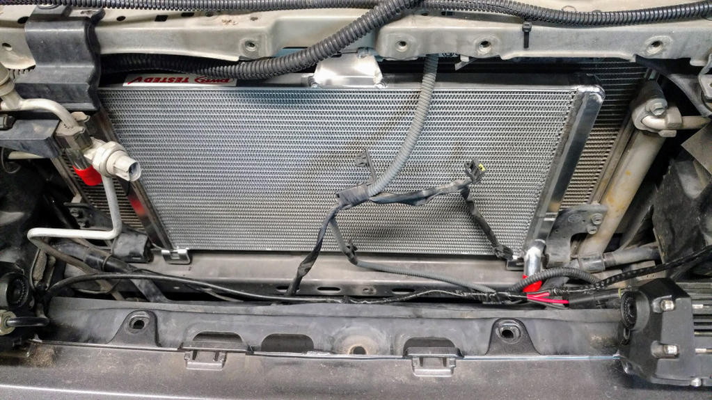

#2 I'm waiting on a few parts to show up for routing the cooling lines. Since my bumper is so tight up to everything.. the normal install location for the electric pump will not work. There is plenty of places to put it.. but I need some additional bends to keep the flow as smooth as possible and complete the installation. Also, I decided to route things differently and have less distance in the flow (and hopefully less pressure drop). I'm also going to add some heat wrap on the cool side to be as efficient as possible. All this is not necessary, it is just my typical way of over doing things a bit.. and that means waiting for specialized parts to arrive.

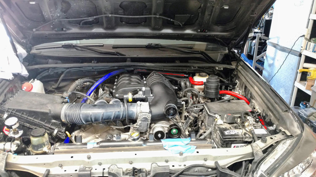

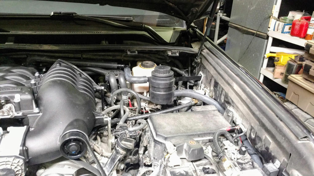

In the attached pictures you can see the LTR (low temperature radiator), just another name for the heat exchange... It sites right in front of the AC condenser and there is plenty of room even with my bumper (which is the tightest fit I've ever seen)
Normally all the hoses route on the drivers side, but I was able to save a few feet of length by routing the cool side on the passenger side. I've colored the hoses in the picture...the hoses are not red or blue... just black and there is some split loom included, but I have not put it on yet as I'm figuring out exact positioning and will do some heat shield on the passenger side. My pump is currently planned to be mounted near the fog light in my bumper wing. I currently don't have a winch mounted, but I'm making sure I will have as much room as possible to drop one in.

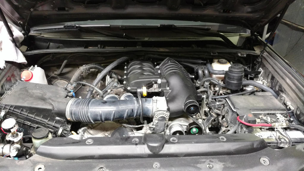

I put pretty much everything back together tonight.. Just waiting to mount the intercooler pump and wire it up after I get the two hose bends and connectors that I ordered. Then fill it with coolant and hopefully go have some fun.
Got word today the ECU should be done by next Wed. The 2010-2013s were different, so they required a new calibration which was not originally expected. So hopefully up and running by the end of next week.
The install was really easy... I can't think of anything that is difficult or very time consuming with the right tools. Just lots of steps and a little bit of thinking things out with aftermarket stuff to manipulate around. No real mechanical skills required at all. I can't really say how long it took, since I did little bits and pieces as I had free time in the evenings. But it felt like about 10hrs of work.
Suggestion if you tackle this. Keep little zip lock bags for the fasteners for each step with a sticky to label what they are and what step they came from. Makes it very easy when things are going back together... Also label all connections that you remove if you are not familiar with what they are.
I would say the only frustrating things are figuring out how to get some of the factory clips to release in a few places I tried to document some of those so more details could be added to the guide, but there are so many that I got tired of being so detailed at some point...
I'll be keeping my fingers crossed when I finally get to turn the key over that I did not miss anything.... The truck has been down longer than I expected.. but I knew there could be delays with the pilot.
I think it could easily be done in a day if you had all the required parts and the handheld tuner in the box...If you are 100% stock that should be the case. If you have stuff to move or special mounting requirements because of a winch or bumper..add a little time to sort that part out and gather the additional parts you might need. You could minimize downtime by figuring out that part first (which will mainly just be the pump location, reservoir, and hose routing for the intercooler. The rest sits directly on top of the motor so nothing to really interfere with or get in the way.
