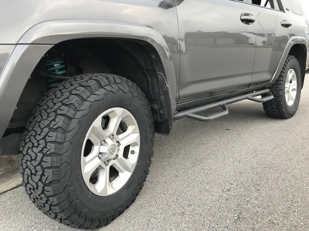

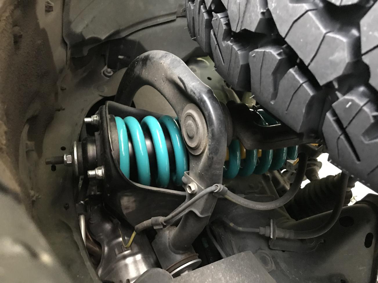

Installed a Dobinson 3" lift on the truck and added 275/70R17 BFG K02. Before the lift I measured the front wheel well at 34.25 and she sits at 37.25. Plan on getting it out this weekend and flexing the suspension.

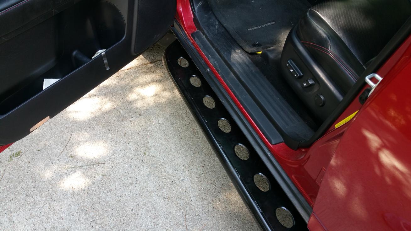

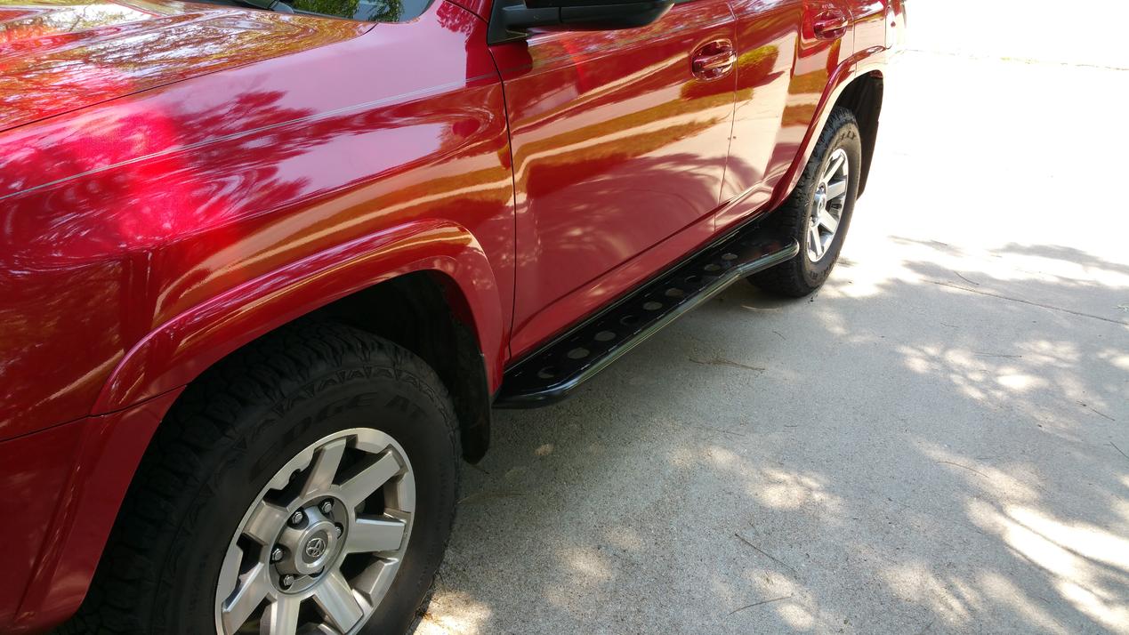

From the weekend but started the mods. Installed RSG flat sliders. And there looked good.

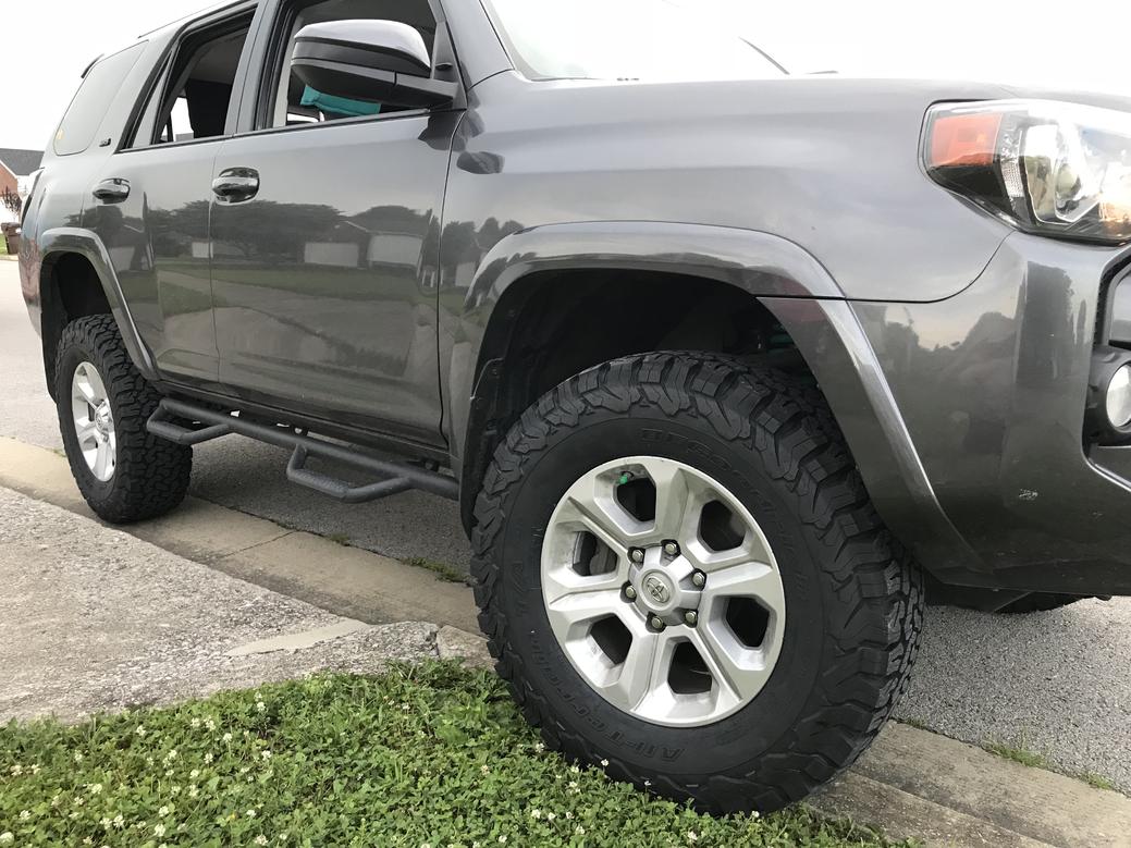

Slapped the sexy new wheels on. I think I like them [emoji16]
I've only driven them around at about 35 miles per hour so far, but I can definitely notice a difference in handling. I also very much notice how much they stick out compared to the stock TRD off-road wheels - really digging it. Anyone else notice a difference in handling?
