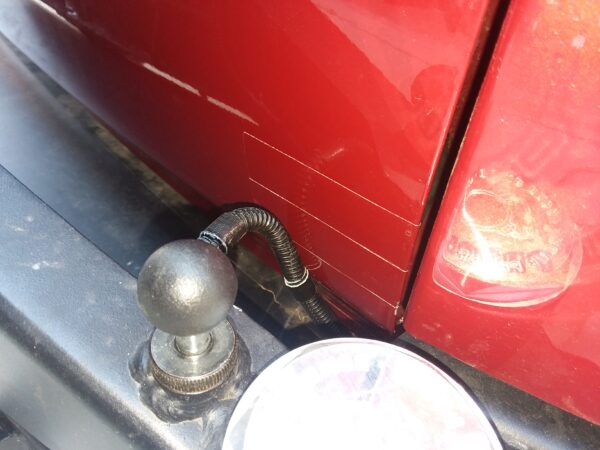

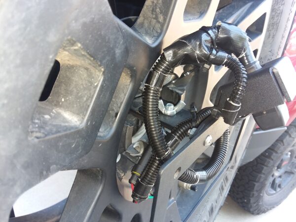

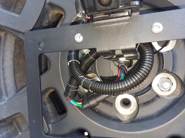

Finally finished the last step of our rear bumper install - relocating the backup camera. I'll count this as what I did today, because today I finally wrapped everything up, and put the cover for the back hatch back on.
We added a Victory 4x4 bumper, and a swing out arm for the spare tire. Did that a while back, and that was the easy part... Getting the wiring re-routed for the camera, that took a bit of doing.
I used the bracket from the Victory kit, but didn't want to cut and splice the wires in the head-liner, per their instructions. Instead, I bought 4 20-foot lengths of 20 AWG wire (camera), and 2 20-foot lengths of 18 AWG wire (license plate LED) and used that to route down to the connection points inside of the back hatch. I wound up using about 18.5 feet for the main cable, and the 1.5 feet for a connector 'tail' that allows the camera and licence plate to be easily removed.
I didn't want to cut the original short camera connecting wire, so instead bought a couple of connectors - one on Amazon, one from a company that sells on ebay. That was a mistake. The camera connector was designed for 22 or maybe 24 AWG wire, and I was working with 20 AWG. And the connector I bought from eBay wouldn't seat all the way... Turns out that the connecting wire is only $11 from Toyota. So I bought one of those to cut and splice, and that was so much easier. Water over the dam... But for others doing this, you can buy the Toyota OEM cables and cut them to use for connectors for a reasonable price.
Other notes that might be helpful to someone else doing this:
- I was able to use 1/4" split loom cable wrap, and run it all the way up the pillar inside the hatch. This keeps the wires from being pinched in the upper corner of the rear hatch as they are pulled.
- I also used 1/4" split loom to run from the headliner down past the passenger rear tail-light, and out the rubber grommet on the rear passenger side. Plus a bit of 3/8" split loom as reinforcement in key areas.
- I added some Racer's tape / Helicopter tape to the back hatch to eliminate any scuffing from the wire-loom against the hatch.
- Finally, instead of just terminating the wires at the camera connector, and the LED license plate light, I put a 6-pin Weatherpack connector in the mix. This makes it very easy to disconnect the license-plate bracket with the camera in a way that then makes it easy to take the spare tire off. I think this is a very important improvement. Who wants to be futzing with the connector to the camera when trying to change a spare? Yes, this connector will need to be cut off, if the carrier itself is removed, but that should be far less frequent an occurrence than pulling off the spare tire.
I've added a few pictures. Not the best, but they may give someone some ideas about what can be done.
