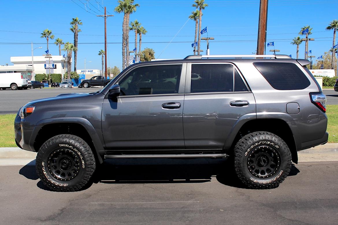

Finally got a chance to snap pics of my new suspension:
OME 885 Coils w/ Bilstein 5100's set at .85 in Front
Light Racing UCA's
Differential Drop Kit
Toytec Springs in the Back
Bilstein 5100's Rear
Goodyear Duratrac 285/70/17 on Method NV Race Wheels
I'm a happy camper :D

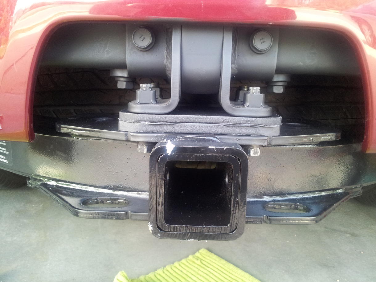

Hitch Receiver
I've been stalking long enough now.
Installed a Lexus GX 460 WD receiver on my 5th gen today.

forgive my ignorance... what's the difference between the lexus and toyota version?
Toyota (nor anyone that I have found to date) seem to offer a version of this type of WD receiver for the 5th gen 4Runner. Also, this hitch requires some "modification" in order to install.

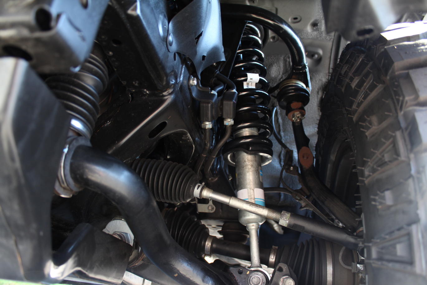

Back in Denver I ran up to Toytec and picked up some spanners to adjust my front coilovers. Picked front up about 3/4" after bumper install. Leveled out nicely, and super easy procedure once I got a cheater pipe.

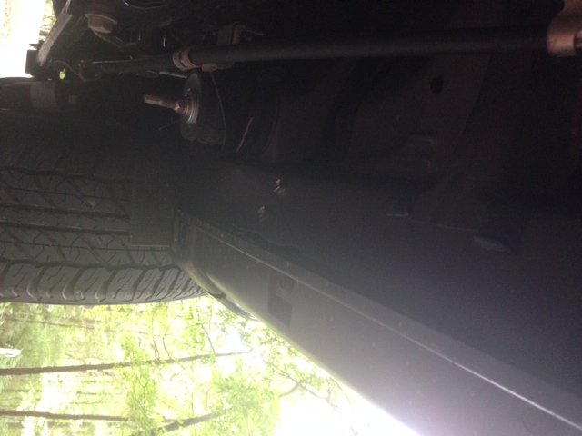

Added N-Fab Wheel-to-Wheel side steps
I Added some N-Fab Wheel-to-Wheel side steps to my Mag Grey '14 TE today. It was a simple and fun mod.
The only issue/note I would make is that when I used the 13mm socket to remove the factory bolts (per N-Fab's instructions), the bolts would sometimes move around within the socket. When I downsized to a 12mm socket to remove the factory bolts, it worked much better. Adding N-Fab bolts, locks and washers was simple with the 13mm socket per instructions.
Installation of both sides took about 30 minutes with my lady helping to hold the steps in place while I could start hand-threading the bolts. Only 5 bolts per side, 1 in the front, 2 in the middle and 2 at the rear of each tube.
I think the new steps really add to the appearance and usability of the truck! This will make it much easier for my 70 y.o. mother to climb up inside when she visits too.
