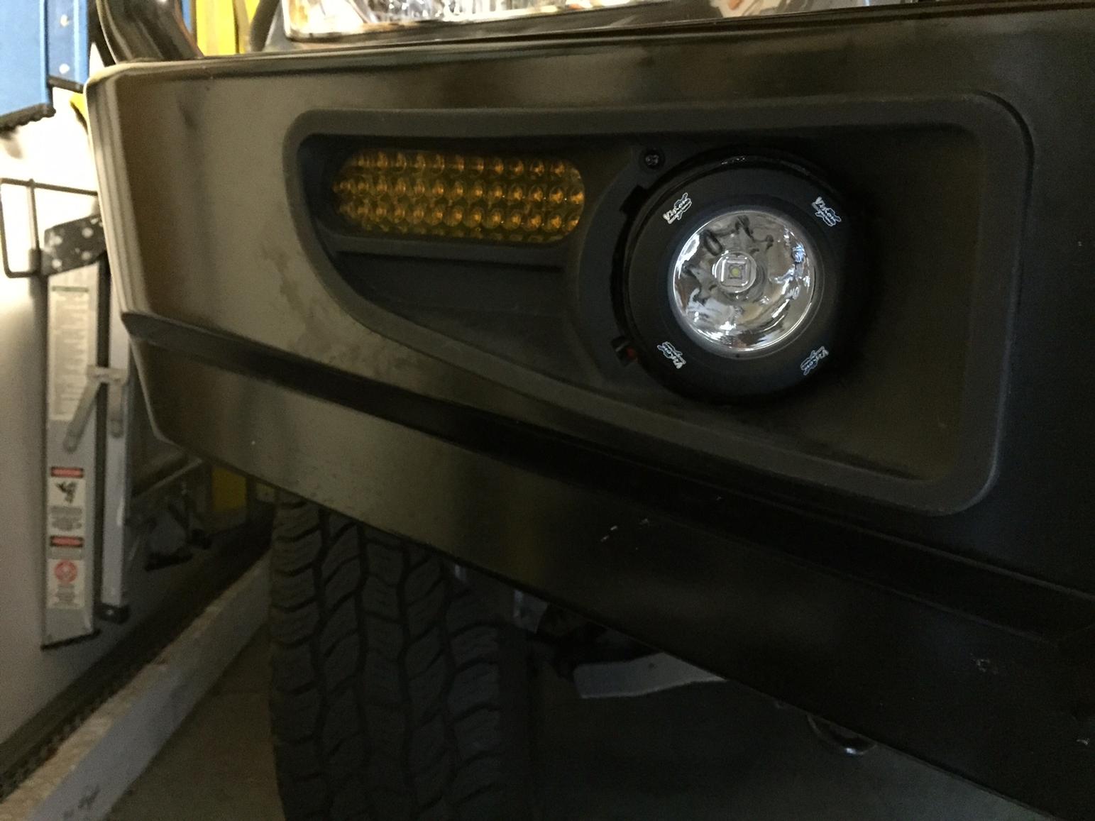

Finally added some LED fogs from VisionX - made them fit the ARB insert. Took a little bit of fabrication but the end result uses the ARB method for aiming.

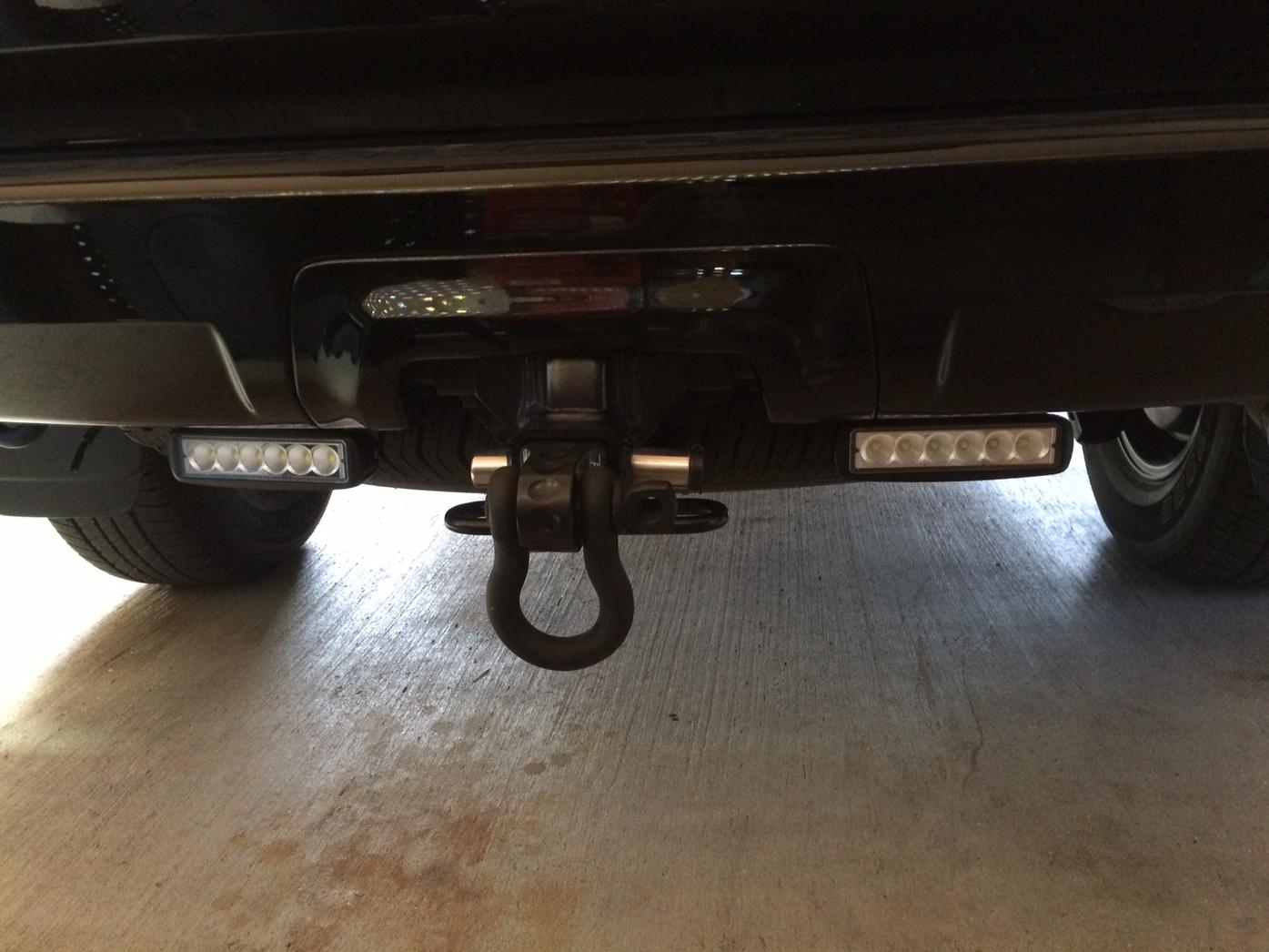

Kudo's to [MENTION=115536]jima60[/MENTION] for the idea and did this today!
Wired to the TOWING BKUP light circuit.
Purchased from ebay: 18w 6INCH LED WORK LIGHT BAR FLOOD
They make a huge difference at night looking thru tinted windows and also lots of light when looking at BU camera!
Because you don't have enough aux. lighting already?
:thumb3:

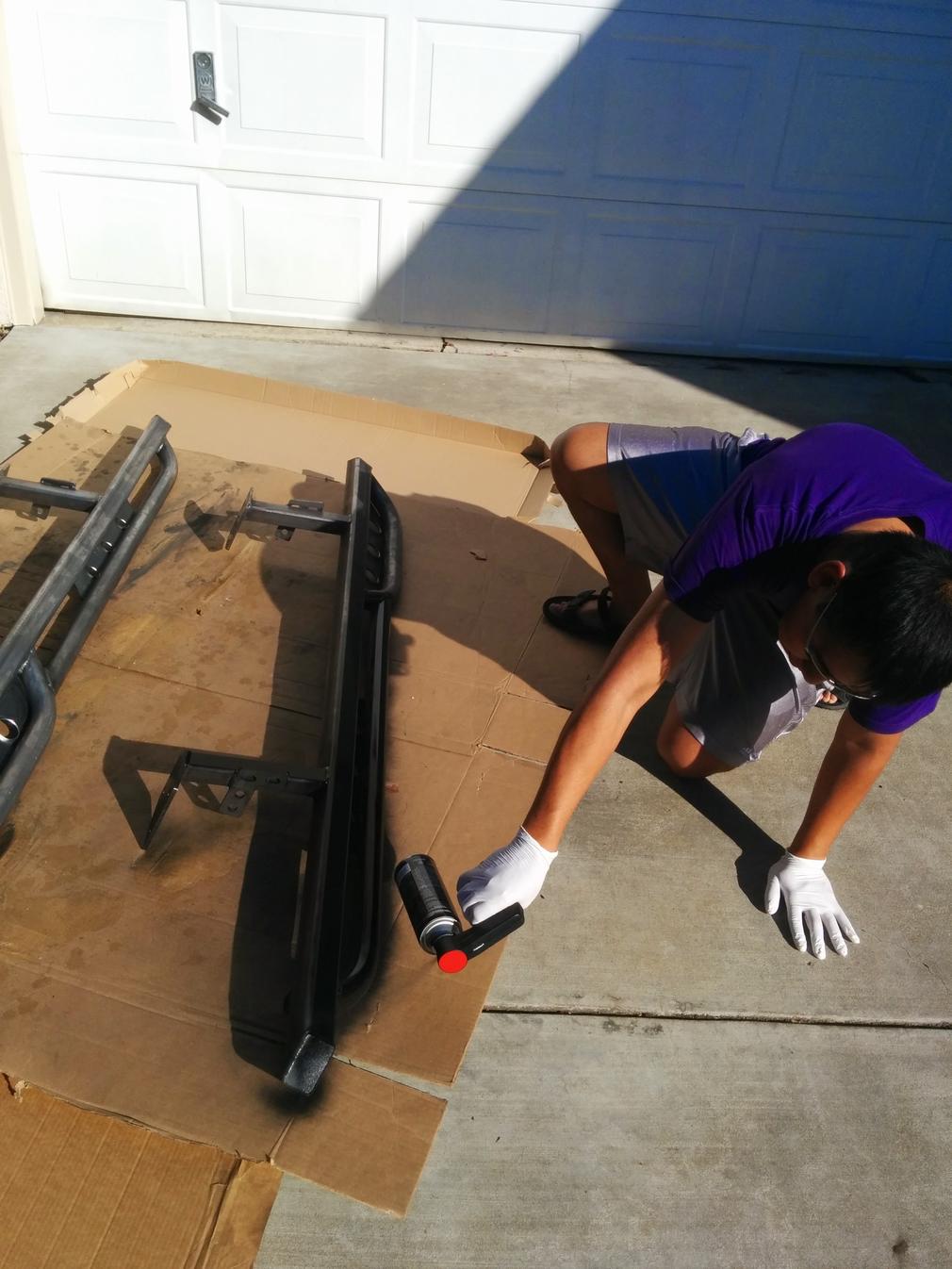

Painted my opor sliders for my 2015 limited.
It was a major PITA to clean the caked on oil/grease that coated the bare metal. Took me a solid day of scrubbing with acetone and super clean. Super clean + 3M blue super rough stripping pad is the key. And tons of disposable latex gloves.
Looks good!!
My next project is your behind the grill light bar installation. I ordered 21.5" that is switchable between white and amber for foul weather. It should be here tomorrow.
I want to do the same thing just scared to mess with the tow harness wires
I can tell you the White wire is the ground and the yellow wire is the TOWING BKUP on my 2014 SR5 Premium.
As always, check with a test probe to make sure.
Remember that circuit is only 10 Amps.
