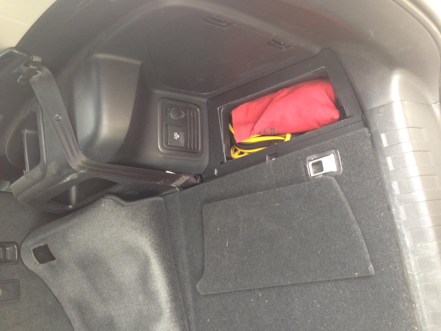

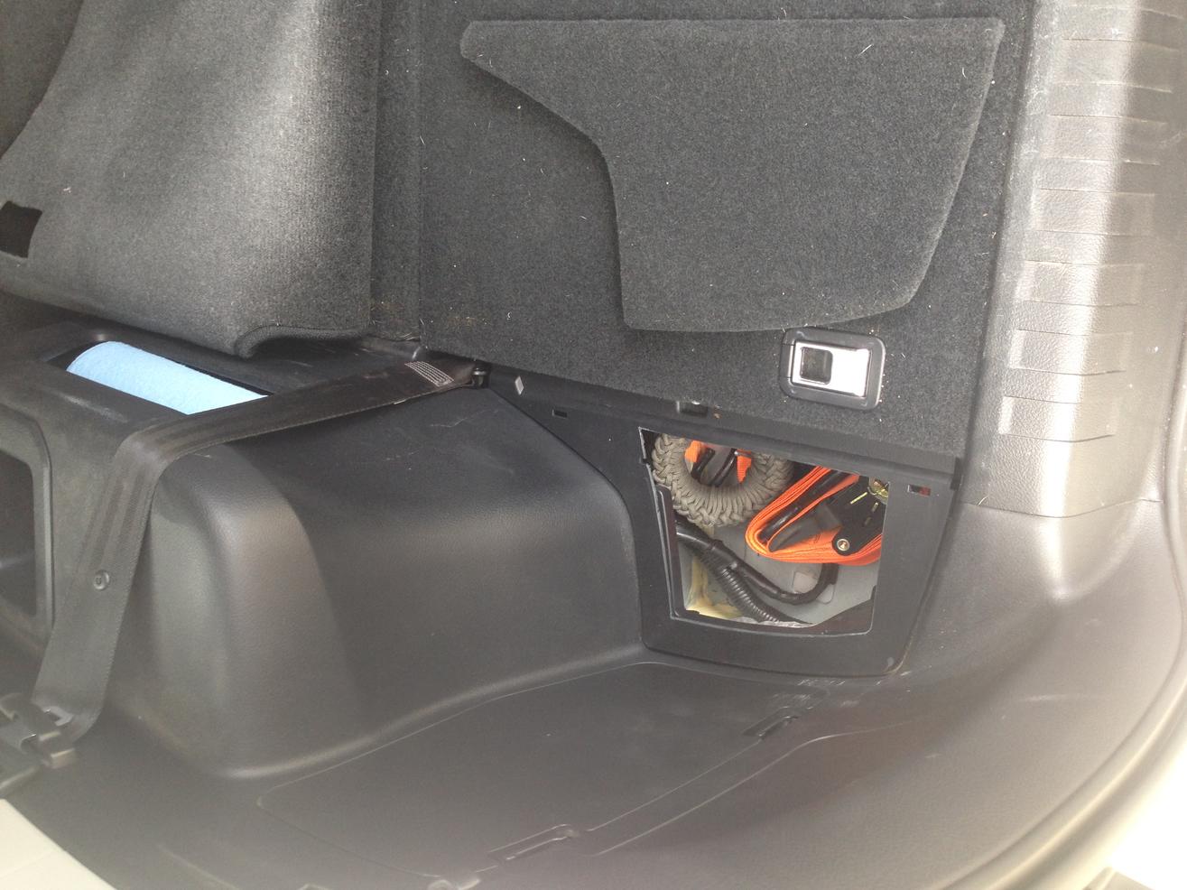

Found some free storage in the back of my 4R. Can only be found with the third row option. I have jumper cables and a tool kit in one side and tie downs/straps in the other.
how did you get those off, ive tried but don't want to break them
Take the two anchor points off. Lift that back cover off, there is a clip in the middle, just pull. Then using a pry tool, each end piece will pop off. I thought I was going to break them too. Pull hard. Then on the back of those pieces there are two screws holding the carpeted piece on and a bunch of tabs. Remove them. Trace out the opening you want and cut it out. I used a hot knife but a dremel will work just as well. Make sure you leave at least one of the rectangle holes front and rear on the bottom piece for the cover to snap into.

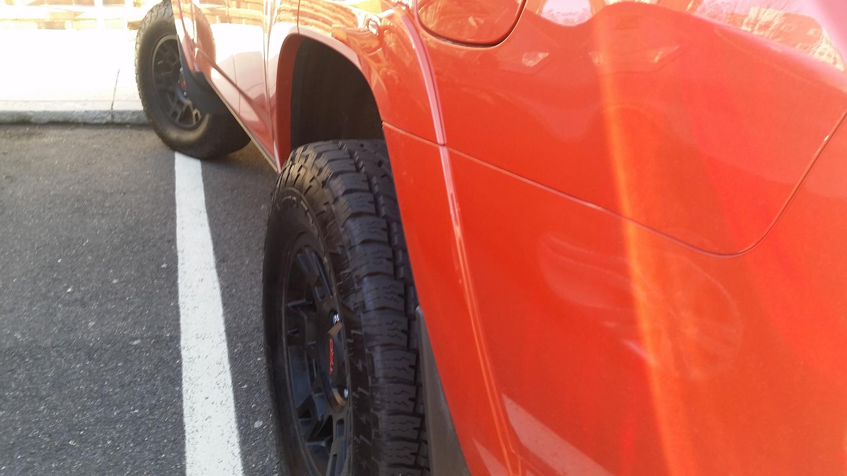

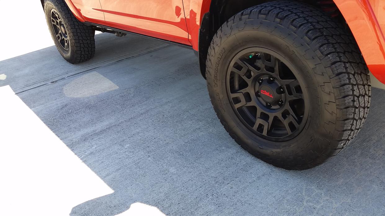

Put spydertrax spacers on today, I've been skeptical of spacers in general for a long time but decided to give them a shot. Impressed with the quality and they were easy to put on. I did 1.25 inches and I think it's just the right amount. Little bit of rubbing at full lock that I'll have to take care of, but very happy overall.

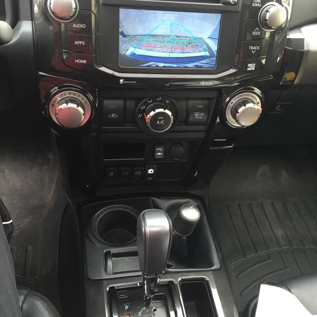

Followed others instructions who paved the way , Back up Camera Any Time, I used a OTRATTW SPST switch and 2 diodes. Instructions only called for one to keep the truck from throwing lights when using the switch but when I had everything wired up I realized my switch light came (upper) came on when I put the truck in reverse even if the switch was in the off position. Added a diode in that line to stop that so the light only comes on when the switch is actually on.

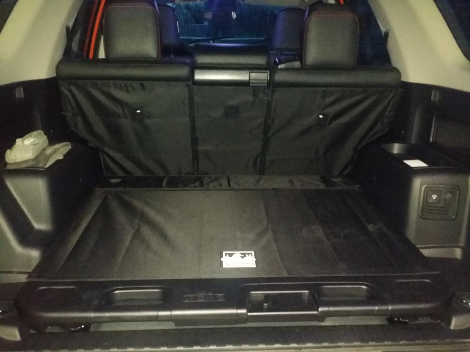

Just installed a canvasback liner, very impressed with the quality of this product. Hand cut and Hand stitched.
