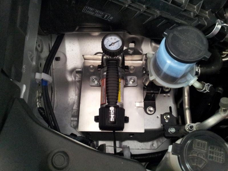

Finished the hardware side of my Compressor install. Still need to get a relay and run a switch inside the cab. For now I am using battery clamps direct off the battery if I need to use the compressor.

Looks awesome! Did you make that mounting plate yourself? Get some more pics up here! I've been looking to do something similar.

I did some doodling on the picture, will try to add more later. I cut some aluminum sheet down to size and mounted the compressor with the two inch conduit clamp, the compressor has rubber feet at each corner which absorb most of the vibration and raise it up a little. As an after thought I cut another piece and bent into a 90 degree and used it as an endcap to limit movement. I still need to get a relay and run switched power out of the cab but that will wait a bit.:cheers:

Sorry had a moment here is the picture with doodles.:dammit:
