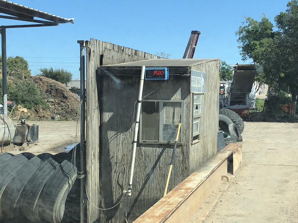

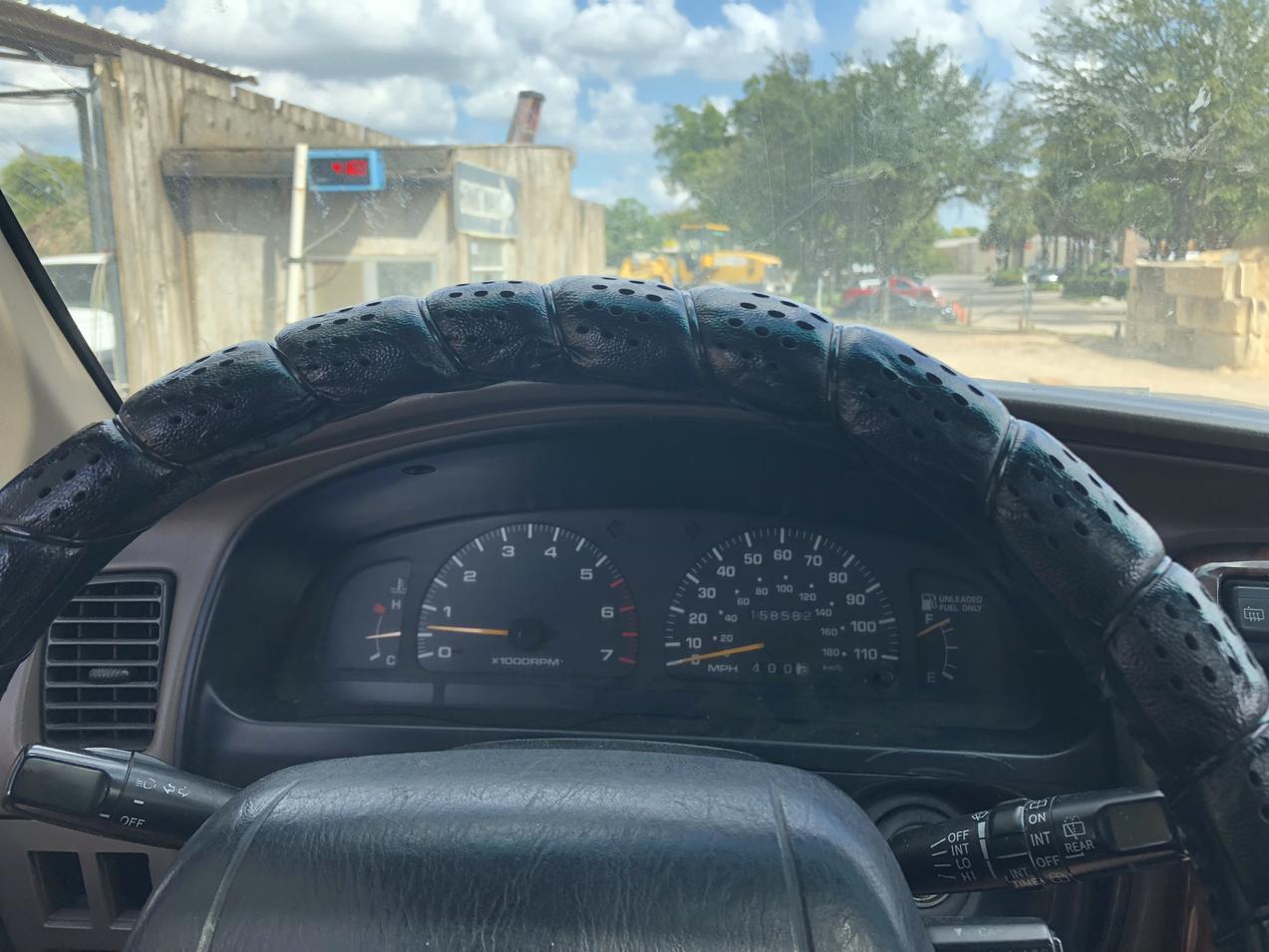

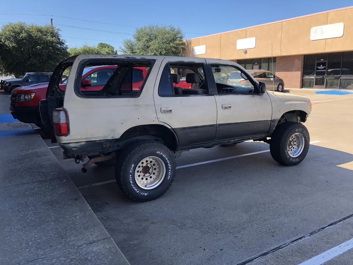

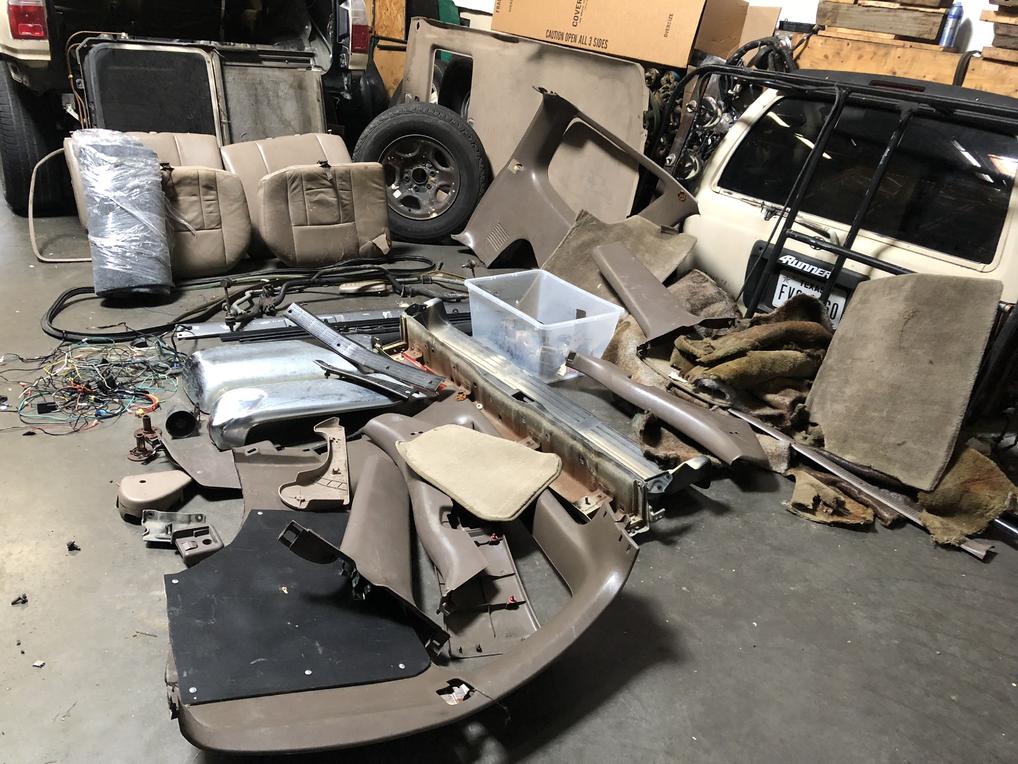

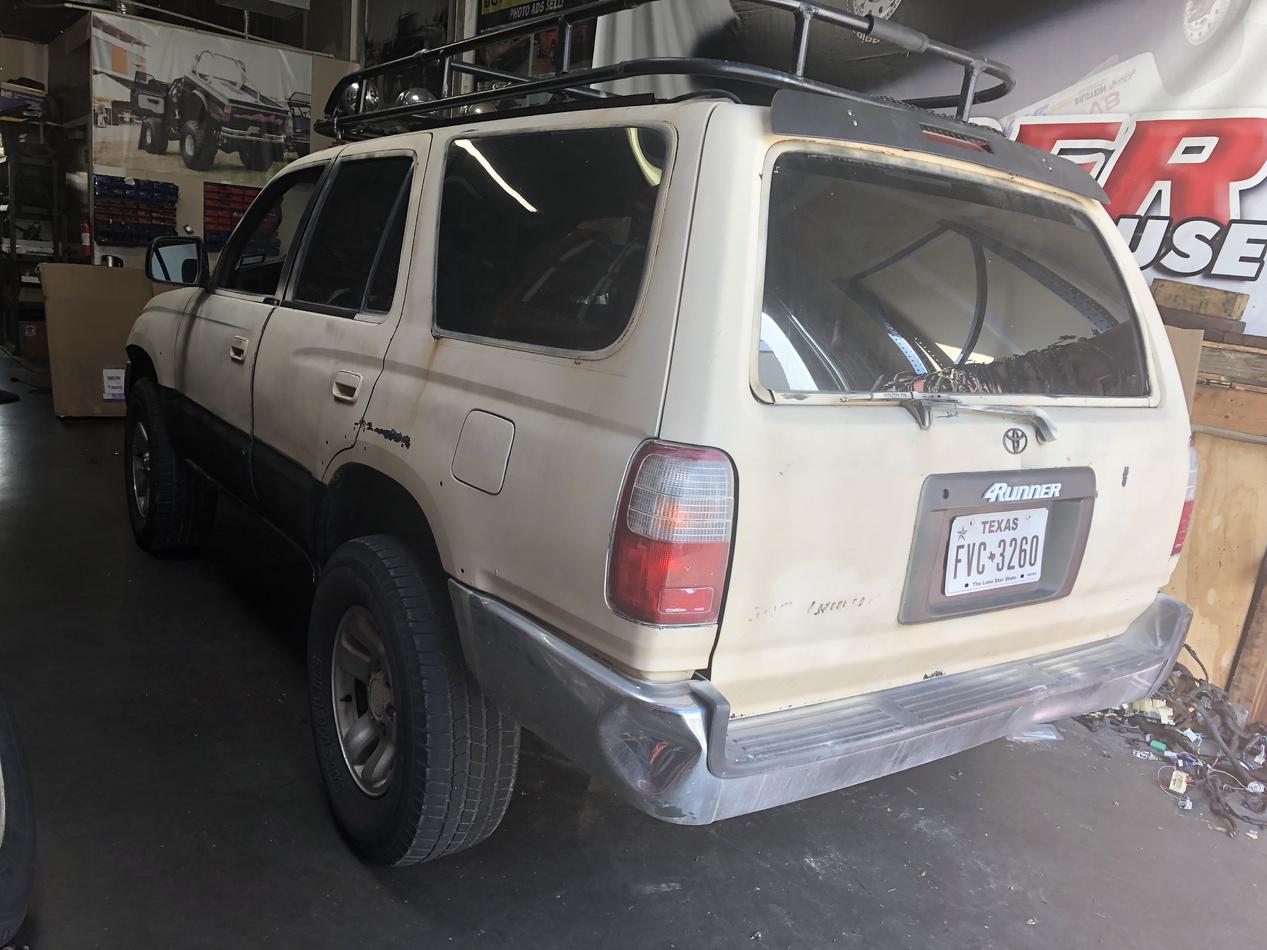

What's the plan for that? Race car?
Well.... lol. So I bought this 150k e locker truck from a customer who had it in a pretty sad state. Driveline was excellent but this truck has been t boned and was a massive cluster of wiring gone wrong. Literally everything that someone could have messed up inside and out was nicely haggered up. Sooooo, I thought why not take anything and everything out of the truck I possibly can to make it as light as possible. In doing so it will be quicker and lighter for when I take it mudding etc. the plan is to chop top to convertible, cage it like an H1, make half doors and run 35” boggers when I take it to the trails. The whole fun will be to see how fast I can make it by simple removing unnecessary weight. Both times on the scale was my weight and a full tank of gas.

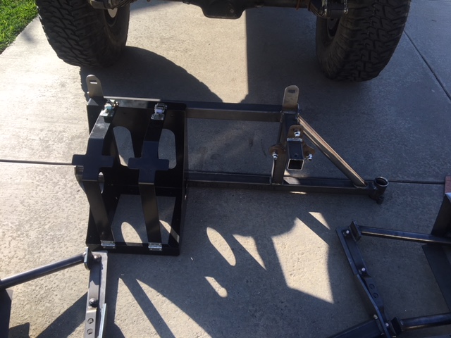

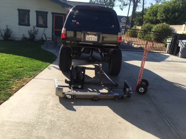

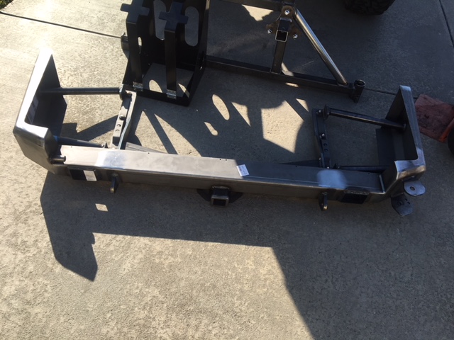

Weekend Project
this just showed up, so I have something to keep me busy. First things first, I need to modify it to fit.
