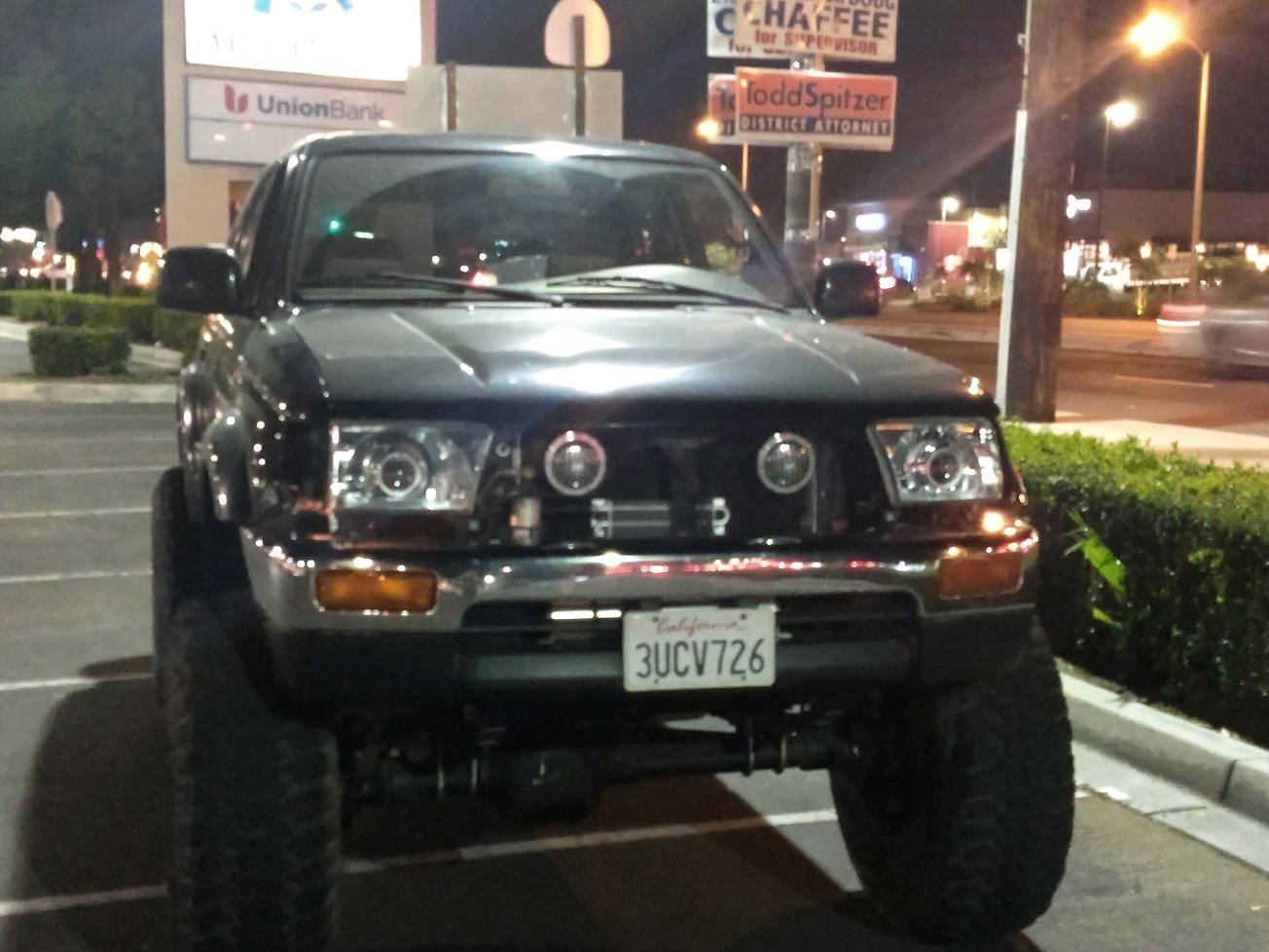

I bought a set of SRQ Morimoto HID's from a member here, that was earlier in the week. I just got some free time to install them.
That went Very smoothly THANK YOU
The lights are subtle, no extra stuff, just HID's. White and bright So got those installed.
I just wish they didn't look like eyeballs.
The grill is still out because I'm deciding what to do with it..Ziptie it back in place, You can't tell when it's installed, or replace it , Also I may need to adjust the lights.

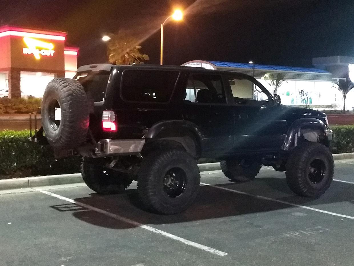

Headlight adjustment may be in order due to the 4XInnovations bumper/tire carrier, guessing loaded it's about 300 Lbs. on the back of the truck.
I called and had them change a few things, then still spent a couple hrs with the plasma and grinder "Modifying" it. No fault of 4XInnovations with the rear converted to leaf springs It needed some work.
Lets start with this thing is heavy duty, much stronger that the rear of the truck, or the frame its mounted to I'm taking a good look at the frame to see where I can strengthen it. I may end up plating a section of it.
working with two floor jacks and jack stands I got it up on the truck, I'll drive with it for the week, then pull it, clean, prep, and coat with POR-15, easy tiuch up.

Great looking 4runner man. So, one tip for the rear 4X Innovations rear bumper, or any rear swing out for that matter. I would add some solid body mounts to the rear if you have not done so already. >> 1996-2002 4Runner Rear Polyurethane Body Mounts (Pair) - $82.20 : Sonoran Steel Fabrication LLC, Toyota Truck Parts
I know someone else offers a whole kit, I don't recall who. But if you are running an OEM mount, it may still allow enough flex going over terrain to allow the rear frame to flex away from the body and as a consequence allow the bumper to hit the body. This has happened to a few who had not upgraded their mounts. Keep up the good work man.

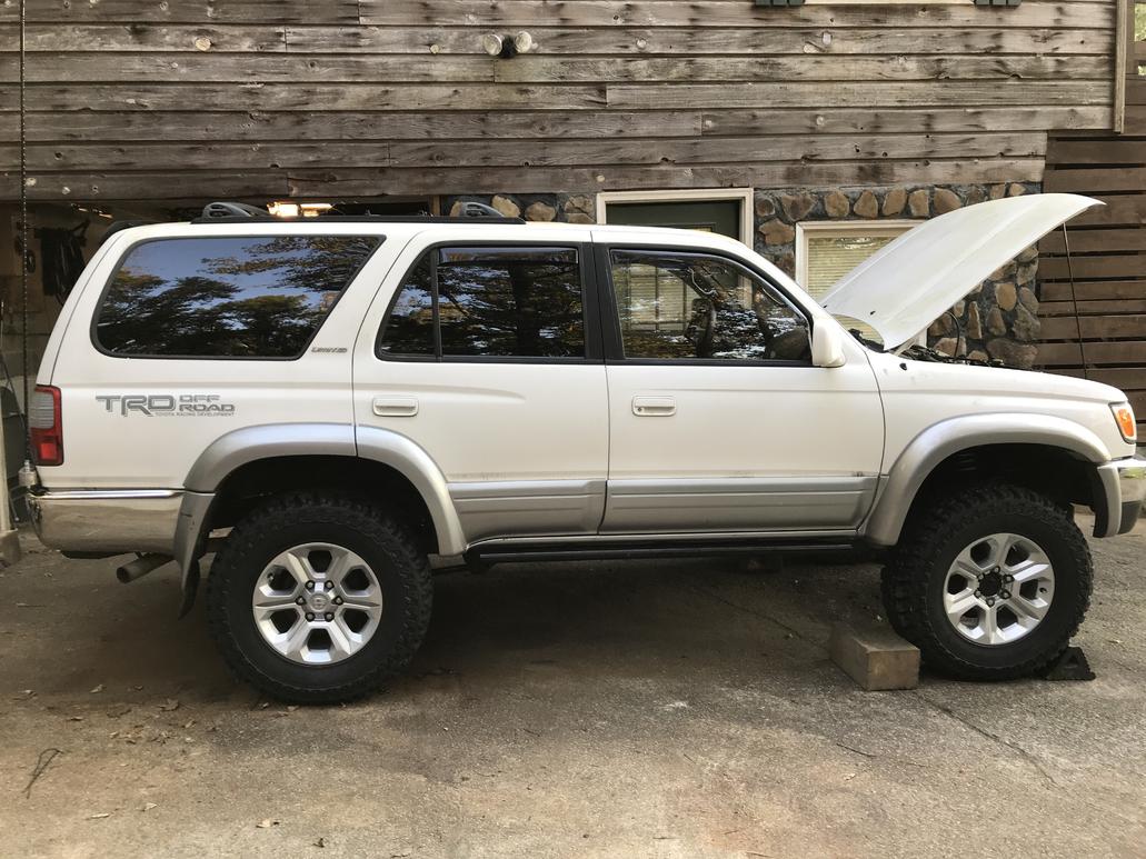

Installed the TBU. I went with 199mm instead of 231mm because I don't tow, and didn't feel like cutting the shield or having to upgrade my wheels (at least at this point).
I have to ask [MENTION=198376]4Runner4Leon[/MENTION] where they came from? Those have to be the funkiest looking slide pins I have ever seen. But hey, you should stop much better now.:bravo:
I know, those pins seem a bit too long for the calipers, but they came with the calipers, and I didn't see any downside to the extra length :noidea:. I used the A1 Cardone Ultra Premium calipers, because they are very well priced, powdercoated, and are gray instead of the Powerstop red.
For the rotors and pads, I did go with the Powerstop items, but I found a pricing fluke at Rockauto - the combined rotor/pad kit was $168, but buying the same items separately, the rotors were $93 for the pair, and the pads were $27, so $120 instead of $168 :).
Thanks for the tip, I did a complete Energy suspension body kit along with a 2" body lift when I started the SAS and rear suspension. Energy is polyurethane but the Sonoran Steel ones come up here a lot, anyone interested in the pucks and most of the hardware for a 2" body lift? 3rd Gen 4Runner??
I was able to tighten stuff up and remove it. The thing looked like it was on stilts.

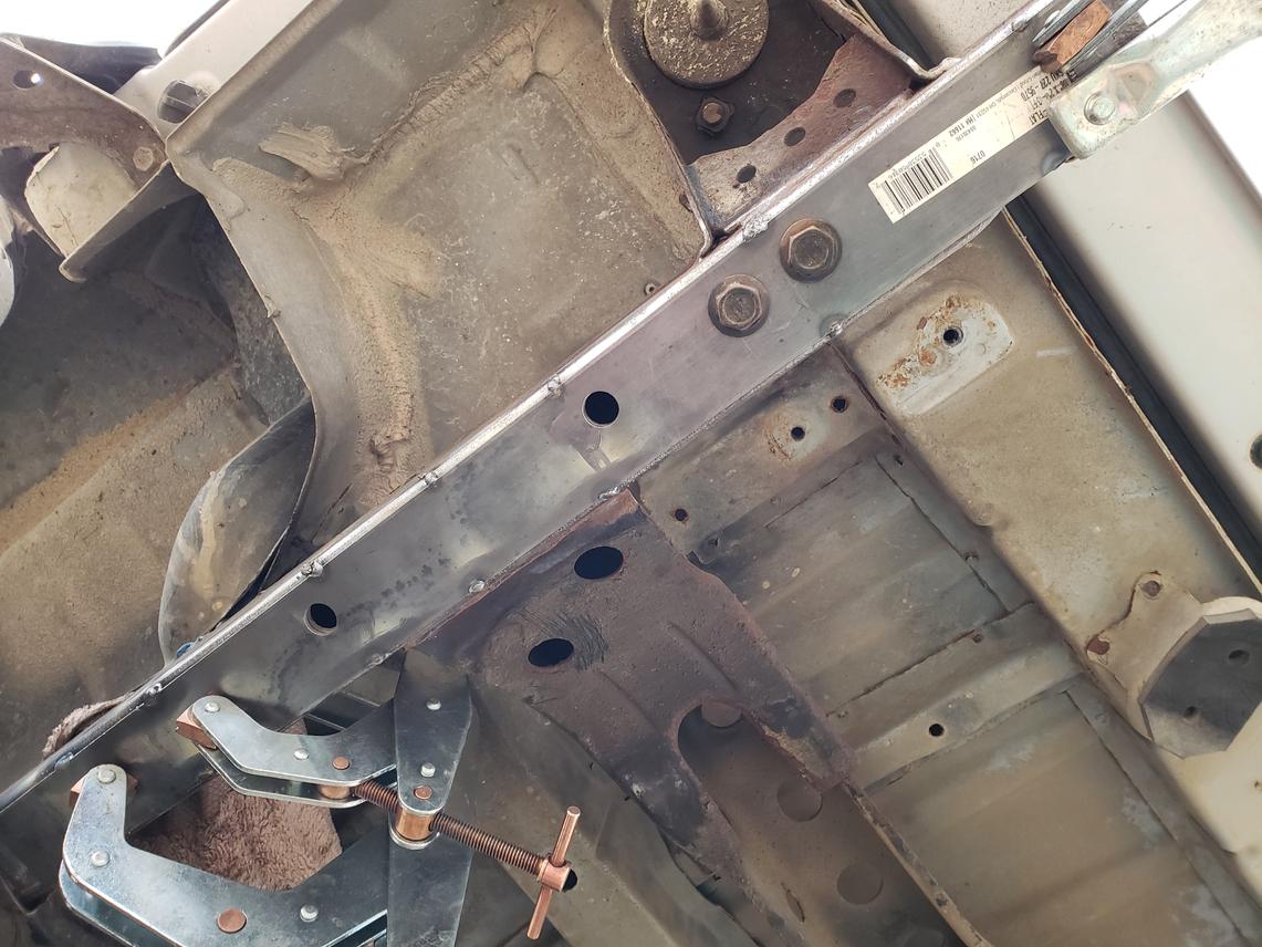

Plating the frame wouldn't be that hard but the rear frame is plenty strong without plate. I wheel my rig hard and the frame hasn't moved. Since it's fully boxed it adds a lot of strength from the factory.
