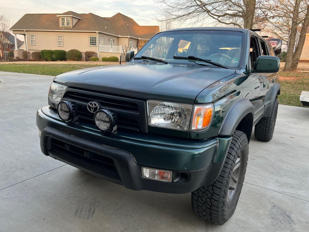

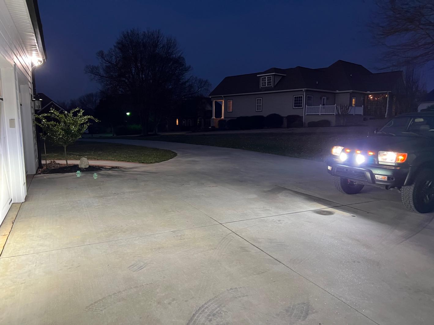

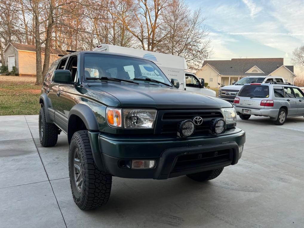

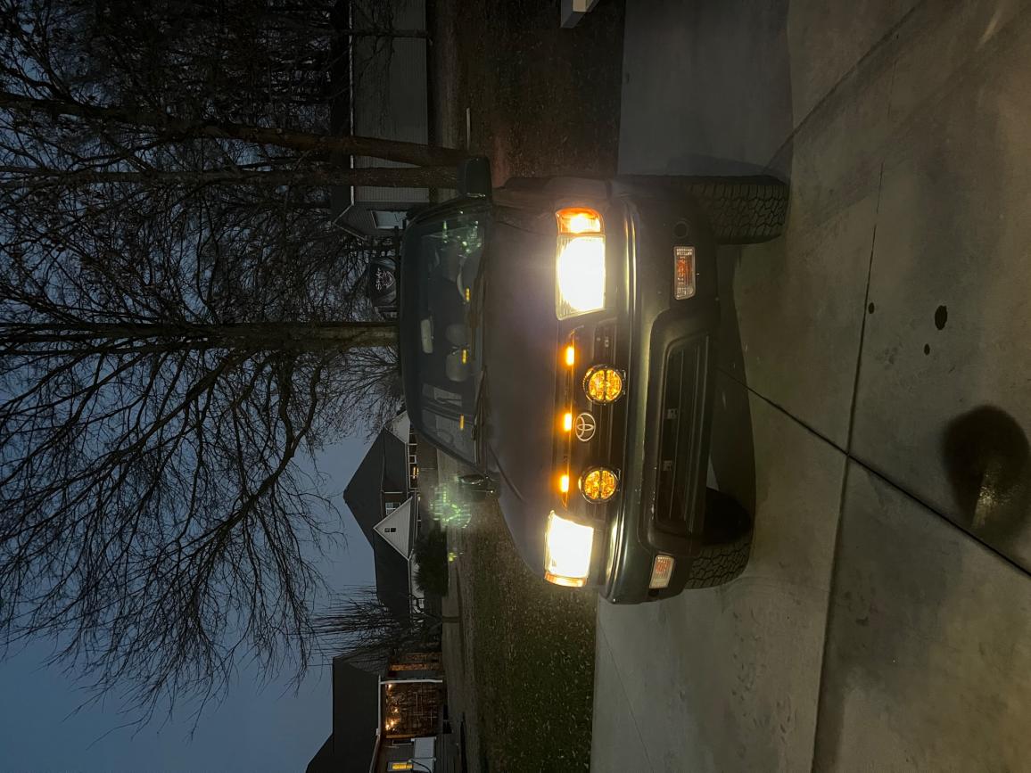

Got around to installing my Rigid 360 6 inch off-road lights. BRIGHT is an understatement. Crappy cell phone pics don't do them justice. Went on a quick night drive, absolutely insane how bright they are and they light up EVERYTHING. 10/10
