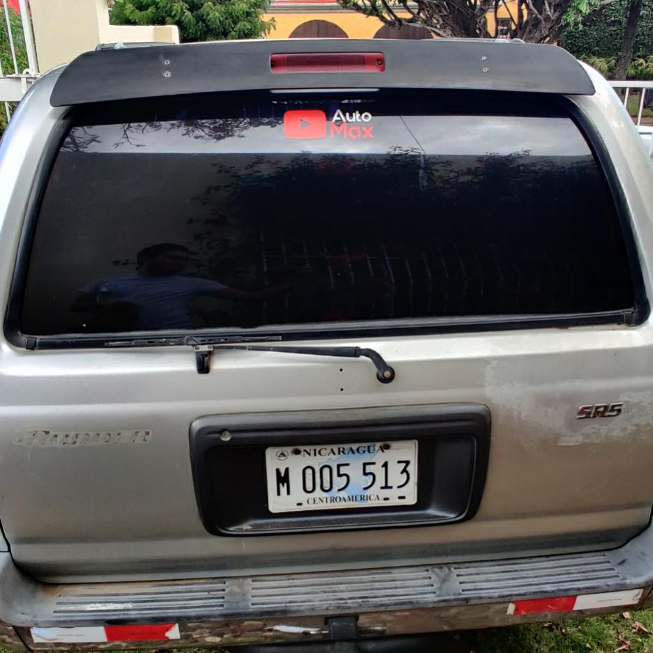

Rear Air Diffuser
Finally I got the rear air diffuser (weeks ago) installed and it was really easy, I spent a bit of time searching for some guide to install it but I didn't find anything so I took the risk and made it by myself measuring everything to avoid disaster, the centre tail light was my guide of measurement.
Yes, I'm missing some badges but a i need to paint the hole back door so once painted I will put them

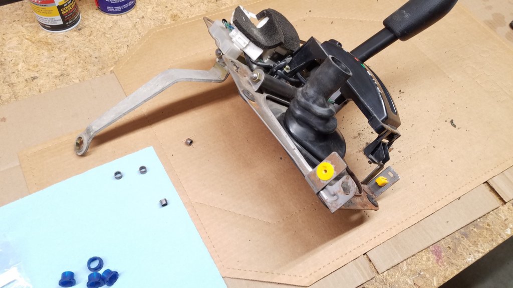

  • Front differential fluid change
  • Rear differential fluid change
  • Transfer case fluid change
  • AT shifter bushings and linkage grommets
Should have done these bushings ages ago! It's an incredible difference.
Parts used:
AT shifter bushing (90385-11003) (x4)
AT shifter washer (33544-27010) (x4) wasn't really required
AT shifter lever grommet (33572-22010)
AT shifter rod grommet (90480-17177)

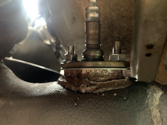

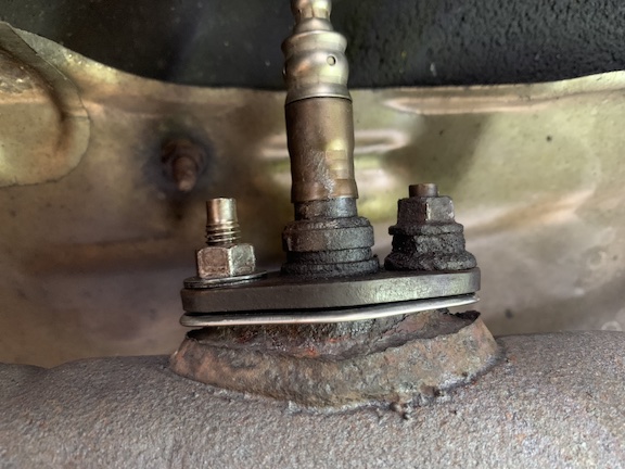

Sorted out both problematic o2 sensor's today with new Dorman gaskets. The exhaust fumes were ridiculous so I went under to find both sensors leaking. I didn't want to crank the nuts too hard as the studs were a bit rusty but it tightened up no problem. Tap and die kit & a torch were my best friends today on this job (cleaning up stud threads/chasing new threads on a non M8x1.25 nut).

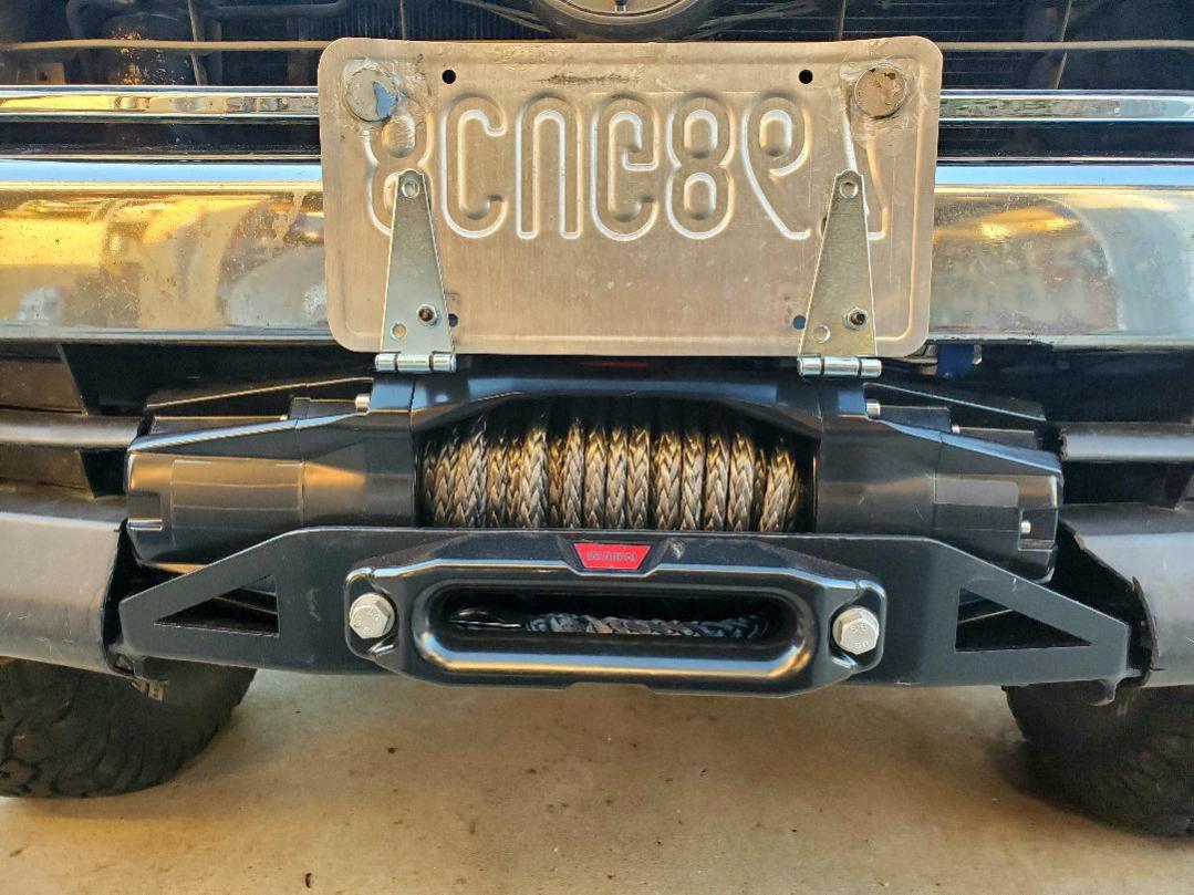

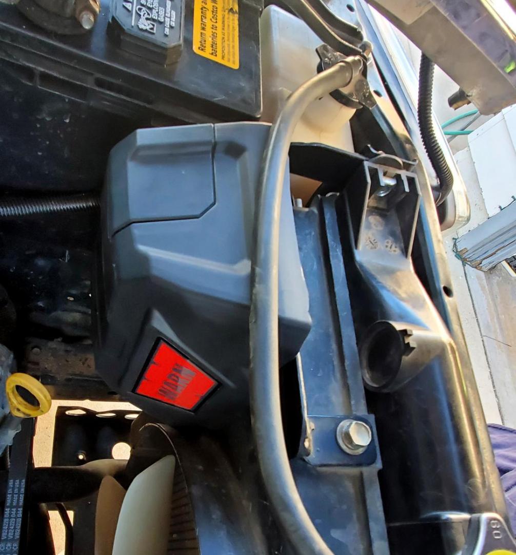

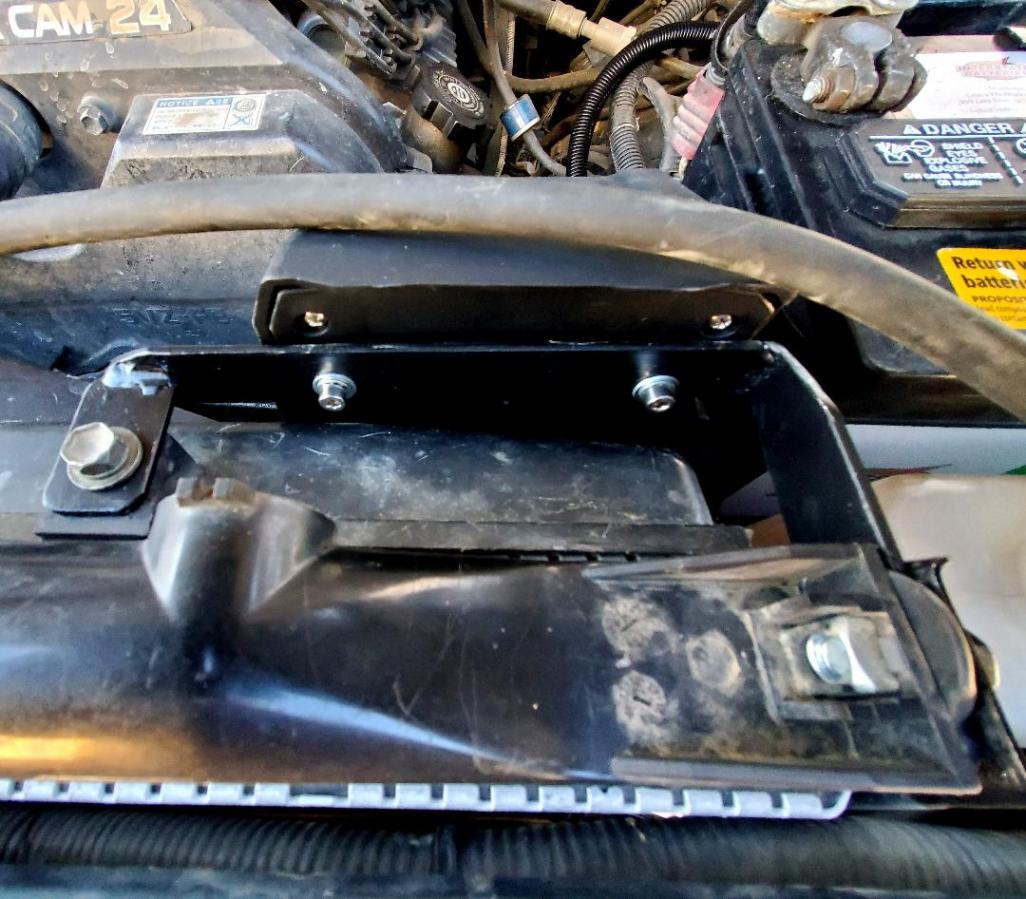

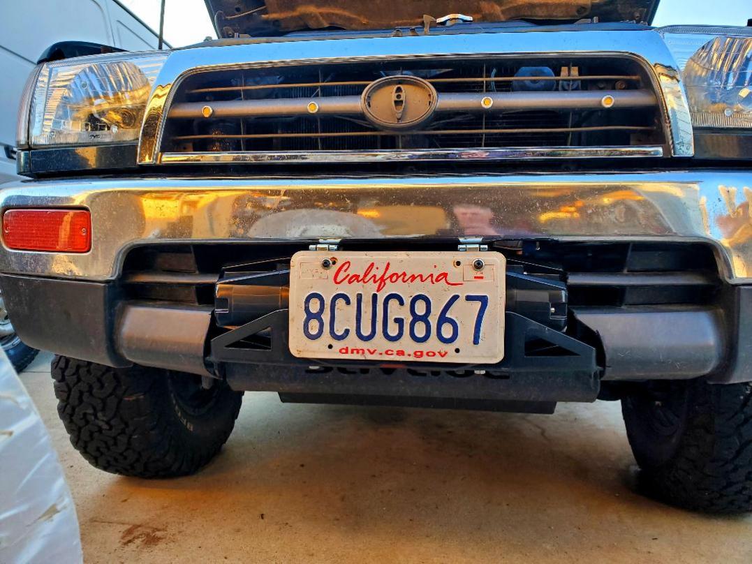

Had to order the control box relocation kit as it won't fit with the stock bumper and still had to extend the three #2 wires another 18" to reach the new location by the battery. Welded up a little bracket to use existing holes. License plate stays down with quarter size neodymium N52 magnets silicones to the back of the plate.

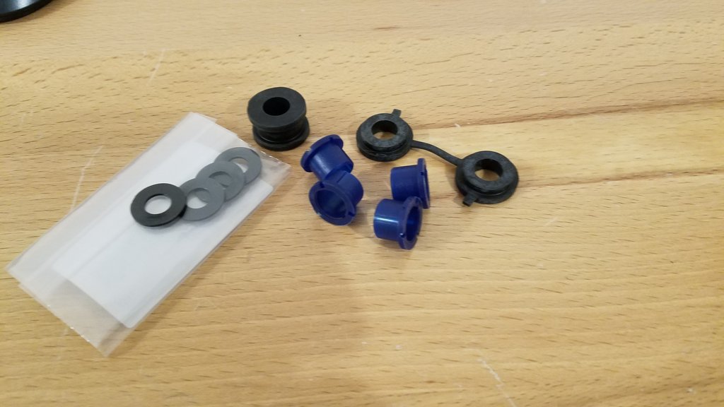

Parts used:
Mine could probably use this. How long did it take for the swap? The bushings i mean.
About 1.5 hour maybe. Spent time cleaning out the fragments of the old bushings and greasing things. Job was simpler than I expected but boring taking apart trim. 1.5 hour for the whole job I mean, with taking out the shift assembly.
