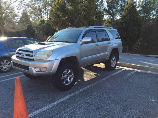

Parked behind this beauty yesterday.
Way more interest than my semi stock 4Runner.

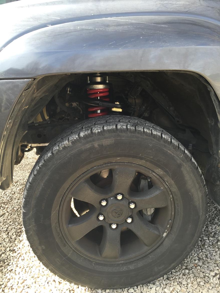

Spent 12 hours removing xreas and installing UCAs and front shocks. Things to remember:
1. I hate ball joints
2. Many things are much easier with two people
3. I hate ball joints
4. The 3 nuts on top of the shock towers are the worst.
5. XREAS removal does NOT spray oil like a fire hose causing a giant spill like I imagined it would.
6. I hate ball joints
Installing rear shocks and springs today.....yay

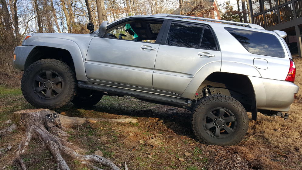

Climbed a stump today to check the flex out.
