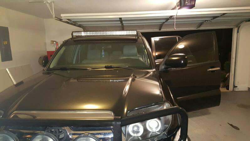

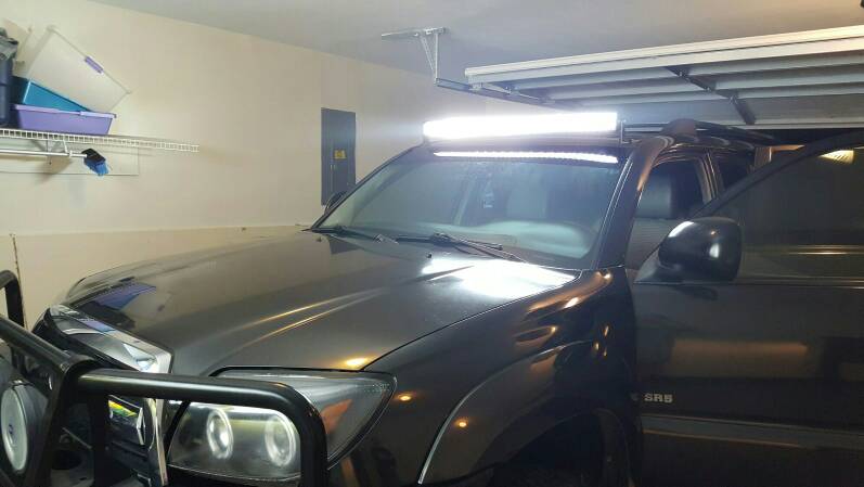

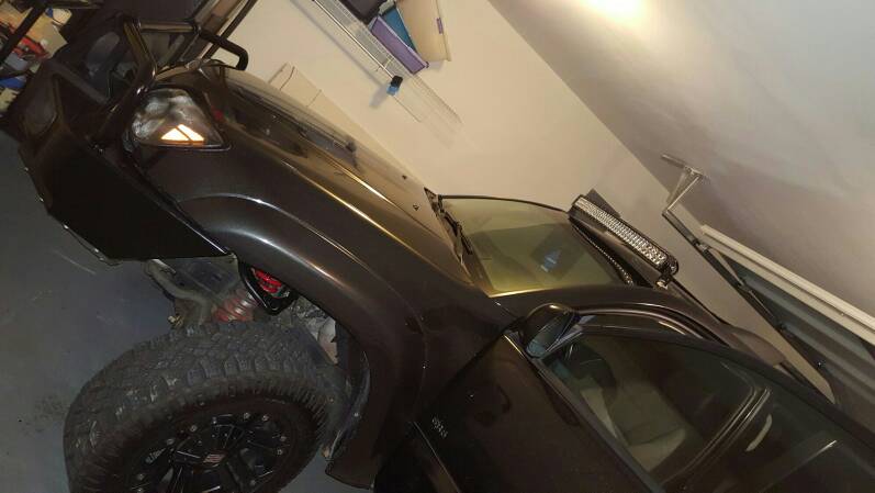

Finally got the bar up, and avoided a 225$ cost of taking it somewhere to have it professionally installed. Thanks to the help of some fire-firefighter buddies, I'd say this is none the less professional
Also tapped into the fuse box, so the switch now lights up when the keys are turned vs staying on, and vehicle doesnt have to be on for it to turn on unlike the 3 fogs.
Overall, a day very very well spent.
good work! i have always laughed at guys when they go off about something being installed by a "professional"? i can assure you, when i do things on my truck, it is done with much more care than a "professional".
and what really defines "professional"? in the oilfield, one is a professional if he has done it once!! :banana:
Couldn't agree more. With careful work and a guidance of sense, anybody can be a "professional" to me

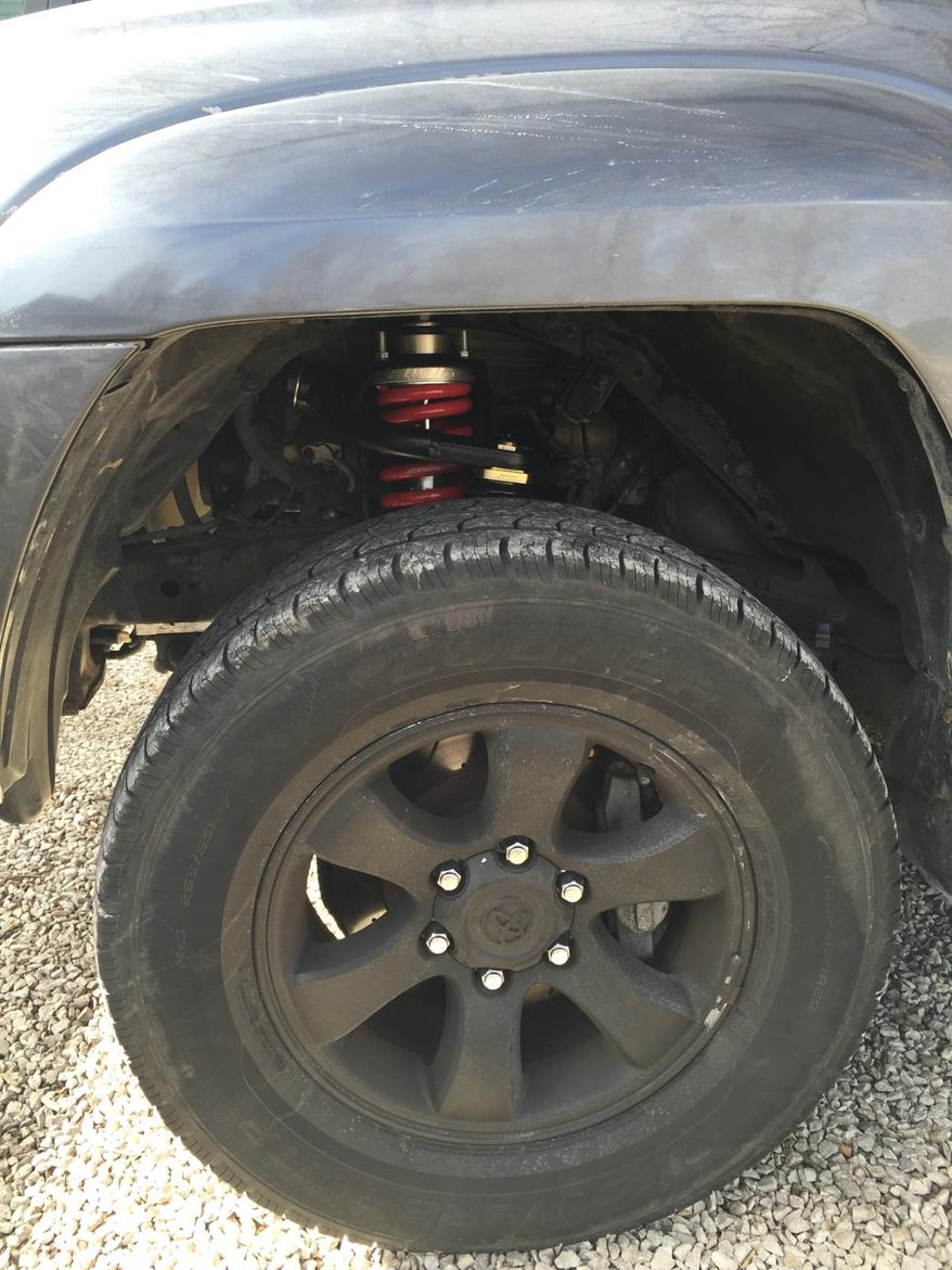

While doing so, I noticed that my lower ball joints boots on both sides were torn, upper ball joint boot on one side was torn as well. Could still see a little grease in them.
New splash guard
UCA BJ
Lower BJ
LCA Bushing
My questions are:
1. How important is replacing the boots/joints? I want to get a uniball UCA, does the uniball really need to be replaced almost yearly? or only if wheel'n?
2. Replace the boot, ball joint or the entire arm? (lower) Pretty sure that my cams are likely frozen,couldn't really see the bushings to look for wear.
3. When going over speedbumps I get a squeak/groaning sound from the front suspension. Joints the likely culprit?

My balljoints made all sorts of noise when they went bad. Got wobbly fast after the boot split.

I don't do anything crazy, or have insane lift so I plan on going with the Camburg UCAs with the standard ball joints for $599. Save some money and ball joint hassle. Maybe something for you to think about.
I was looking at those, I should prob. do new UCAs as post-lift I am sitting at only 1.5° castor. Only a 2.5" lift (low side), so it wasn't super high on my upgrade list given the expense
They looked pretty sketchy when I installed my lift a couple of months ago. Other than low castor it feels solid. Even at 1.5° castor it still tracks straight, a little bit of wandering at higher speeds but easily manageable and still feel comfortable with it.
