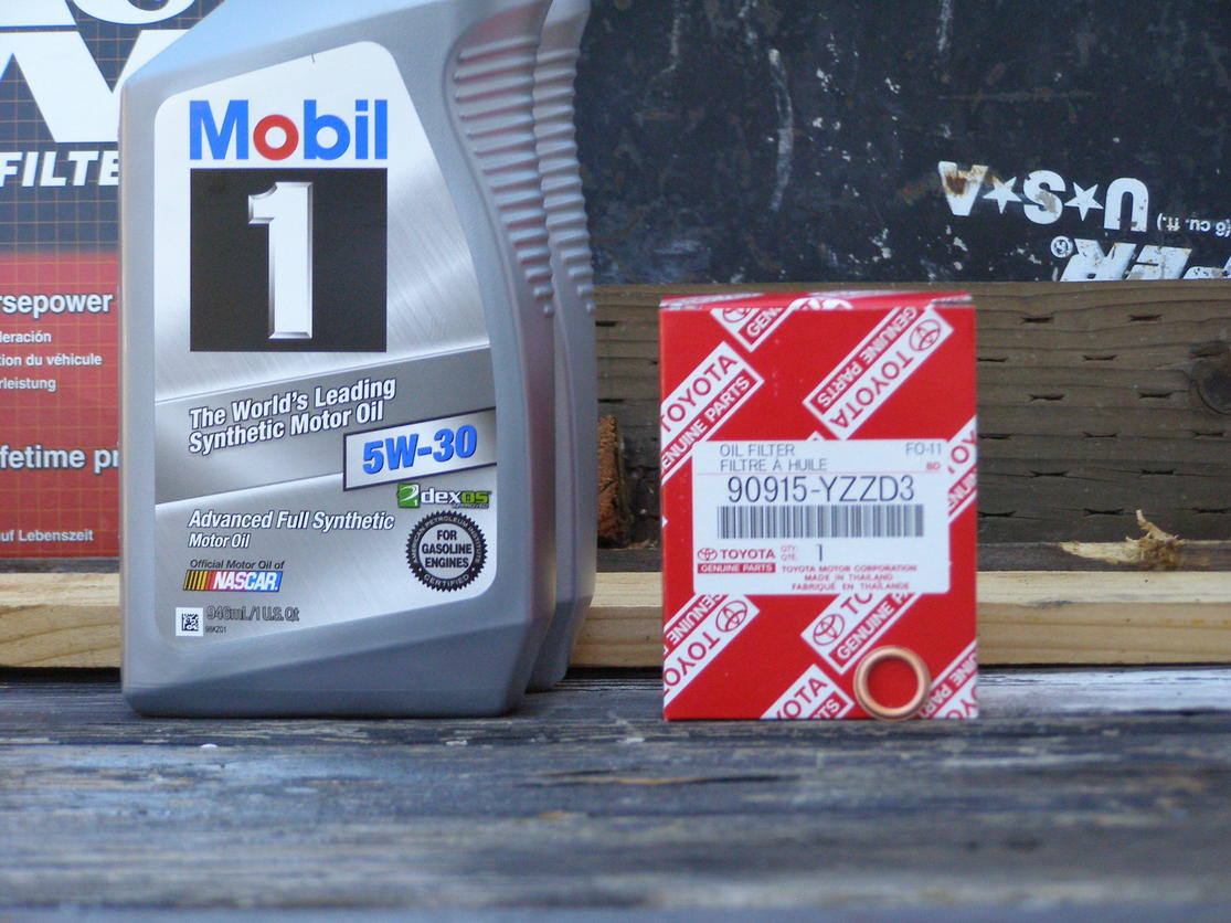

Just hitting my 90k service and decided let's go all out on this.

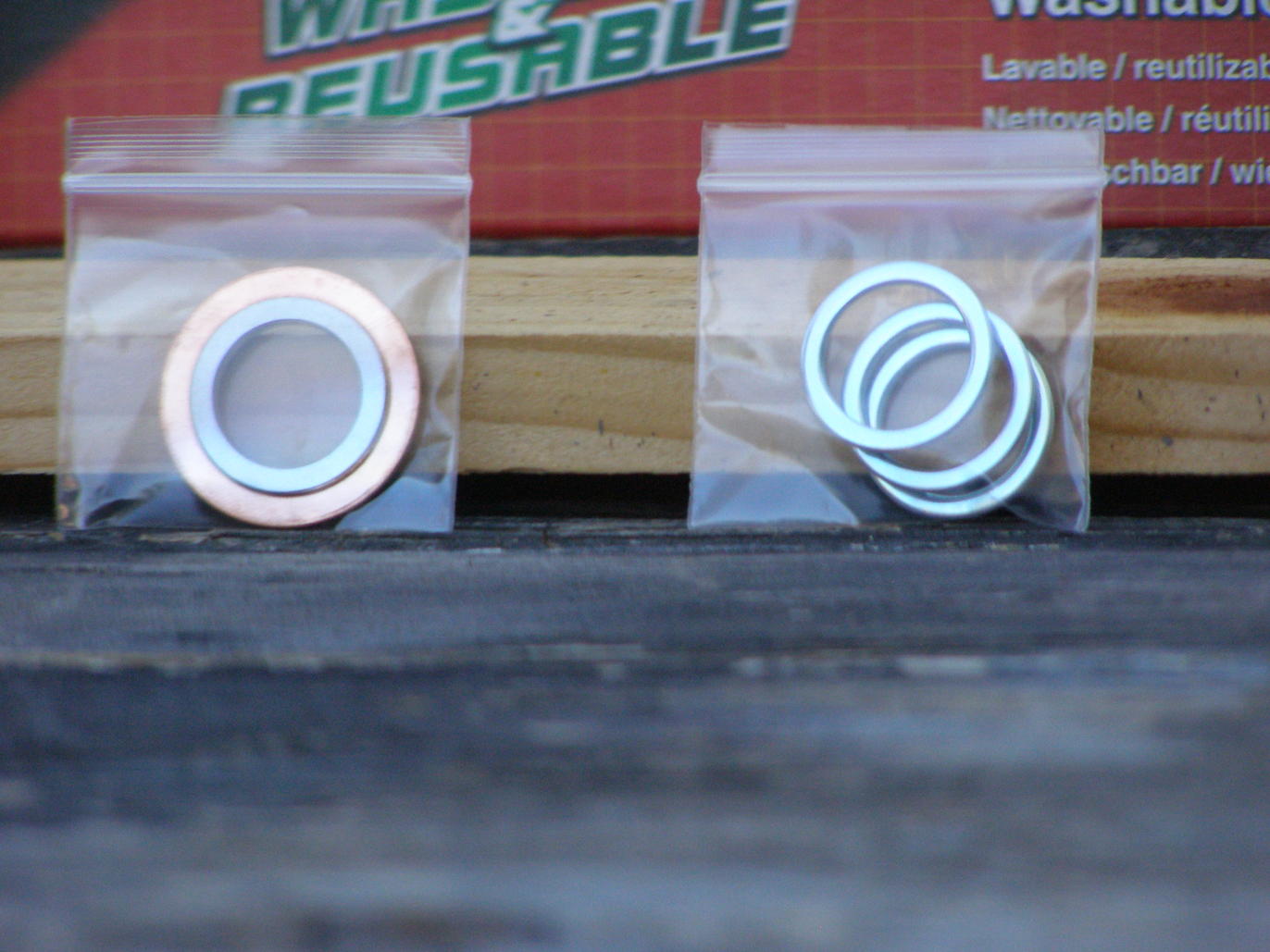

And since the changes before, never replace the seals on the plugs, figured it wouldn't hurt.

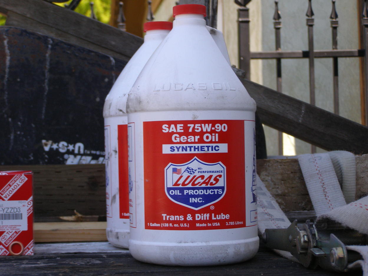

Edit- since I have the skids off, might as well take here down and do a few drain and fills done on the trans. ( Never been done yet ).
