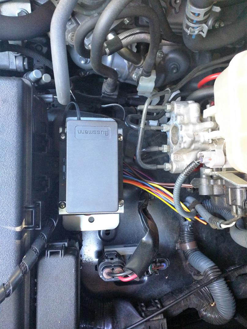

I vote the Bussman for simplicity. Here is mine sitting where it will live. All you need to do is move the doohickey with the heat-sink, which is in the picture just below the relay box. There are already holes here as well.
To simplify wiring, I am running a single run of semi-truck trailer wiring through the firewall (all of 3 feet). The trailer wire has 6 stranded wires in a nice insulated bundle. This will run to AOB switches.

What model Bussmann is that, sir?

No problem, I'm also running one and they are very well built and fit in the spot pictured above perfect. The switch wires are the perfect length to reach all the switch pop outs right under the mirror and dimmer controls too. The only thing I have installed that was too much draw for the relay was my ARB compressor, they handle all of my lighting great.
Only draw back is now that you have so many relays and fused circuits you just want to buy more stuff to run off of it.
