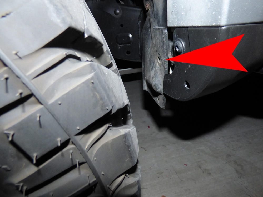

To start this is my setup 2011 sr5 with bilstein 5100 @2.5 plus toytec top plate spacer front left . Light racing uca, and stock size handcook dynapro. Also toytec front sway bar spacers.
This has happened two times to me so far on mountain roads. When making a sharp right banked turn and a little higher speed than posted ex 20 in a 15 turn , it seems like some part of the tire is hitting the fender when the suspension compresses . I never drove mountain roads with the car before it was lifted . Since the tires are stock I can't understand why or what would be rubbing when I take the turn . Any help would be great
My tires rub here on sharp turns when decelerating. Like pulling into a parking space. Your's is probably attached to the rocker panel, but I would look here for rub marks.
I have a 2" lift or so with stock size tires.
If it is only contacting intermittently under some suspension load and at full lock on the steering I wouldn't really worry about it. My right front will sometimes make slight contact at the rear at full right turn and flexed up when on a trail. But it is so light and so rare I don't worry about it.
