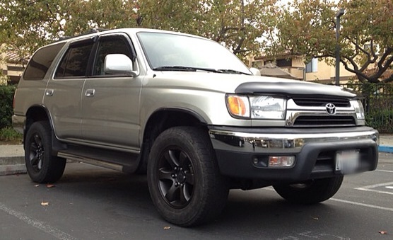

Wheel spacers what size with no fender flares? Handling?
bpowa
Guys first off will wheel spacers provide less body roll?
Also i don't have the sport fender flares and don't plan on it due to drilling holes.
What's a good side 1"?
If you have pictures please post.

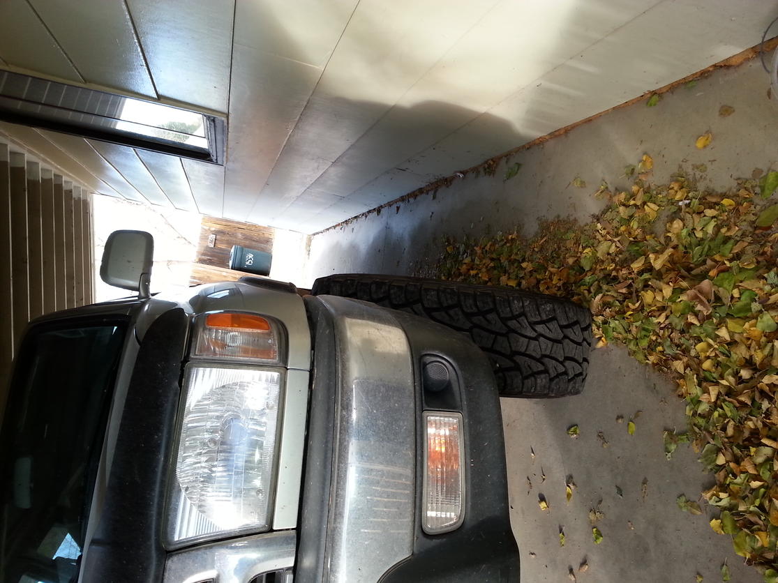

Running 1.25" spacers with undersized 285's (closer to a true 265/75r16) and no flares, the tires stick out past the fenders an inch or so with stock 6-spokes. They kick up rocks and mud at the side of the truck.

Sorry for the sideways picture

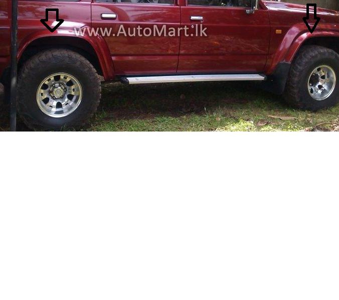

Get a rubber mat and put it like a flare (see picture). This is what I am going to do to my SR5. I found 1/4 inch gray rubber mat at Lowe's. So far no luck with black.
