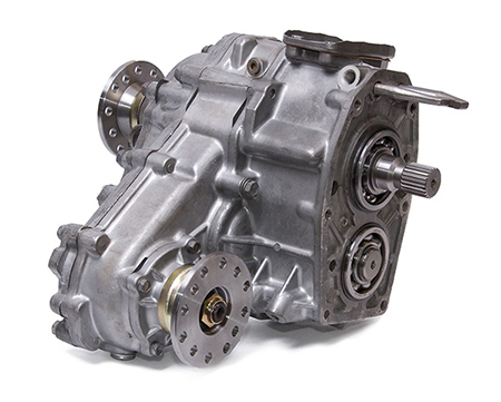

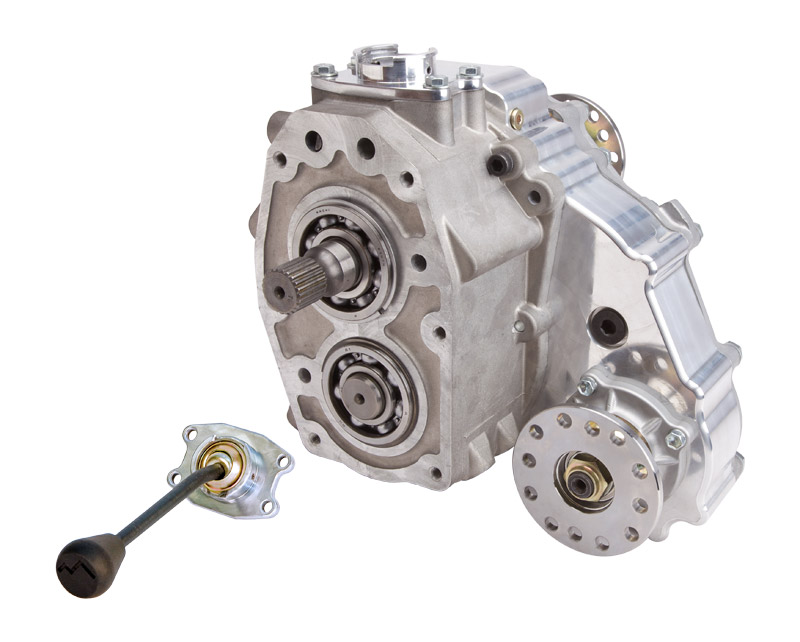

whos gonna throw one of these in their 5th gen?
Verso 2.28 x 4.70 Dual Gear-Drive Transfer Case
Dual RF1A top-shift gear-drive transfer case that features a 4.70 low range gear set built with our very own Verso™ Transfer Case Adapter. The Verso™ T-Case Adapter allows for the use of a gear-driven t-case with a left hand drop front axle. The Verso™ T-Case Adapter is machined out of aircraft-grade 6061-T6 aluminum for increased strength and durability. The Verso™ T-Case Adapter has almost a quarter inch of added material around the idler gear bearing for additional strength.
Each case is fully rebuilt and inspected. Triple drilled flanges are installed on both front and rear output. This Verso™ 2.28 x 4.70 Dual Transfer Case is built with a 23-spline input gear. Can be installed as a replacement to your stock chain driven transfer case. To go even further, we will include a Mechanical-to-Electrical Speedometer Adapter and your choice of shifters with this kit at no additional cost! The shifters will be provided uninstalled. Available with an adapter for 3.0L, Tacoma 2.7L, 3.4L, and 4.0L applications (transmission adapters are provided uninstalled).

So... what all does this do?

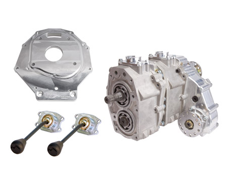

So does this change the options from 2Hi, 4Hi and 4Lo to 4Lo and 4xlo?
Be prepared to cut holes in your floor for the shifters and a lot of lights lit up on the dash. This will not play well with all the electronics on our 4runners. This is more for custom rock crawlers and hard core off roaders.
No, it changes your options to 2High, 4High, 2Low, 4Low, 4ReallyLow, and 4StupidLow. Get a triple stick and you can have 2ReallyLow and 2StupidLow too.
From looking at the pic, what this does is replaces the reduction section of your transfer case with two reduction sections from the early RF1A transfer case (one of which has 4.7 gears in it). You'd get an adapter that goes between your transmission and the first RF1A case, then you'd have the two RF1A cases (with a standard dual tcase adapter between them), and then another adapter to go between the second RF1A case and the back half of your stock transfer case. That's a lot of adapters - that thing is really really long.
Going to be more than 400$ in adapters. 400$ is just the adpter to adapt a gear drive tcase to a V6.
What this is going to do is flip the output of the gear drive tcase out to the front axle onto the driver side. So you would need the transmission adapter, plus the verso. At least that's how I see it.
Notice the original case drops out on the "right" if you were looking from the driver seat, and the case with the verso adapter drops from the "left" if you were looking from the driver seat.
Then you would need the 4.7 gears. And a dual adapter if you wanted duals. Unless you bought the already built kit. Verso is also already clocked.
Drive shafts need to be modified. The extent of the cutting of the floor is the unknown...as you would be the guinea pig. :juggle: I don't see many if any doing duals on a 5th gen 4runner. You'd end up cutting too much of the floor and probably have shifters coming up through the seat..
As for the electronics, you'd still have your stock axles and sensors. So maybe atrac and vsc could still work. Depending on how much they rely on the original tcase. But that might be simple enough to trick by supplying a voltage or something. Must see what was the electronic issues on the Tacoma they tested with.
