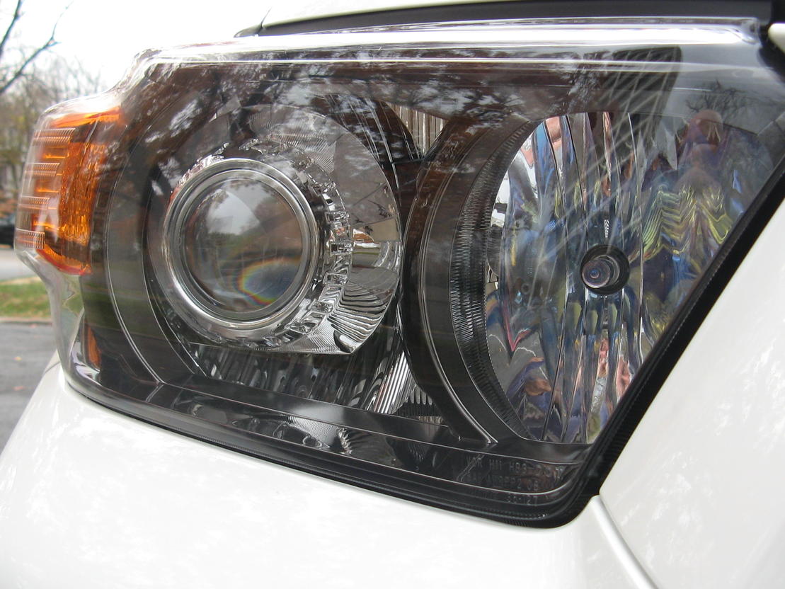

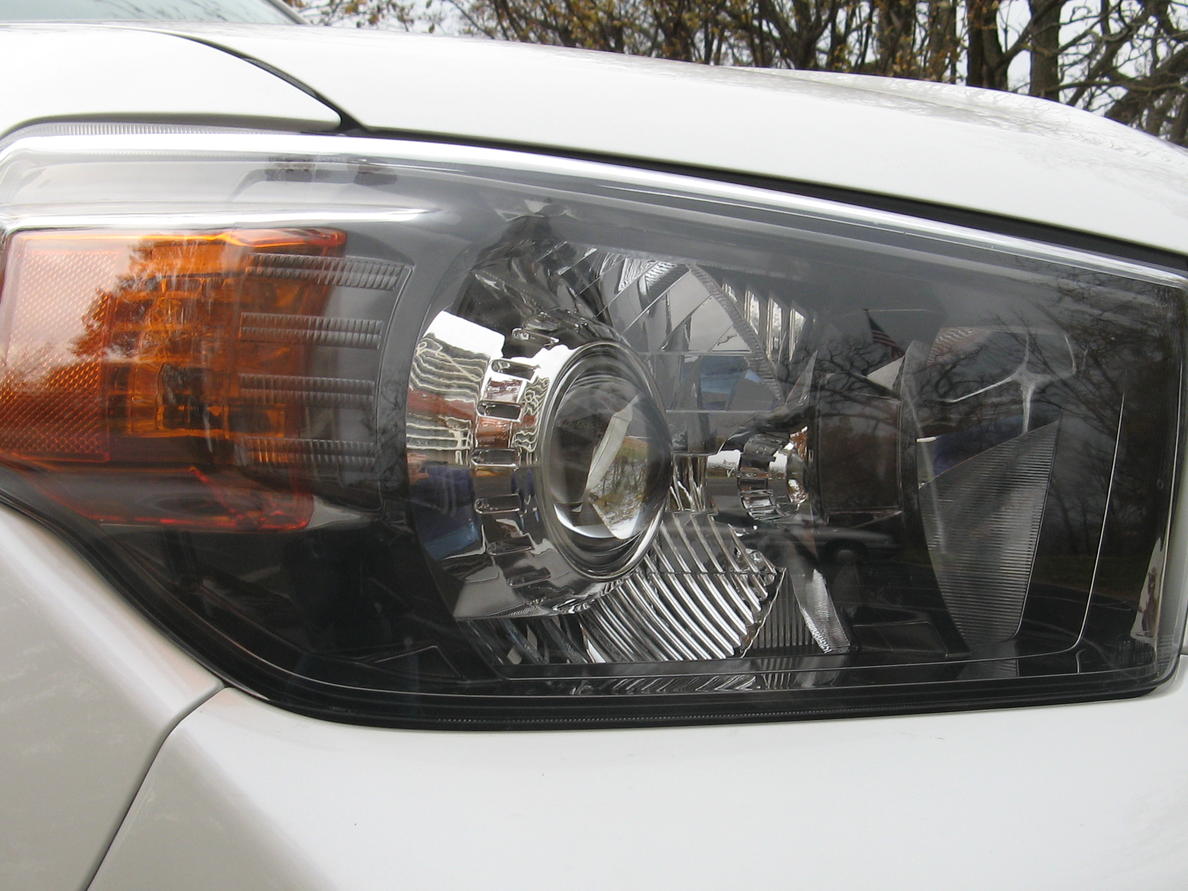

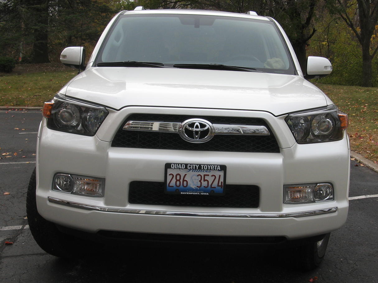

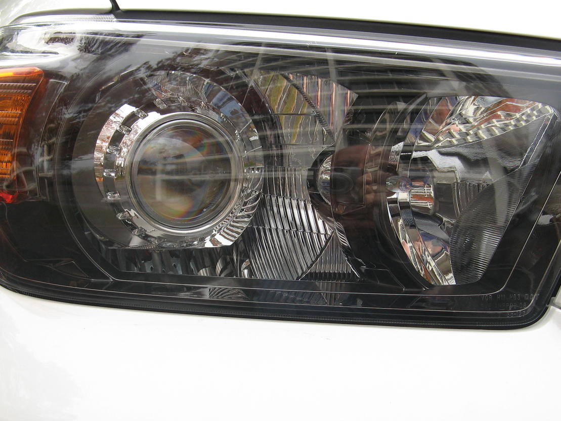

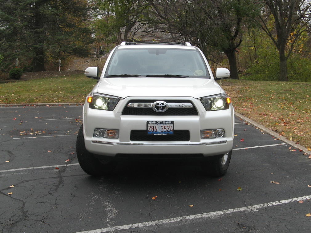

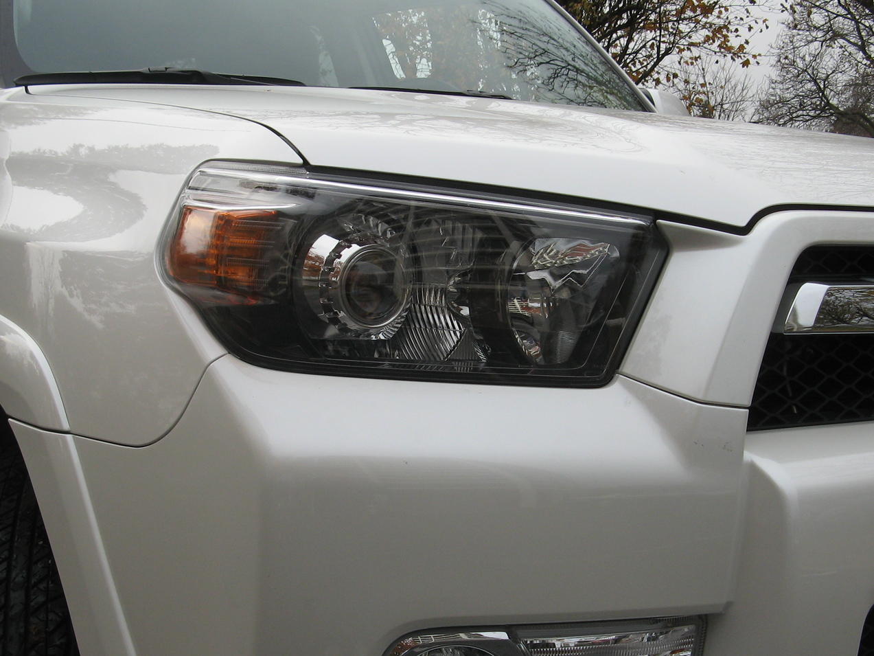

How did you configure the bi-xenon and the high beam reflector?
Can you use your high beam reflector also or just the bi-xenon projector?
So now, to unwad toystry's panties, I spent within lunch money of $1K. This could have been for a few hundred less depending on components, but I went top shelf, with Bi-Xenons and Philips bulbs.
They look good by the way.......compliments the BP nicely.
Oh, and panties unwadded :thumb3:
Looks really good. Can't wait to see the night shots. What temperature is that?
4300K. I studied up on this, and 4300 is the nearest to natural light, plus it yields the most lumens. win-win imo.
Both the projector and reflector high beams are wired to come on together. Lightwerkz left a very nice pigtail with crimp connectors hanging out of the bi-x's, so it was fairly easy. I'll detail it in my write-up. I have upgraded halogens in my reflector HB's which are pretty white, so the two HB's together look pretty good. I have kick-ass high beams now. I am very happy with my choice of a bi-xenon projector.
You could install it either way.

Last night's driving impressions
Holy Crap! These things rock!
The sharp cutoff takes a little getting used to. What impresses me is the beautiful white (not bright or glaring) light. 4300K is the right choice imo.... and the extra $ for Philips bulbs does not seem wasted.
Next is the wide beam spread. Just as a WAG, I'd say the useful lighted area in front of the truck has doubled. And it's a low, spread-out beam not unlike a fog light. The hot spots are at the cutoff but aimed away from oncoming traffic, toward the center of my lane.
I had expected to have to align them, but it doesn't look necessary.
It was raining last night, and my vision was nicely improved over halogen lights.
The high beams are great.
If I HAD to do this over for half-again more cost, I'd do it in a heartbeat.
