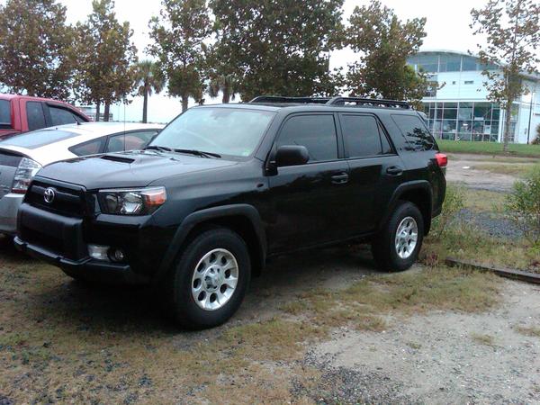

Tint over the rears, removed the port installed tint on the fronts and re-tinted.

Mine actually had 45% digifilm on the front that was installed at the port. I had him remove it instead of tiniting over it. The rears are factory tint in the glass which can't be removed. My tinter told me that untinted glass actually cuts some light transmission by the nature of it. He said that if you tint over glass you can almost always subtract 7 from the tint percentage to get your actual light transmission level. As far as the yellow, I'm not seeing that at all on mine. Because of the factory smoke on the rear windows, it's almost impossible to get an exact match front to rear.

I actually do window tint at a shop over the summer months (teacher rest of the year). The back windows are 22% when measured. However, the tint is incorporated into the window glass compared to being on top of the glass. That is why if you get a standard 20% on the front windows it will look darker then the back. I would rather go to someone that makes good cuts then laser cut because unless you are heating it up it will stretch and wrinkle over time. Just my 2 cents!

I went ahead with tint over the rears purely for the UV and heat blocking. As far as I know the factory smoke tint provides neither, it's purely for privacy/asthetics. The digifilm that toyota put on works fine, I had it all around on my Tacoma with no problems. I had him take it off the runner because it wasn't dark enough for me and the Madico tint I had put on keeps much more heat out. The Digifilm UV blocking is also questionable. Hope that helps.
I did the same for me in Las Vegas, the stock tint is purely for privacy and not for keeping out some of the heat.
