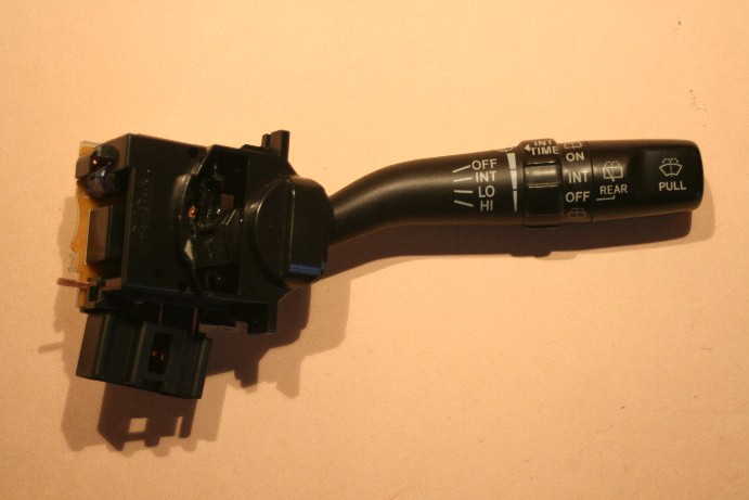

Took some pics of the switch in case you were wondering what you are looking to work with.
Front of the switch:

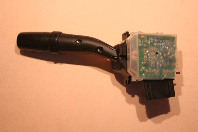

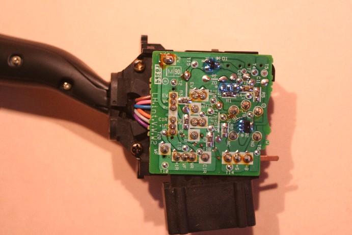

Closeup of the circuit board under the cover. Not sure how to dismantle it to get at the other side of the board so I didn't try.
Some of the components are visible on the bottom picture as surface mount resistors.
It looks like it's secured to the switch with solder posts. It will require a solder sucker to desolder the pins. Thanks for those pictures! Now we know what we are dealing with. It doesn't look hard to work on but you kind of have to wonder if you remove the board are springs going to shoot past your ear. :D
