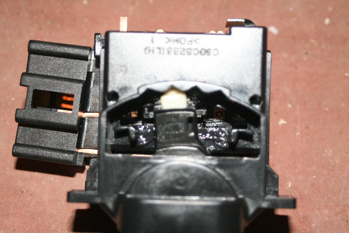

This picture is to point out, in this view of the switch, the orientation of the slide block mechanism that is activated by moving the stalk/lever. Look below the white pointer. This block will freely fall out when you open the switch body.

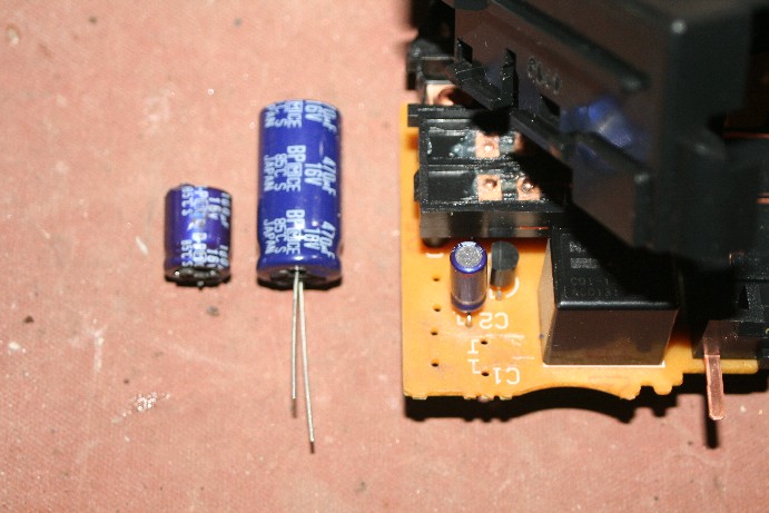

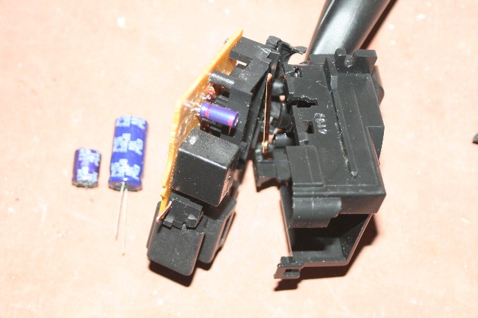

Here is a pic of the empty space after desoldering and removing the original cap (loose on the left to compare in size to the new.)
Desoldering seems intimidating at first but turns out to be relatively easy, especially with the right "sucker" tool.
Another view with the cap removed (pulled the leads right out of the cap in the process of removing it.) Watch out not to damage the small cap when inserting the large cap because it will get bent and moved over.

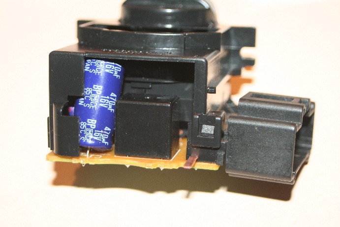

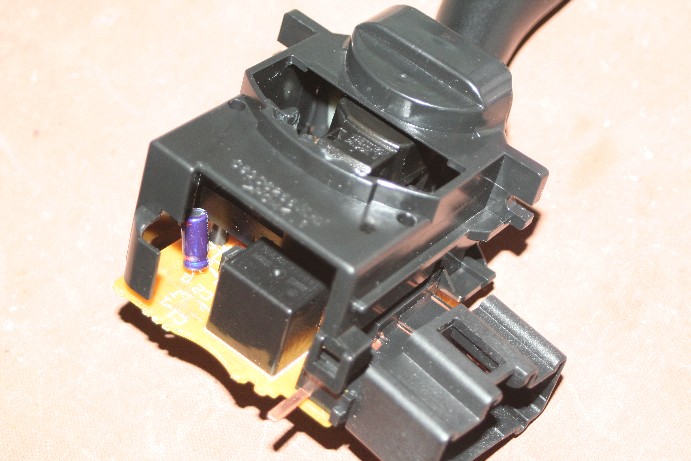

Insert the cap by pushing the leads through the holes in the circuit board. Then stuff the cap into place (you have to gently force it between the switch cover and the existing relay box.) Now close the switch halves together and tighten the screws. Push the cap into the switch so the body doesn't stick out. (This pic is after the soldering but you get the idea.)

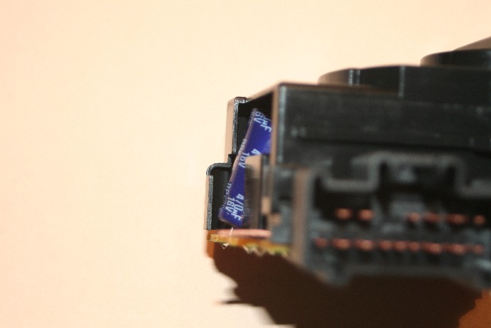

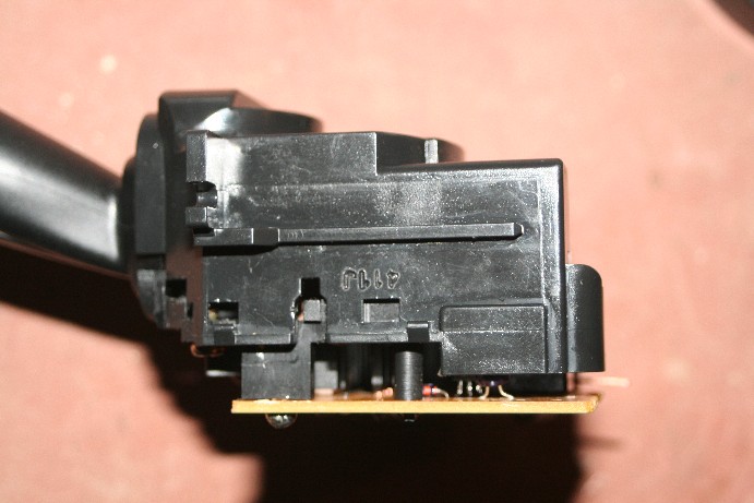

Another view. You don't want the cap body outward because it will interfere with the final switch position in the steering column.

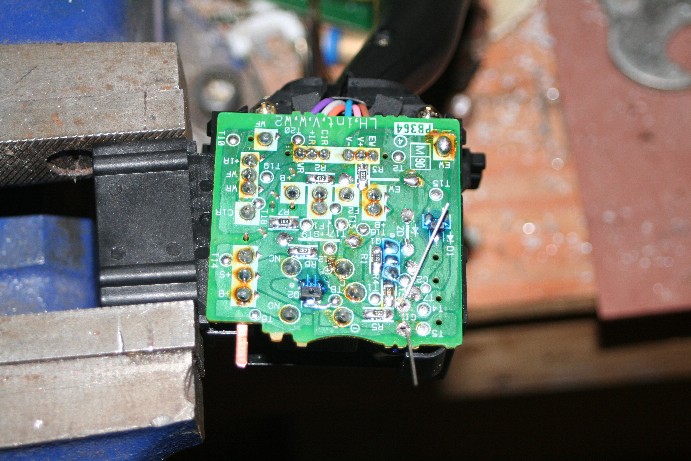

Held the switch in a vice to solder the leads. Don't trim them.
Try the switch in the vehicle in the temporary position by only hooking up the wiring connector. Don't insert it into the steering column. Turn it on and try it out. This is to see if it works and that you didn't screw anything else up with the soldering. (This is also the point you will notice the "extra" mystery feature I'll reveal at the end of the write-up.) Also, be careful not to touch the circuit board when the switch is live.

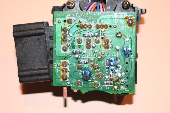

Remove the switch and trim the leads. Not a pretty job on the first one (burnt) but it works.
Reassemble the protective cover over the circuit board, put it back in it's home on the vehicle and finally put the steering trim back together.

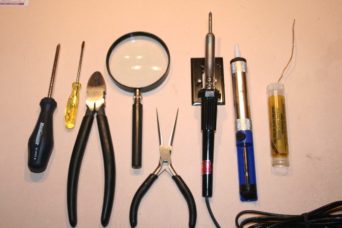

Finally, the many tools required, especially the "solder sucker" and the magnifying glass (the "progressive lenses" aren't enough in this case.)
