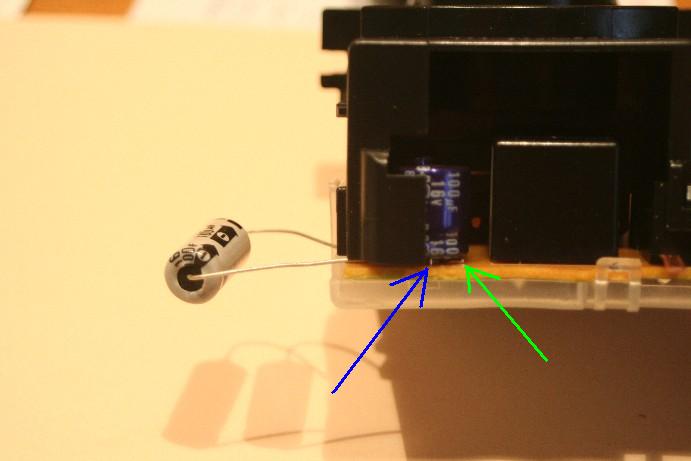

How are you temporarily connecting them? Any pics?
If the cap you are testing with is getting warm don't continue as it could pop and shower you with hot acidic electrolyte.
Luckily, the existing cap is at the corner of the board. There is a plastic "stand-off" between the two wire leads on the face of the board and the face of the cap. I was able to push the temporary cap's wires between the plastic and the wire lead (blue arrow.) The green arrow shows the end of the temp wire coming out from under the cap on the face of the board.
You can't reinstall the switch package into the holder on the steering column with this extra cap hanging out. But you can still hook up the electrical connector to use it and test it.

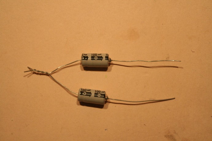

I don't have 2 identical 200 or 220. How about if I put 2 - 100's together like this and try that in the temp position? Why are you doubling up on the value (400) to get a 200 result (did I ask that right?) I know The Source has 440's but they are 50V.
I would like to do this clean so I will need time to find a 200 BP.
Kmvreter said:
Now, there will be none of that!!!
Yes you asked it right. The reason is that if you hook 2 200uf caps together in series you get half the total in capacitance or 100uf. Any how it looks as though the point has been proven. That 14.9 seconds, was it, ought to be long enough for anyone. Good job! Yea team! Or is it too early to celebrate?

Experimented with the temp 2x100 bipolar cap I rigged up in the earlier pic. Can you confirm the theory that I was hoping to see a 50% improvement in time? The 100's act against each other resulting in 50uF plus the existing 100uF = 150?
The actual result was 123% (10.8 vs 8.75) on the slow setting; 117% (3.52 vs 3.0) on the fast setting. What gives?
I then rigged up 2 more 100's (25V) in series with the original temp 100. So now I had 100 (-) to (+)100 times 2 joined (+) to (+). I was hoping to get another 100 bipolar out of this to give me a total of 200 on board (100 permanent; 100 temporary.) In fact, adding the other 100's did squat, same times as before. Again, what gives?

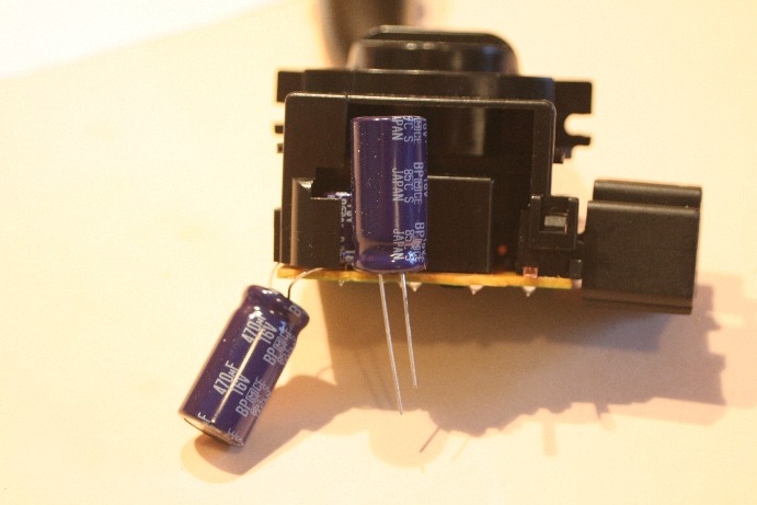

I took these times with the new caps temporarily installed in parrellel with the existing cap. The actual values will be lower when the existing cap is removed. I was disappointed with the 470uF time. I thought the time differential would be much more because the cap size is so much bigger.
There is another factor in play; the cap size. The pic below shows how i hooked up the temp 470 (on lower left.) Then the loose 470 (on the right) shows how it barely fits in height compared to the switch package. The 470 would also have to be placed on an angle in the final position in order to fit into the corner of the switch holder. I didn't include the 330 in the pic but it is a midsize.
Bottom line...
I'm going to solder in the 470 and see what happens.
