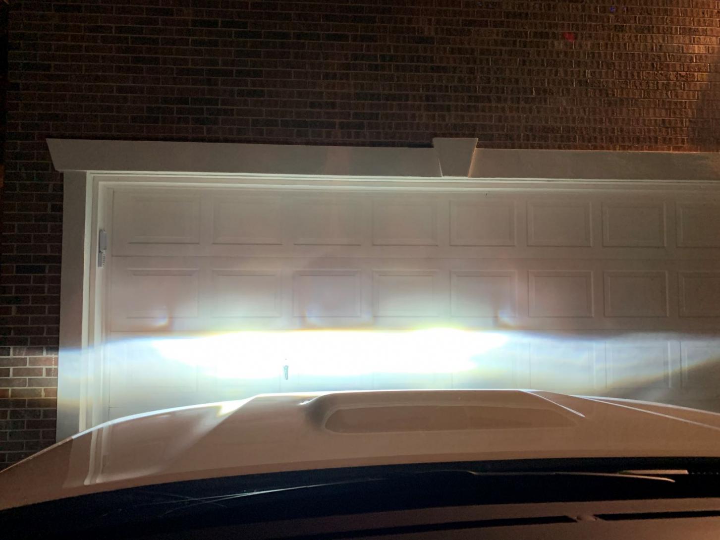

XenonDepot HID vs LED, initial photo. (Pics reposted)

Bought and installed an 4,300k HID kit including the capacitor, for the low beam headlight from xenonpro.com. My fairly thorough review of the subject indicates 4300k is the choice that produces the best, most usable light. Technically, for reasons you can research, the higher frequency 5k and 6k may appear brighter to you, but actually produce less light and cause more glare issues for those on the receiving side of the lights.
I have a 17 limited which I just bought. My wife kept asking if the standard lights were on because they seemed so wimpy. The HID’s are awesome, similar to the photos above.
Not sure how close price and quality equate with these things, but mine were half price sale and I am blown away by the improvement. Had some install issues and got great and helpful customer service from knowledgeable folks.
Got my kit installed over the weekend. Actual time putting it together was maybe 10-15 mins, but took another 45+ to get everything tucked away cleanly. So far really happy with the improvement over stock, but as others have pointed out, there is a bit of green hue at the cut off line. Maybe should've went with the Philips 4300k bulbs but wanted the lower cost entry to see how it performed. (I can always try other bulbs.)
