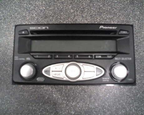

Here is t T1806, which Scion calls the premium radio, over the T1807, which is the only difference that I see is the color changing back light.

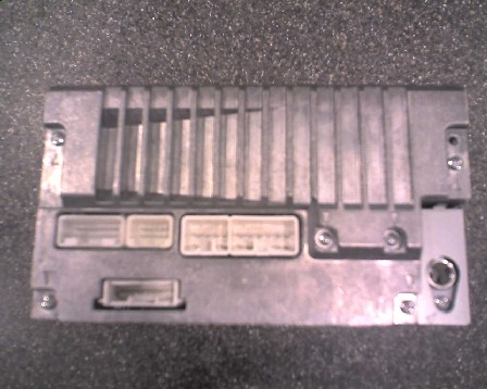

Here is the rear of the radio, where you see the additonal plug at the bottom for the ipod harness, that Toyota doesn't sell by it's self.

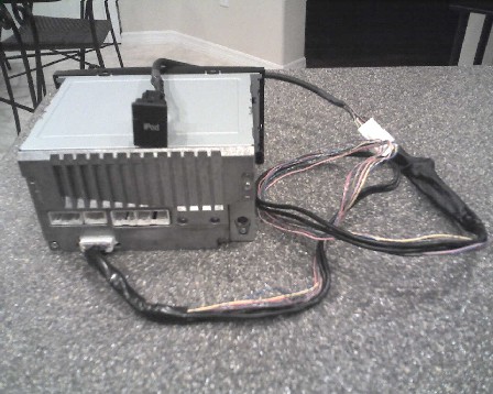

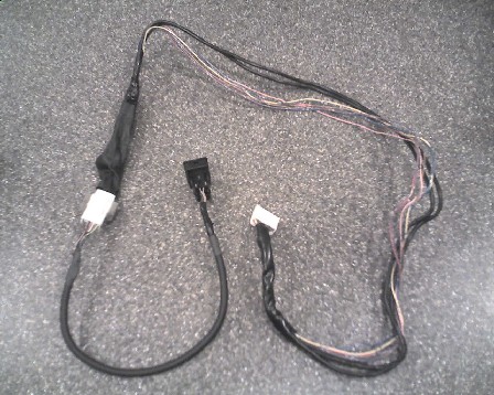

Here is the wiring harness that goes form the back of the radio to the center console, where the ipod would plug into.

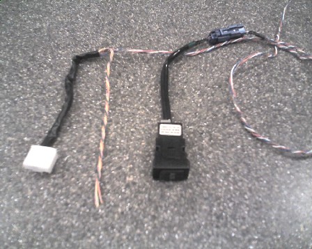

The wire that goes from the radio to the center console is actually in two parts.

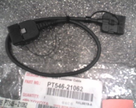

Then you need this cable to go from the iPod to the center console port. So yes you do need 3 cables, but this one they sell at Toyota. Part number attached.

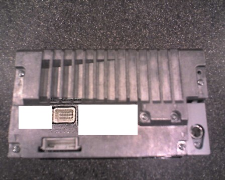

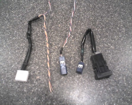

Now comes the AUX port.
Contrary to popular belief, this does not plug into the IPOD plug in the back of the radio, but instead the already exsisting power plug in the back of the radio.
The AUX plug connects right into the radio, in this standard plug.

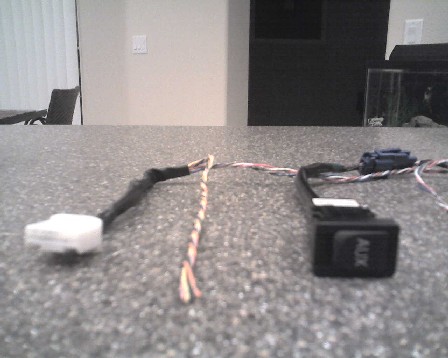

Now, if I use this AUX plug in place of the plug that is already wired in to the car, I would have to splice this new cable over the one that my runner already has. (i think, I'm pretty sure)
Hope this helps, if you'd like I will post pics after the install, to confirm that SAT, AUX, and IPOD all work.

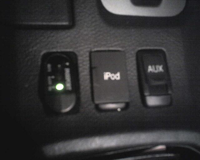

Did you also get the AUX? Great Job!
Unfortunately, the AUX was busted, but on my current '06 Scion radio I have an AUX connected, so I was going to try and reuse it.
Great idea having the Ipod hookup come up through the center console like that. I'm going to try and duplicate it.

Yup, that's my radio.
Got it yesterday and here is what it came with (pics up shortly):
The T1806 radio
The ipod customer cable P/N PT546-21062
The vehicle cable P/N PT546-21061
Really short cables so I'm going to have to be crafty on where I mount the ipod. I recommend buying from this ebay seller, it was prompt and nicely priced.
