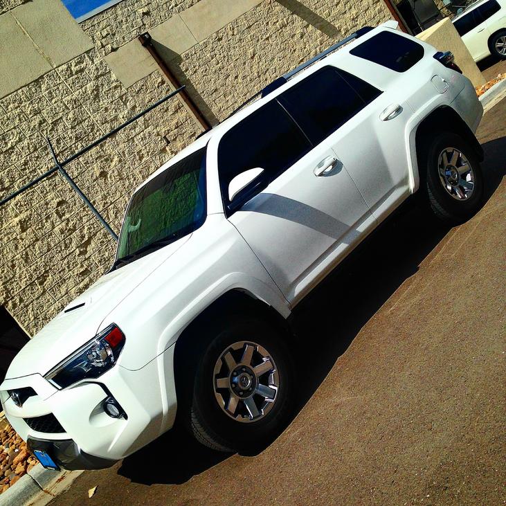

Hi I am looking to get a little extra power out of my runner
I have a 2014 Trail edition with kdss
I was thinking of doing a Cold air intake and maybe a chip if i could find a good one.
Does anyone have a link for something that you recommend.
'Hi I am looking to get a little extra power out of my runner... I was thinking of doing a Cold air intake and maybe a chip if i could find a good one.'

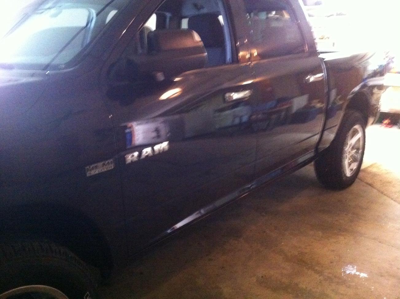

Instant HP and torque increase. Not cheap...
Don't hate. Still have the 4runner.
This is what I did:
