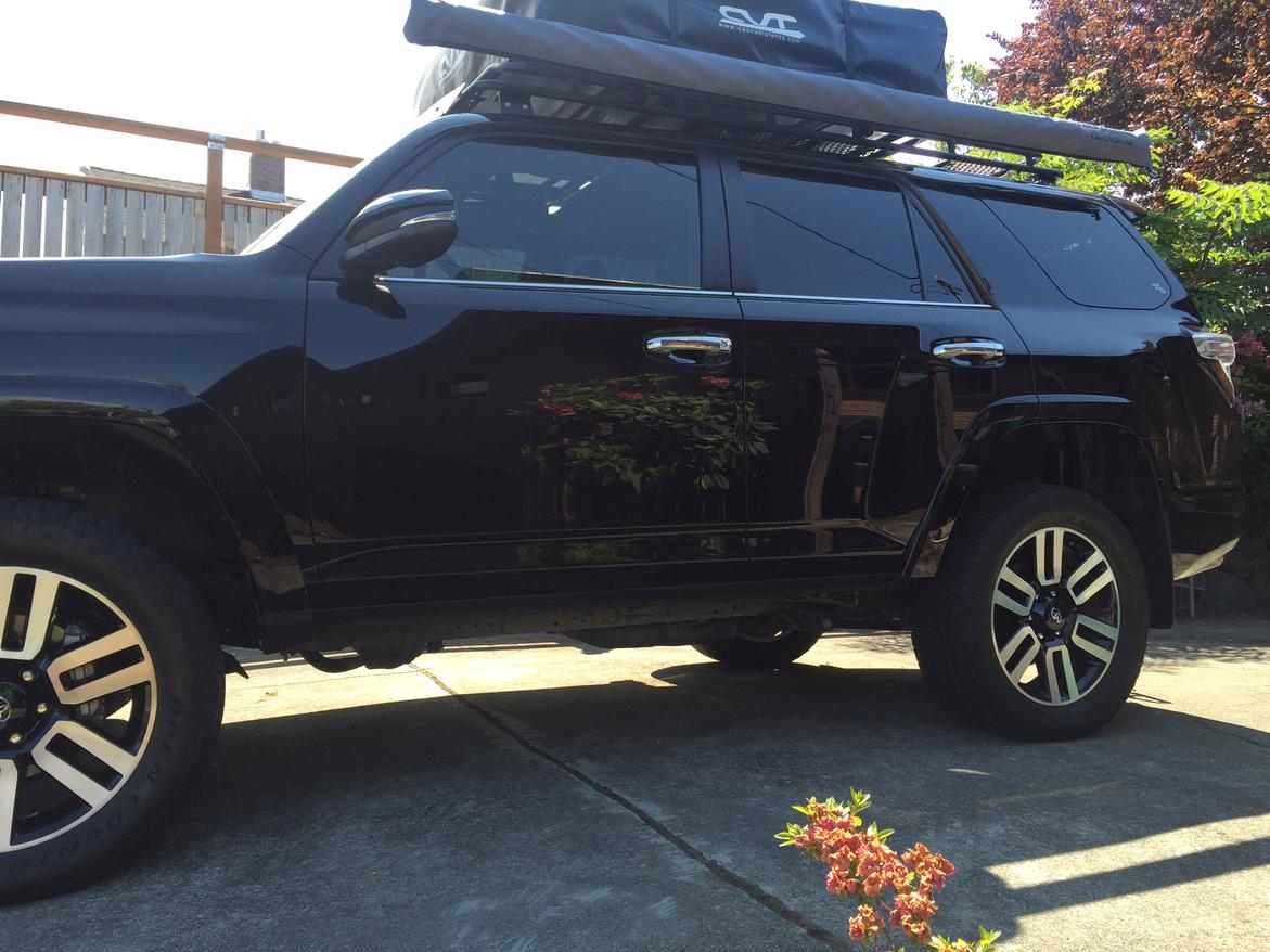

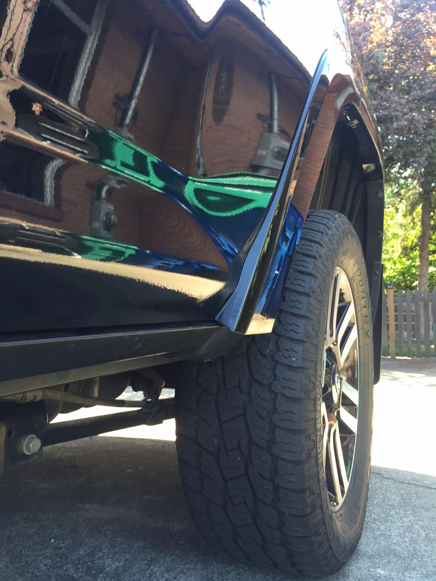

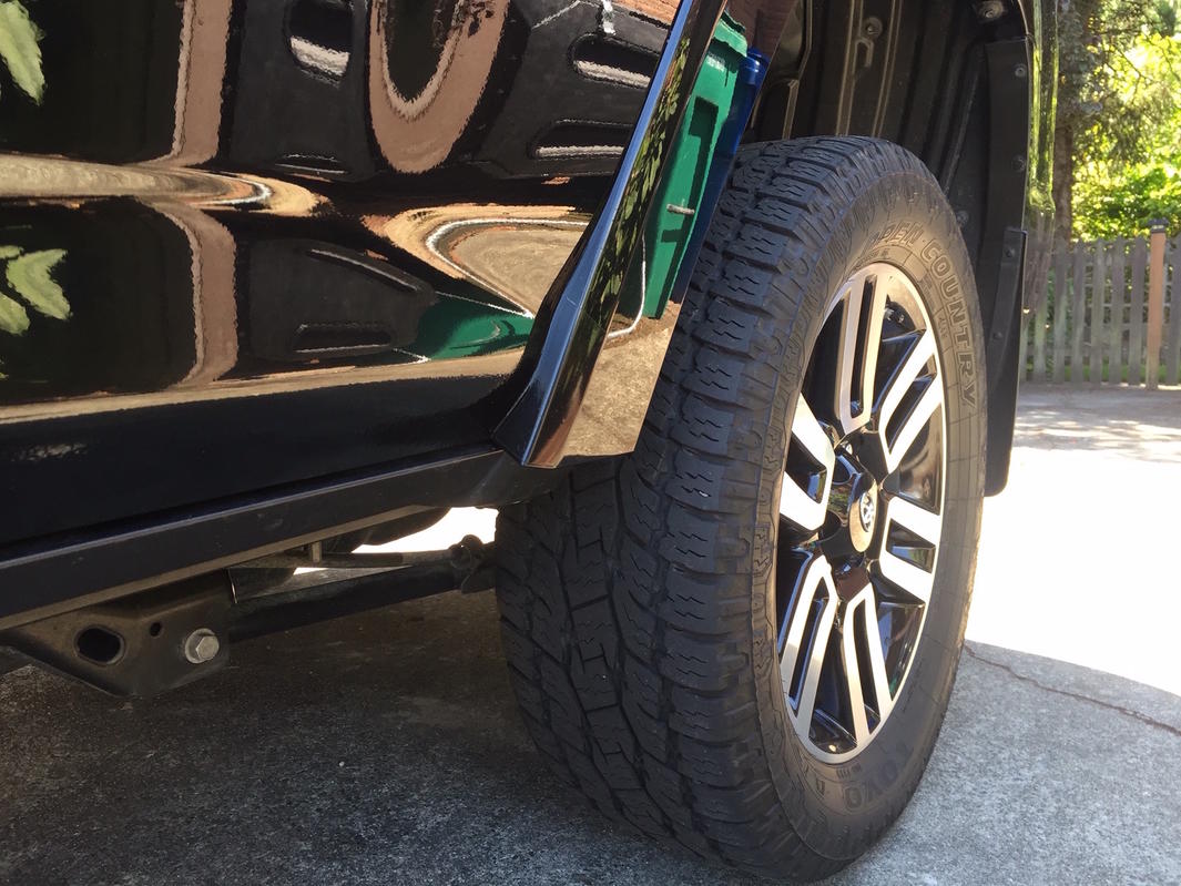

Just yesterday I replaced the rocker trim on my 2015 limited with the slimmer SR5/Trail version and I'm very happy with the results. Front mud flaps for the LE do not work. The door flares just clean up and complete the look. Though, as a lot have said, they're not necessary and you might just get used to the way they look. I'll go snap a pic so you can see the "after".
2015 LE - SR5/Trail rocker trim pics

Not to worry I felt the exact same way as you did when I made the conversion or should I say the transition to both a Limited and a Trail. I am still collecting pieces for the front end conversion and that has me more stressed out.
Here is a list of what I used. I currently had the mudguards and wanted them after I changed out the rocker so I ordered them as well. I went with the replacement oem parts instead of the shrockworks trim because I wanted to be able to use factory mudguards and I wanted a finished look even with the doors open.
2014 front trim covers
  • 75857-35010
  • 75858-35010
10-13 Rocker panels
  • 75806-35100
  • 75805-35130
The 2014 SR5/trail front Mudguards part numbers are:
  • 76621-35150
  • 76622-35150
To get the back flare of the rocker to line up with the door trim you will need to get the rear door trim pieces for the 2014 trail/sr5. I did not get them at this point to save money. They come smooth and would need to be painted to match.
  • 75741-35901
  • 75742-35901

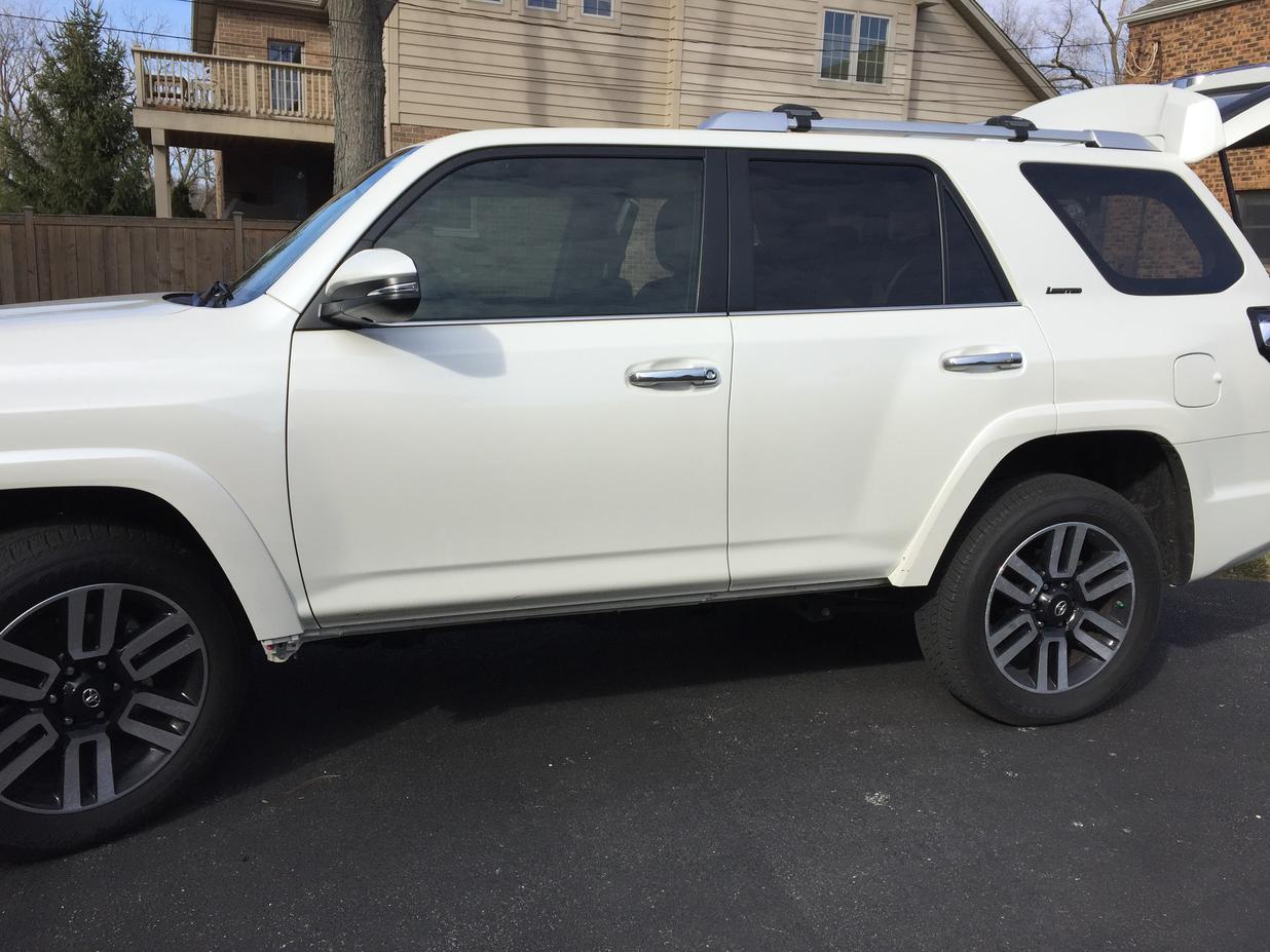

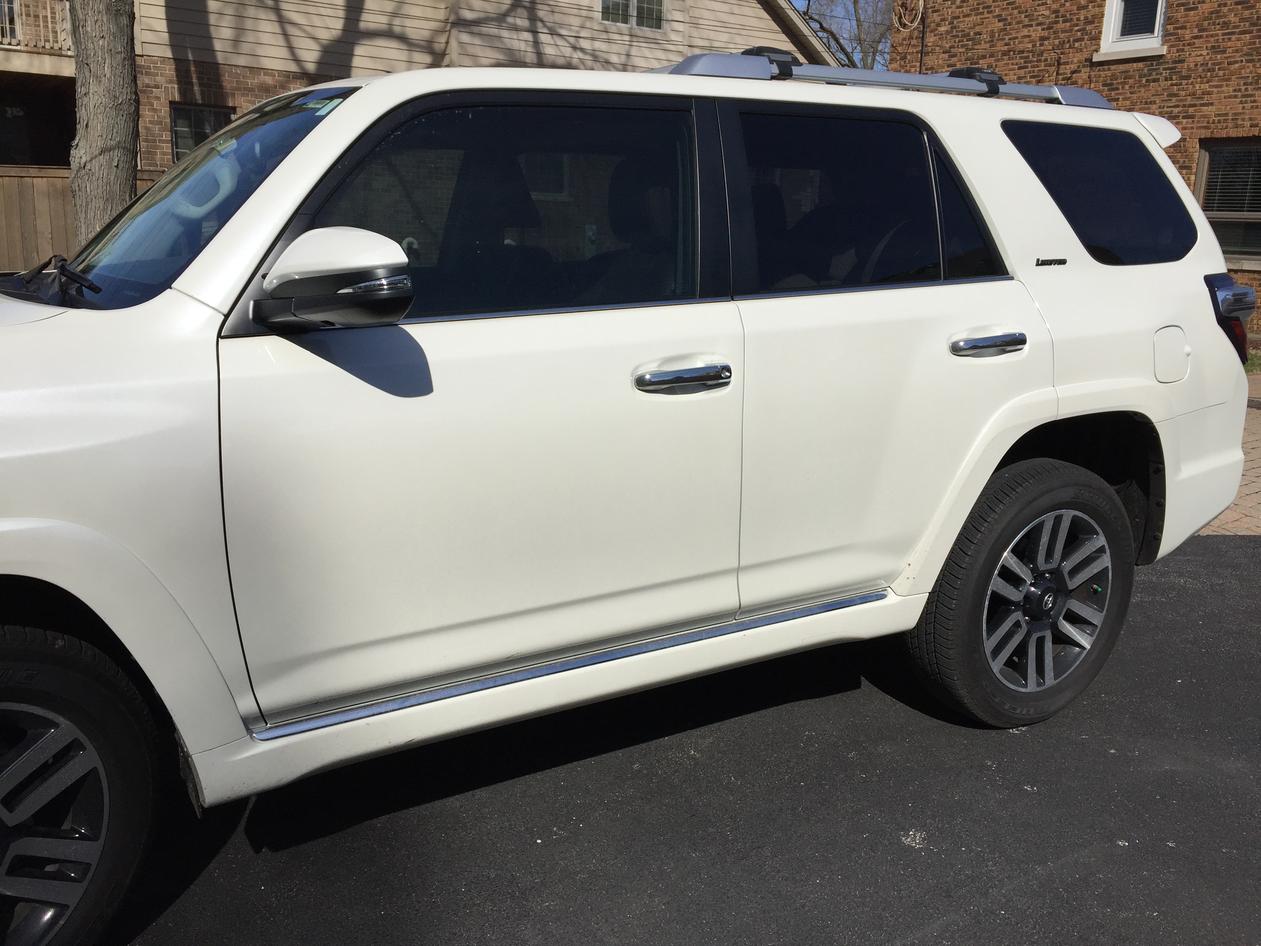

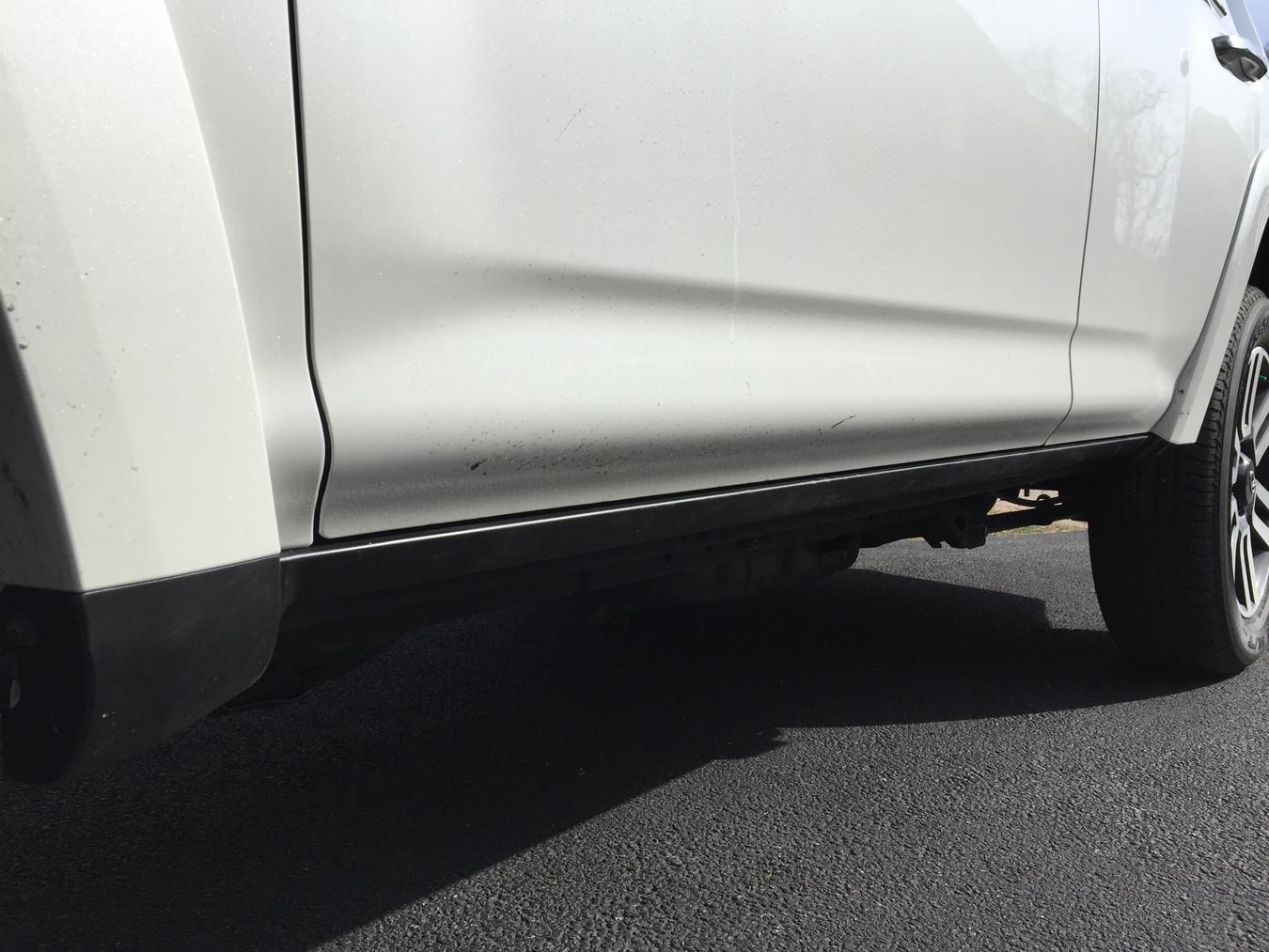

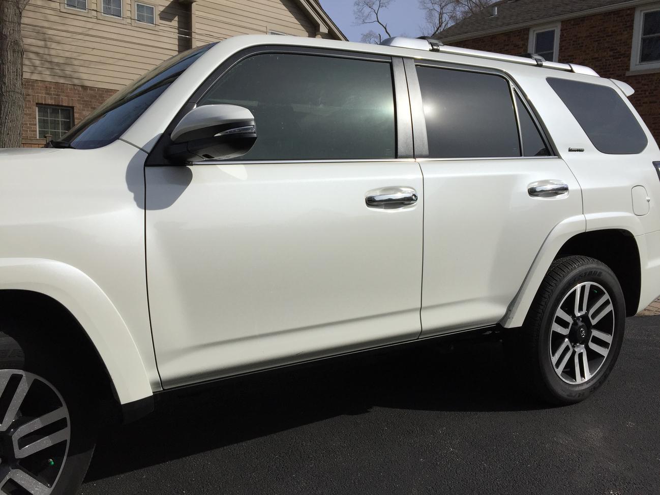

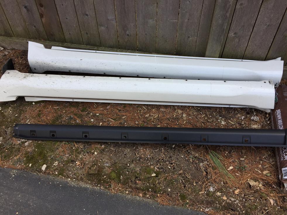

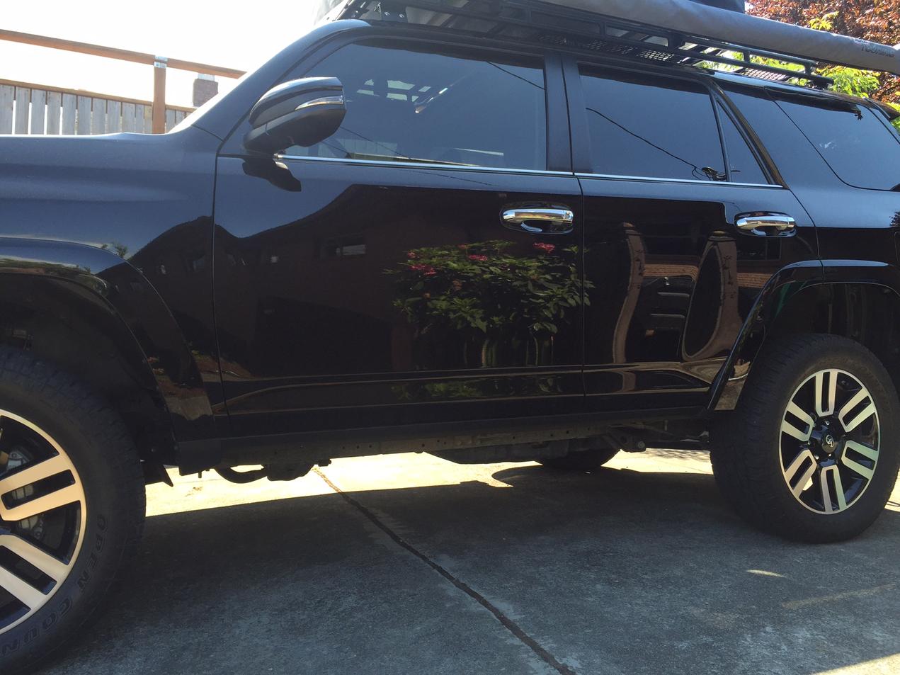

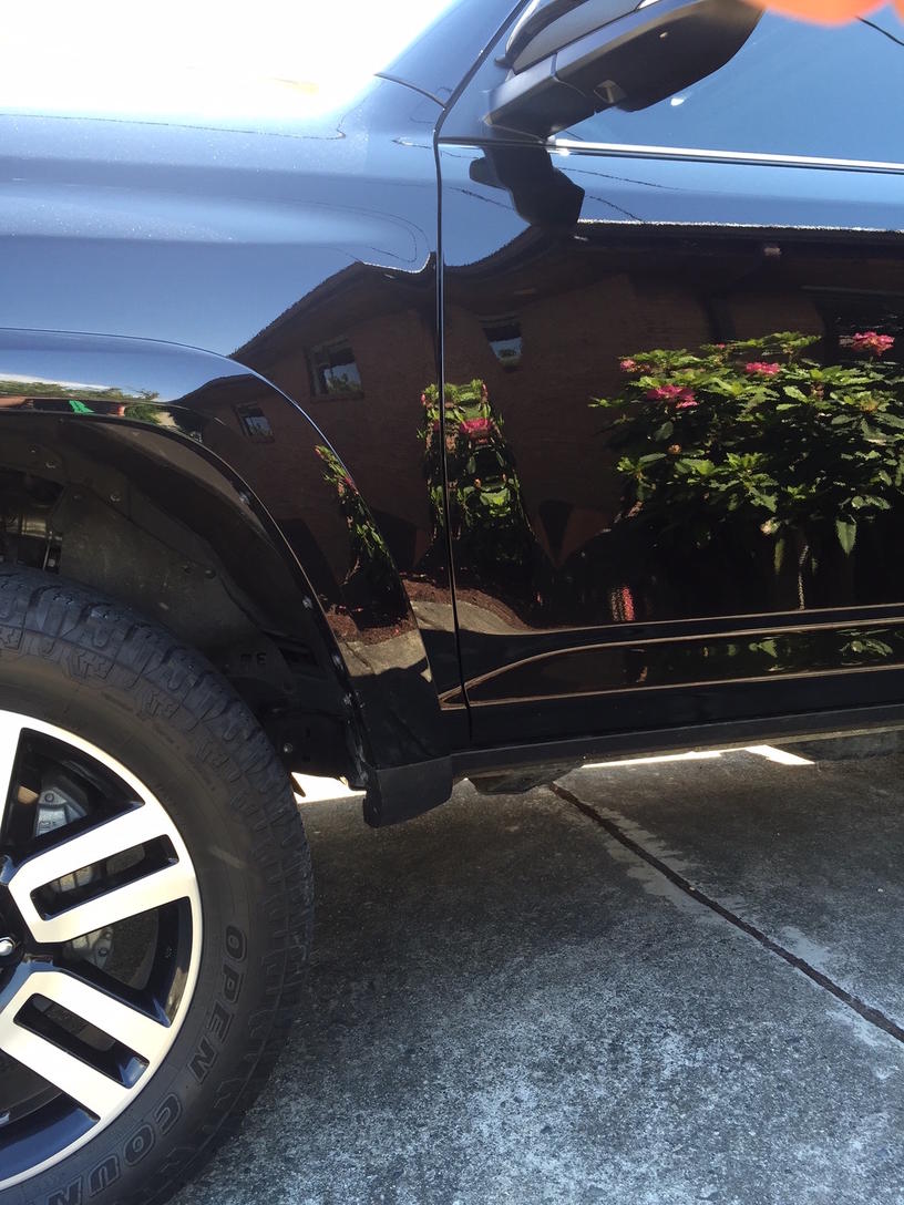

I threw on the TE rockers on my 2016 LE this weekend and couldn't be more thrilled. Just want to thank IronManKansas, bwright, AnthonyMV and everyone on here. Ordering the right parts and installing was just too easy, thanks to this forum!
Here are some pics:

I just finished putting the Trail rockers on my LE this afternoon. really like the look. The bit of overhang by the rear door does not bother me one bit. I purchased mine from McGeorge Toyota Parts for several hundred less than my local stealership wanted. Actually I really like my local dealer but they will not bargain or price match on parts.
Mine looks just like UncleBoobers except I have a ham radio antenna on the hatch.
