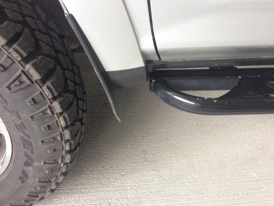

Best I have for now given bad weather in CO, if weather improves and I can get a close up I will. Have 2014+ front mud flaps and 2011 rear mud flaps, although not sure the rear flaps are on in this photo.

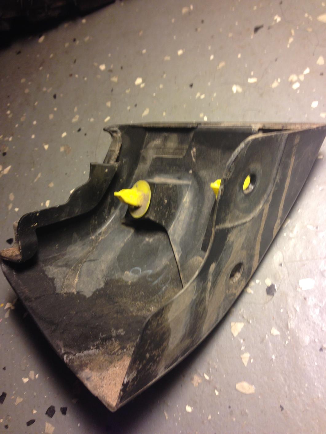

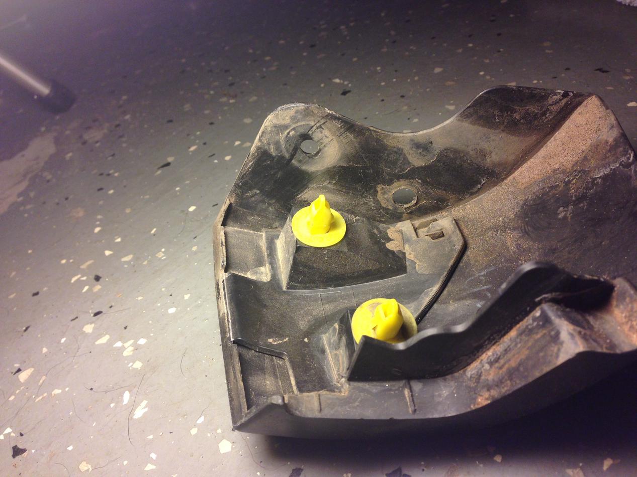

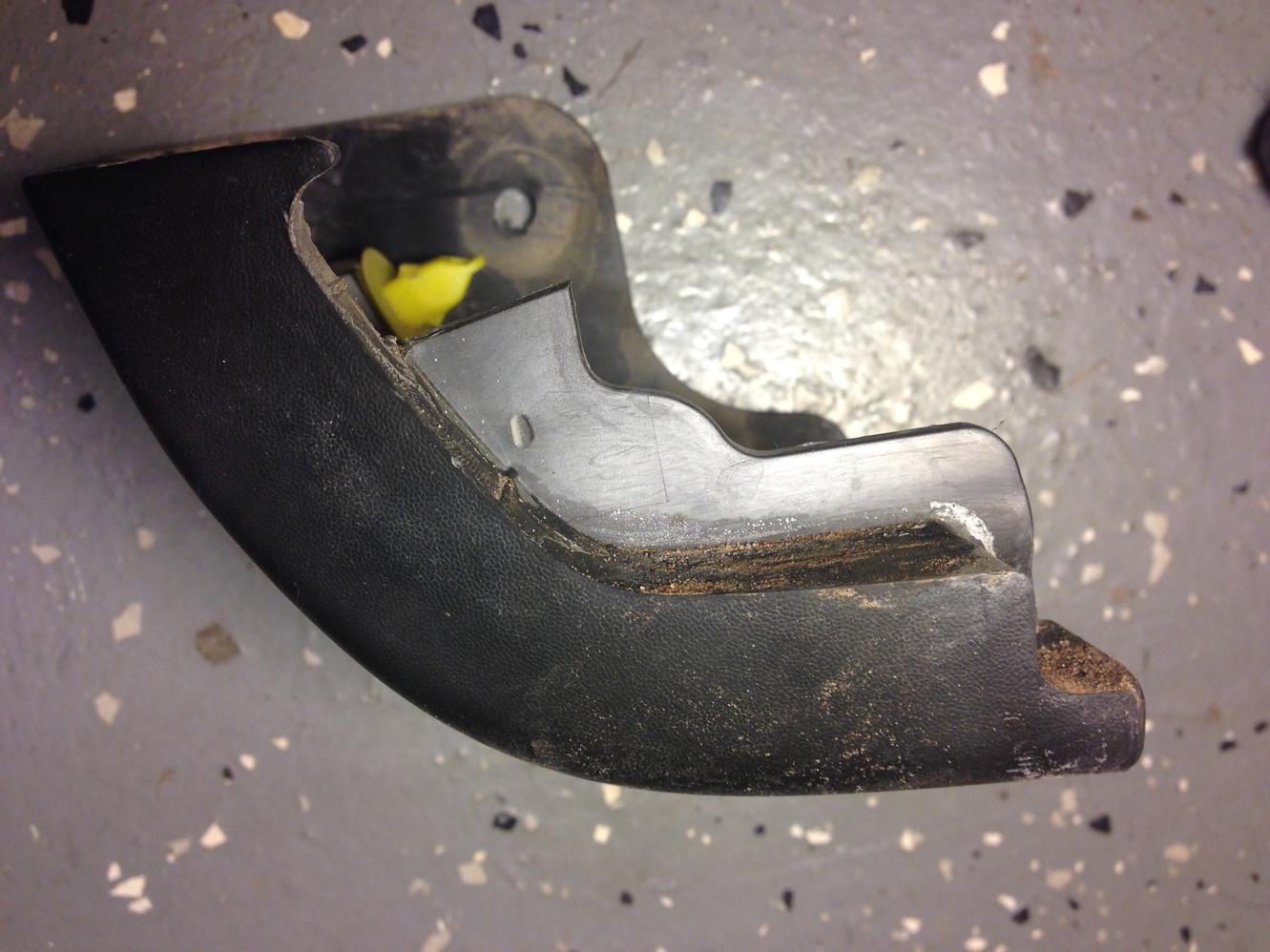

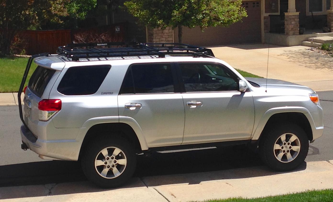

I've been getting a number of questions around this lately, as I was looking back the person that posted the original pics for trimming the front piece apparently was hosting their pics and now they are gone. I pulled my trim piece and while I don't remember exactly where I trimmed hopefully you folks can compare your uncut piece to my trimmed ones and it makes sense. Side note: I think only LE edition owners actually have to trim as [MENTION=112177]4RnR Grl[/MENTION] did not have to trim on her pre-14 SR5 so check before you cut!!! This is truly Antman quality but hopefully gives a good shot of where I trimmed. These are driver side... [MENTION=115334]Mistaken[/MENTION]

Sorry for photo whoring... just trying to help those that come along... this is installed with the 2014 trail mud flaps, they add an extra clip for more strength on the LE, per previous comments SR5 probably don't need.
