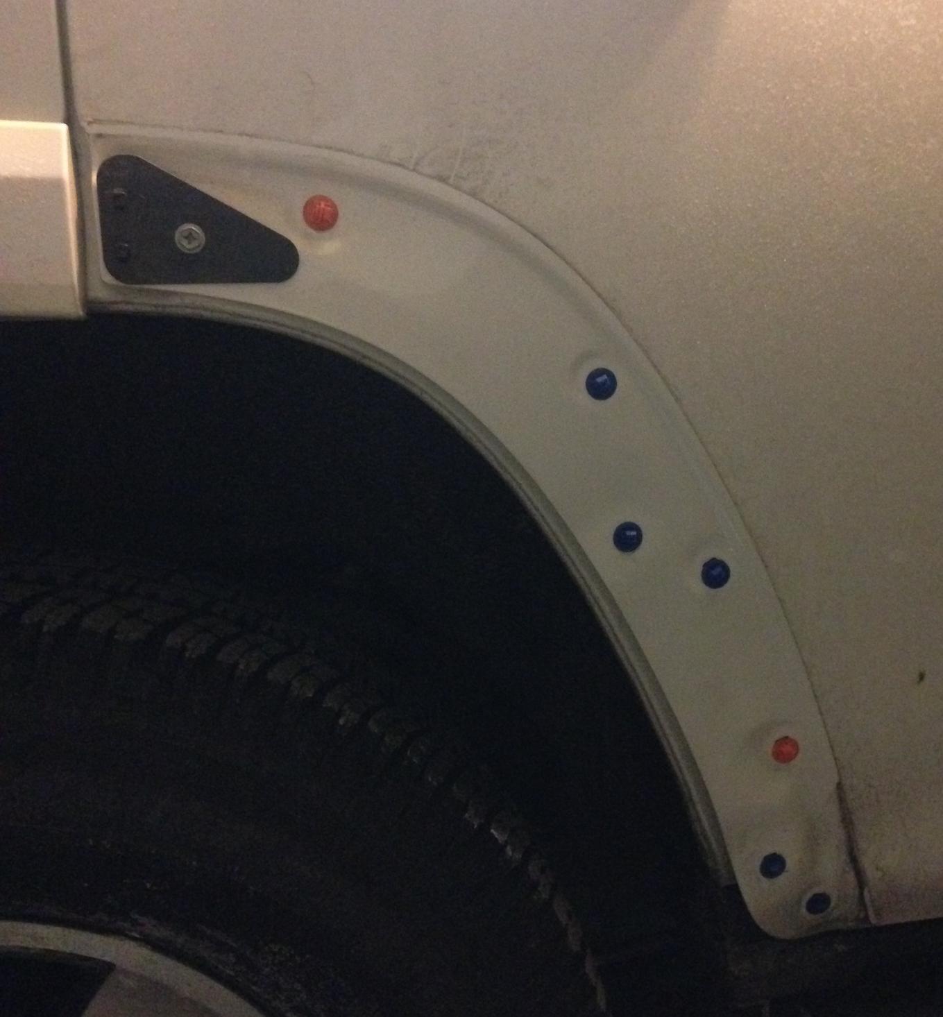

This is the best pic I could get this morning before heading out to work. I'm really happy w/ the outcome. I couldn't get my factory front mud flaps to work so I had to order the correct ones. I think it'll look better with them and also improve the secureness of the front caps. I have the rear door flares sitting in my office. I spoke to the body shop and he says that it would be better to paint the flares while there mounted on the doors as opposed to painting them off the car and then mounting them. Hopefully I can get my wife to part with my 4Runner for a couple of days do the body shop guys can do their thing.

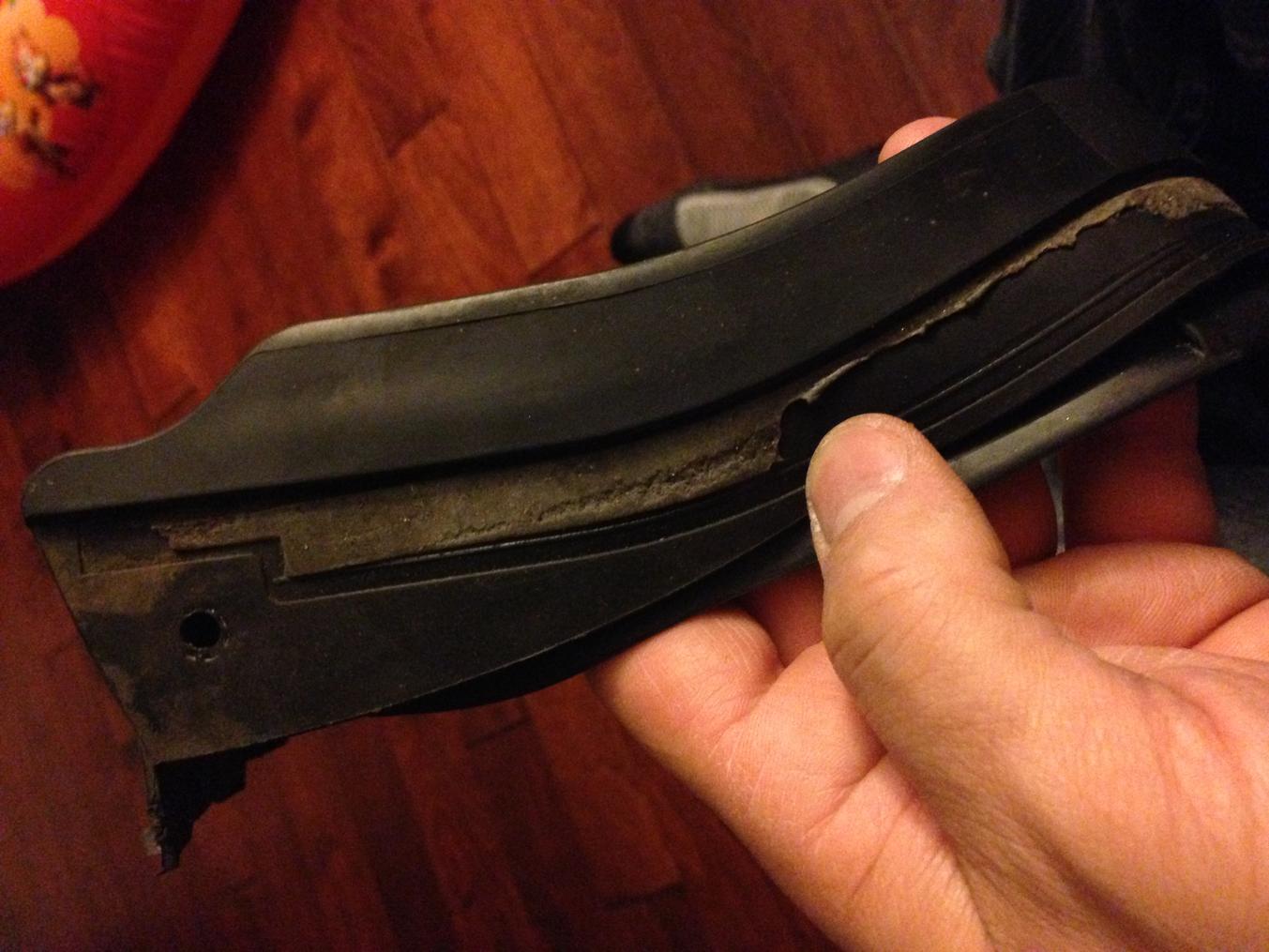

Did like snooperstyle said
Pulled up from bottom of flare
All but 1 blue clip broke. 1 orange clip was being difficult. But I managed to get it out

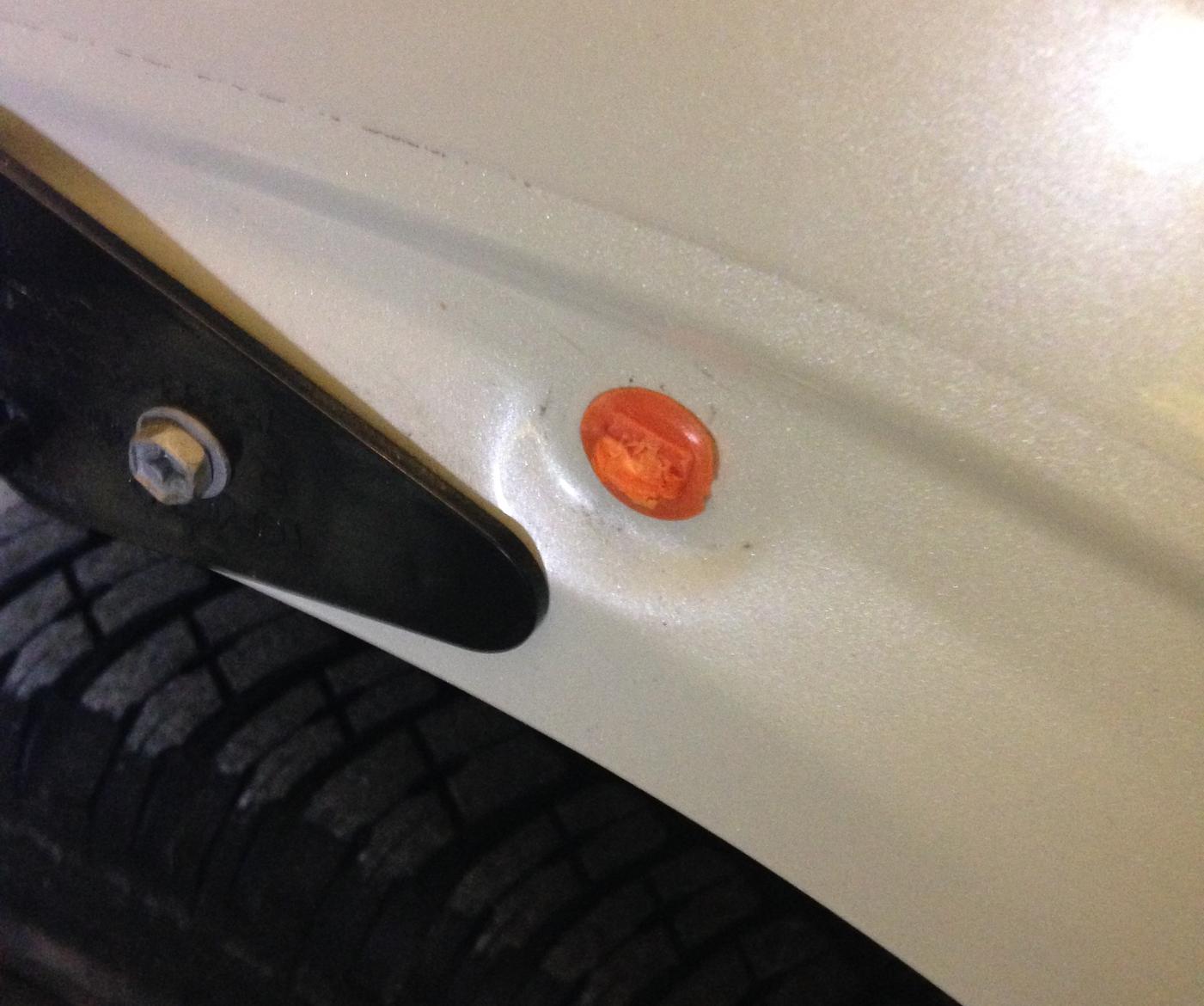

Cleaned around where flare met door.....
This orange one gave me a hard time
I used an "O" ring pick-type remover to push the side of the orange clip in to pull it out of the hole.......
Now gotta figure out how to trim and securely attach the rubber insert into the flare......next pic.....
Head scratching at flare rubber insert :

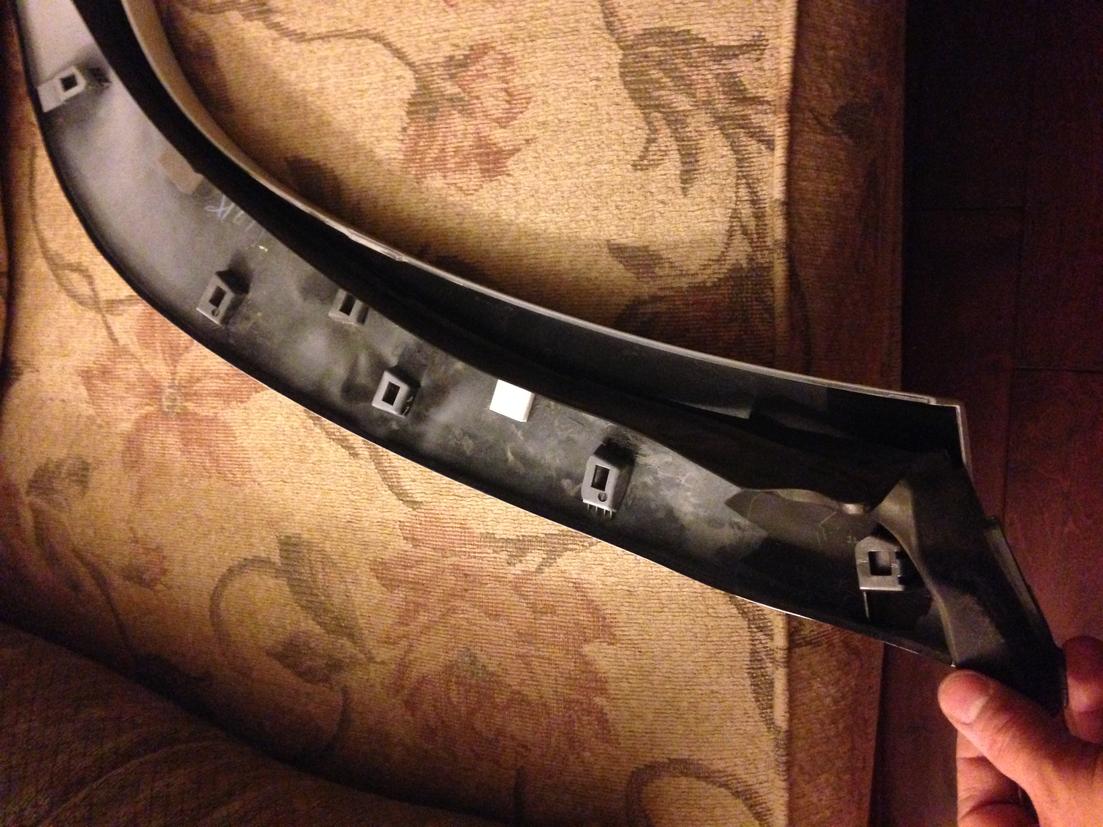

Ok.....rubber insert
Gonna use my thumb to rub off old double sided tape (extremely tedious)
Replace with new tape along same channel in insert. Then tommorow to Home Depot to get a pop rivet gun.....I think the original flare rivets are aluminum too put painted black.....looking plastic to me
