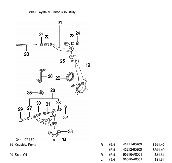

My seal was the same way and I did the same thing. My second bearing failed within a year. Replace both dust seals! PN 90316-A0001 (#20)

Thanks for the reply! I think I may have messed it up but don't tell the girlfriend (who owns truck)......I am seeing two seals when I look in the knuckle. One "inside" the knuckle next to speed sensor and the one on the backside that the CV axle pushes on. When I put everything back together the Outer CV/knuckle seal will not seat flush into the knuckle and is "out" a little compared to the good passenger side. I had read somewhere when you tighten up the 35mm nut it will pull the seal into the knuckle but it didn't in my case. Still out a little and not sealed against knuckle.
When you say both dust seals, I only see #20 in pic with part number PN90316-A0001 . Is this Outer and Inner knuckle seal one and mine may be torn in half?

May have just found the answer on this site!
http://www.toyota-4runner.org/4th-g...vs-now-have-steering-knuckle-seal-issues.html
From member King in 2013:
"recently did the same thing and had the same problem as you. it took some research and visiting all the auto parts store in town and the dealer. It looks like you used the seal that is supposed to go in between the hub an wheel bearing. For some reason you cannot get the seal between the knuckle and cv joint from the auto parts store, they don't even have it in their computer. Toyota carries it but I had to sit down with the parts guy to find it in their computer. Also if you look at the original picture the seal is actually 2 pieces that pull apart, one side goes on the cv joint and the other installs into the knuckle and they turn inside each other that is why you are getting the rubbing noise. I hope you still have the old one because Toyota didn't have the part that installed on the cv joint just the one you press into the knuckle. Let me know if I didn't explain it well enough and I can clarify, this was a major headache for me because I tried for a while to make the seal you used work before I figured out that the original seal was 2 pieces."
And here are the parts:
Originally Posted by Silver4RunnerIS300
National makes this seal part number 710573
and the other part number for reference is 90316-72001 or TOS-120

Both dust seals- driver and passenger side I meant (sorry). There is only 1 seal per knuckle- on the back side. The other seals are inside the hub assembly pressed together. There is an O-Ring on the hub that seals the front of the knuckle.
You can use the old dust seal as a tool to press the new one in without damaging it, BTW.
